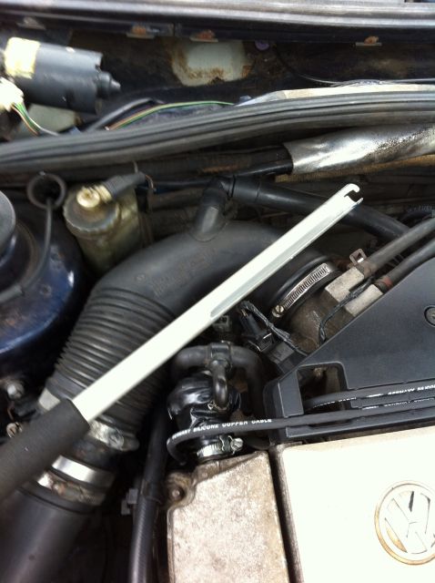

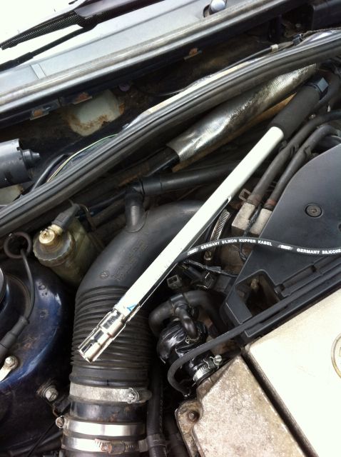

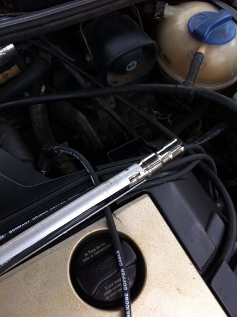

I needed to change my plugs today , looked all over the car for the ht lead tool but no joy . So I decided to make my own and it works great :D
Ignor my filthy engine bay and bodged parts by previous owner it's all WIP :lol:
Roger B tipped me off and I made a very similar one out of copper heating pipe a while back - worked better than the metal one I copied as I rounded the edges a little more :) Only drawback is the copper's a bit soft and it bends outwards after popping a couple of leads off, you have to bend the ears back in a little each time. Yours looks pretty solid!
PS: get that heater plug popped back onto the blue spacer on your PCV valve, before it gets caught in something! ;)
Positive Crankcase Ventilation ............. I read that somewhere :lol:
Cheers mate, schooling never ends
