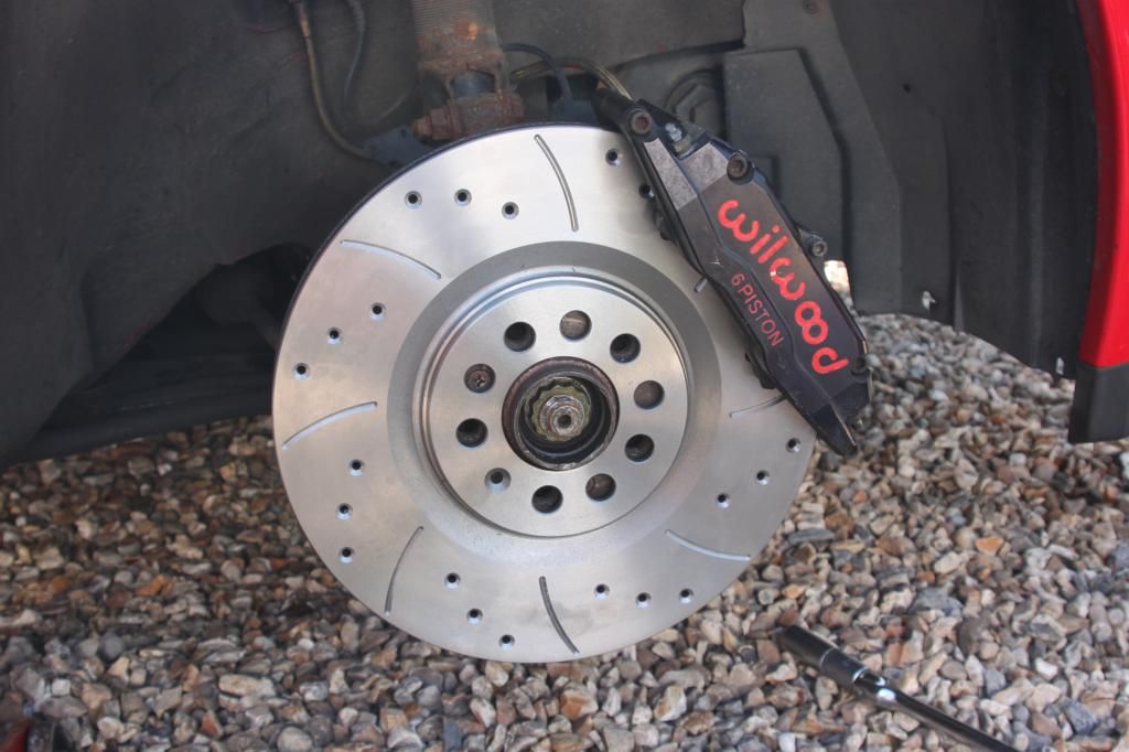

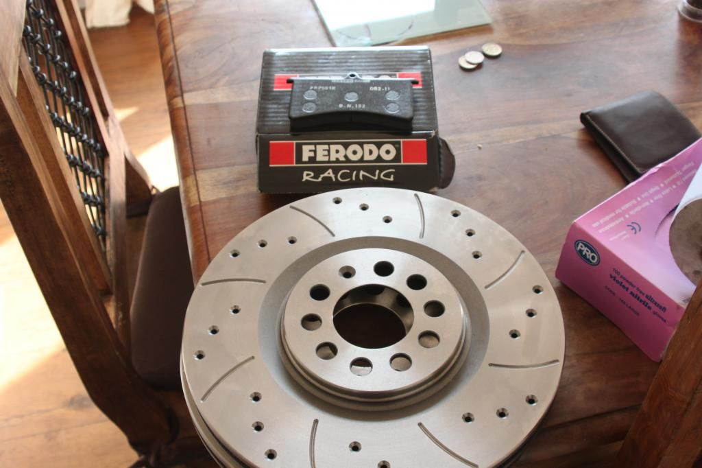

VR6 Gar 10 Posted June 15, 2013 What an awkward ******* of a job it was getting the wastegate bolts in, took me HOURS in the backing hot sun we had the week before last. Then when putting the V band clamp back on the turbo - exhaust I was not getting a good seal. After a few attempts I stripped the threads FFFFUUUUUUUUUUU:censored: Got a new one with a larger bolt and got it all back together on Thursday. New rear Ferodo Premiers have been fitted. Took a gamble on some new Ferodo DS2.11 racing front pads as they were cheap but they were too thick. Turns out the Wilwood superlite have 2 different thicknesses of calliper and I have the thinner one. This isn't a problem though as I know someone local who has offered to turn the down for me as they were clearance stock so I wan't to keep them. Once I have them at the correct size I will be replacing the front discs Also. New Kenwood HU has been fitted and looks like this. Quote Share this post Link to post Share on other sites

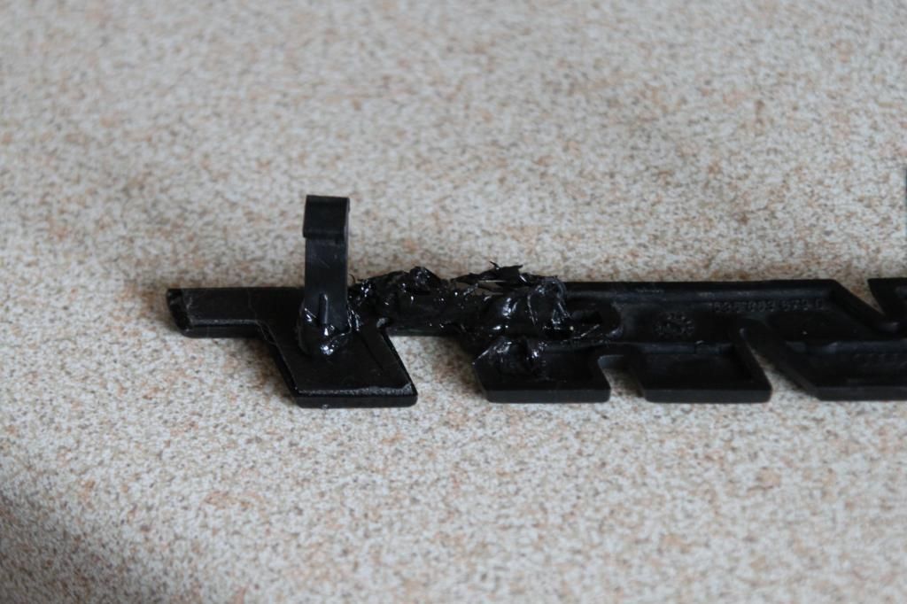

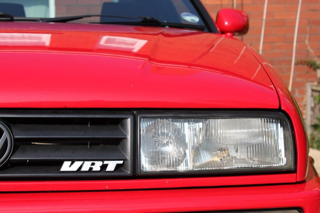

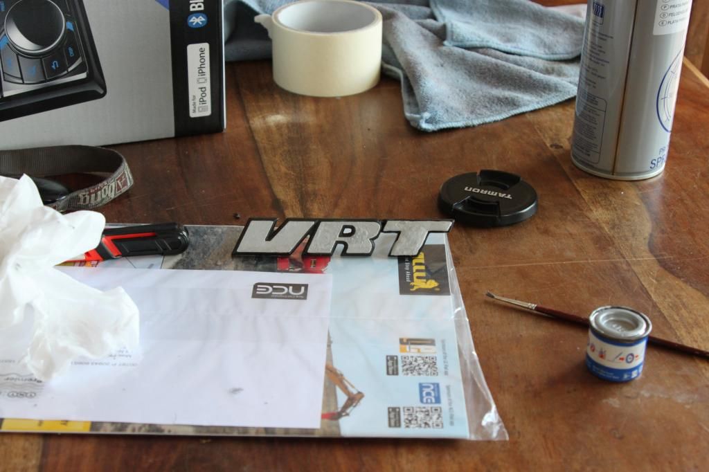

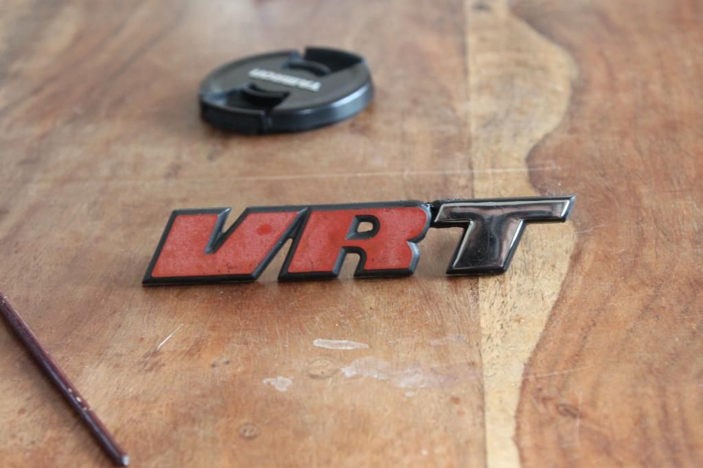

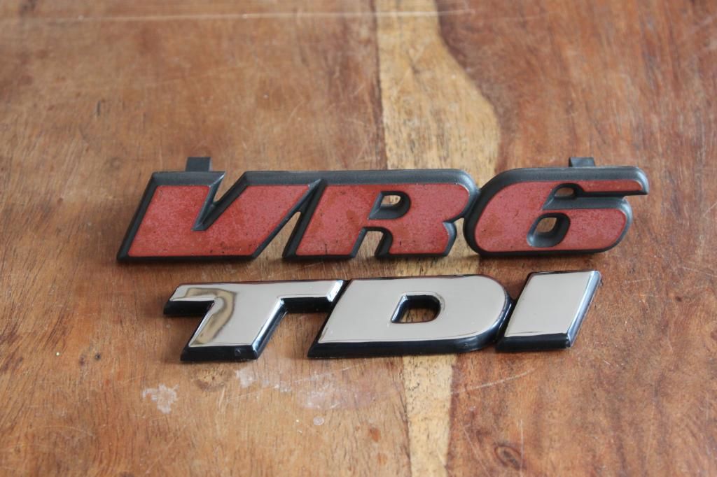

VR6 Gar 10 Posted June 26, 2013 Decided I wanted a grill badge, but thought I would try something a bit different. £30 on a second hand VR6 badge and £7 on a new TDI badge, some tiger seal and some silver paint and here is the result. Happy enough with it, however getting the paint smooth was not easy so is a bit rough up close. May flatten it at some point with Wet and Dry. Quote Share this post Link to post Share on other sites
Dox 28 Posted June 26, 2013 B10 VRT is available on DVLAs site for £400, L666 VRT is £250 Quote Share this post Link to post Share on other sites
VR6 Gar 10 Posted June 26, 2013 Yeah I looked into VRT plates but until all the other mods like Traction Control are done I can't afford it. Not ruling it out at some point in the future though. Quote Share this post Link to post Share on other sites
coullstar 0 Posted June 26, 2013 Nah, reason I sold mine as it was just too obvious. I like the grill badge but not the plate, keep it subtle. Quote Share this post Link to post Share on other sites

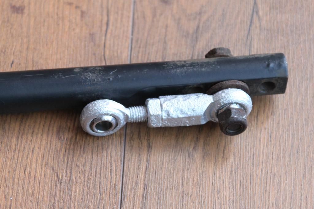

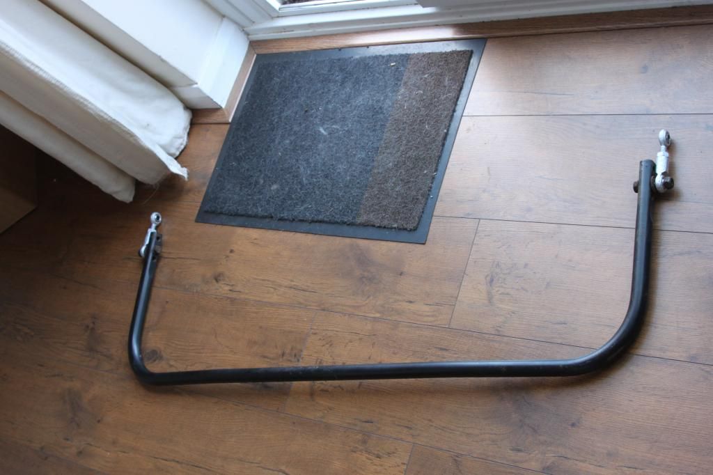

VR6 Gar 10 Posted July 1, 2013 This turned up today, purchased from 'The_Dude'. 25mm 3 way adjustable Neuspeed rear ARB. Gave the drop links a good wire brush as they were pretty rusty. Quick coat of Acid etch and silver paint and they look much better. Just ordered some new longer lower shock bolts then its ready to go on. Quote Share this post Link to post Share on other sites

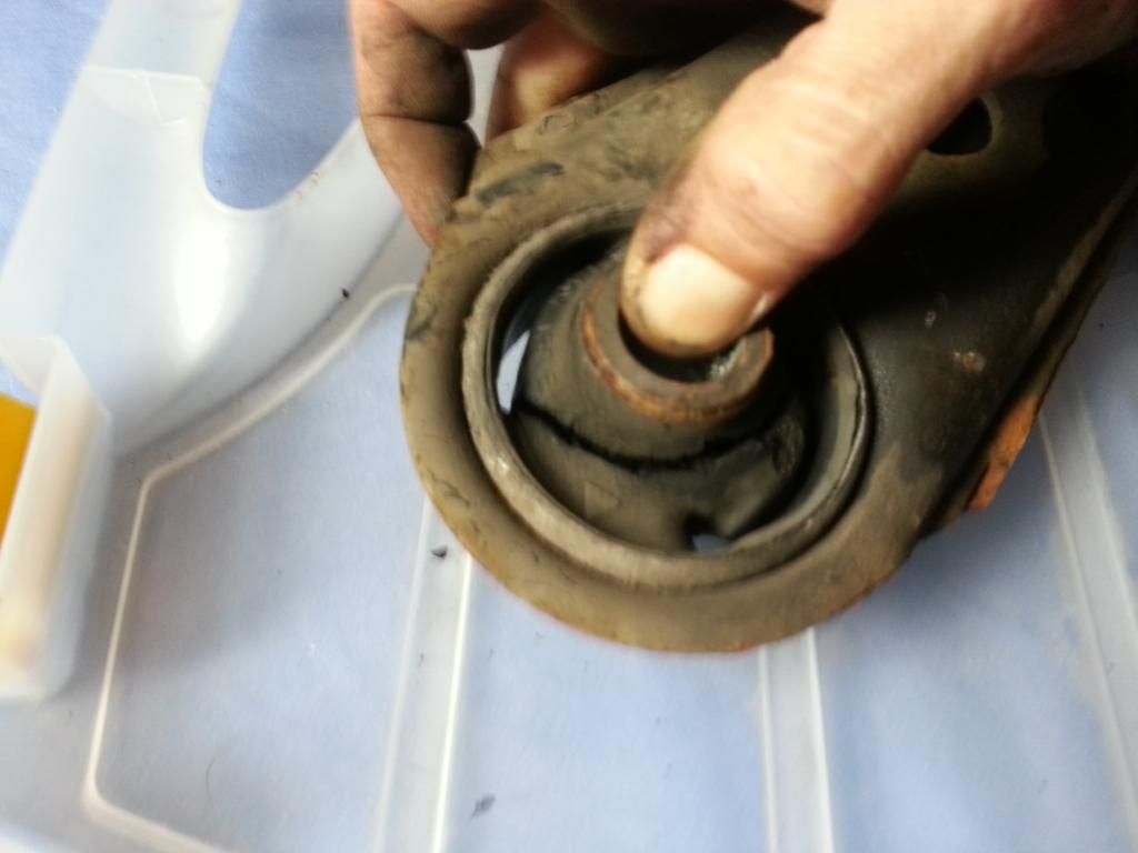

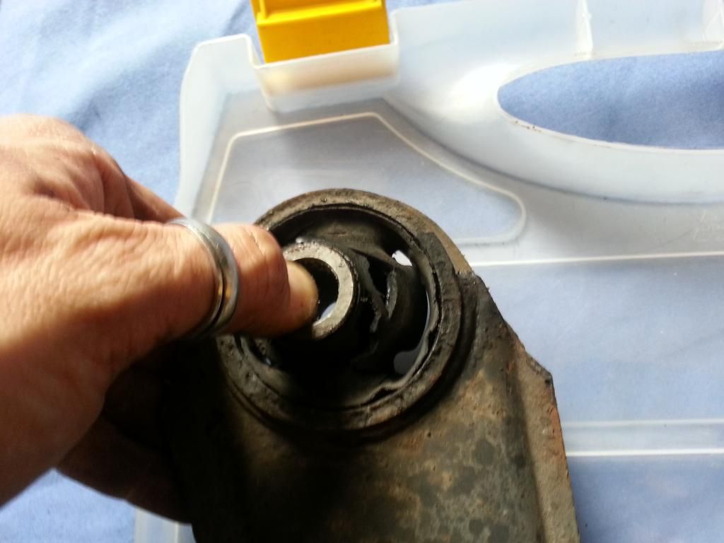

VR6 Gar 10 Posted July 3, 2013 (edited) Considering the previous owner was a VW mechanic with access to cheap parts and a workshop not much in the way of basic maintenance was carried out on this car by the look of it. Changed the NS rear wishbone bush today for a Lemforder R32 one and this is what I found. Front one looked really awkward and was still in good condition with no play so I left it in. Loosened the driver side bolts then realised the front one would catch on the sump so have left it there for today. Will try and get it done tomorrow now I know how to get around this by raising the engine. Thankfully all 4 wishbone bolts came loose with a 6ft scaffold pole being used as a breaker bar and didn't snap. Edited July 3, 2013 by VR6 Gar Quote Share this post Link to post Share on other sites

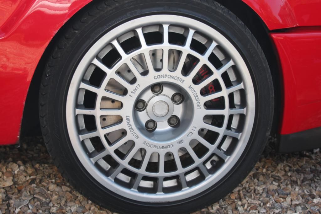

VR6 Gar 10 Posted August 27, 2013 Went out to bed my new front brakes in yesterday and they are very good pads, just got better and better the hotter they got. Not sure what they will be like from cold though, will find out when I next take the car out. Only thing is they are not the most progressive, as the car slowed the harder they broke. Good in an emergency stop situation I guess. 312mm Mtec disks and Ferodo DS2.11 pads. Quote Share this post Link to post Share on other sites

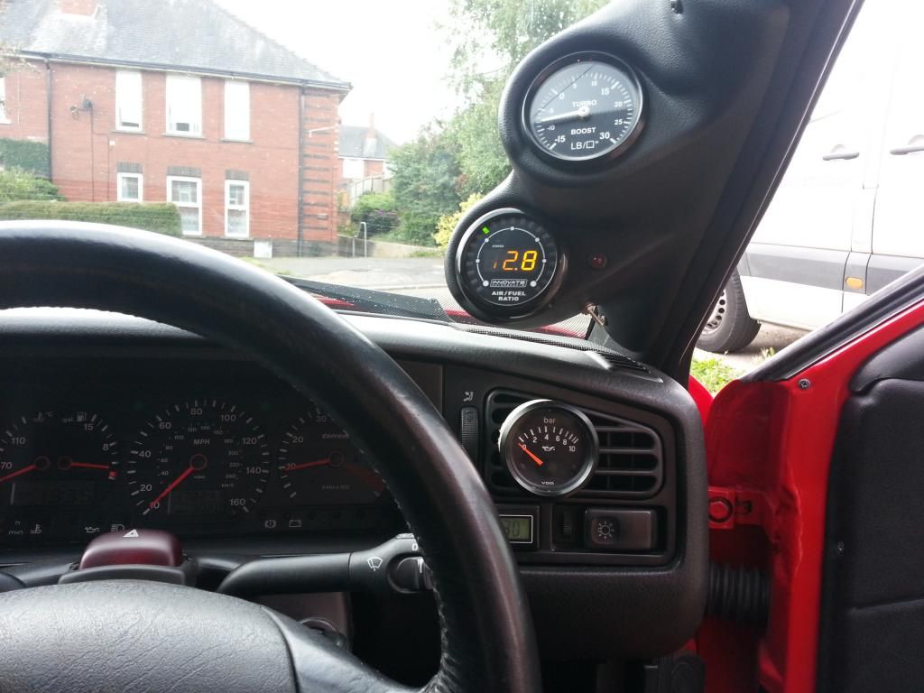

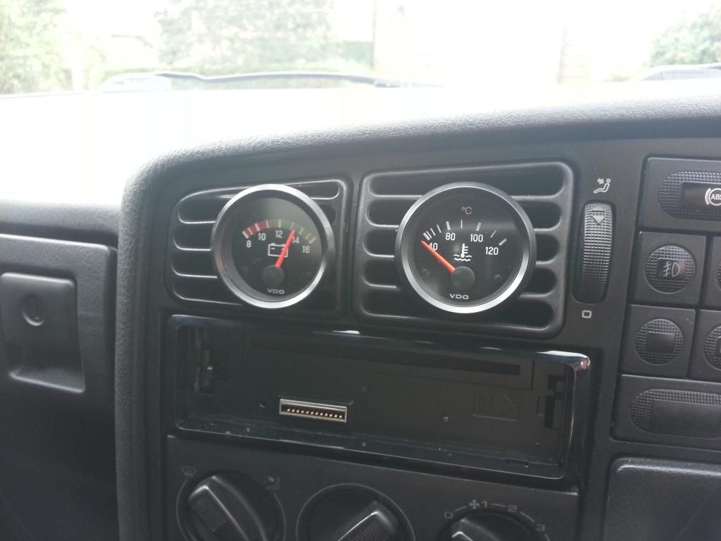

VR6 Gar 10 Posted August 27, 2013 Volt gauge turned up today so fitted that. Not got round to fitting the senders on the other 2 yet but will be getting them wired in soon. The wideband gauge never worked since buying the car so ordered a new Innovate MTX-L and fitted it last week. Quote Share this post Link to post Share on other sites
coullstar 0 Posted August 27, 2013 Gauge tastic!! Is the wideband working okay now? I had to shave the pads I put in, they were Mintex IIRC and were good on track. I liked the brakes. Quote Share this post Link to post Share on other sites
VR6 Gar 10 Posted August 27, 2013 Never managed to get the wideband working, think the control box may have been kaput, so I just went and ordered a whole new kit, the newer MTX-L version. Could have ended up being costly trying to figure out what was wrong with the old one. Yeah, 1144 were in there but they had worn really unevenly, were getting low and the disks were almost smooth, so dead too. Think the brackets on the brakes are a bit thin and flex hence the uneven pad wear. I also had to get the pads turned down. A guy off my local forum offered to do it for me. Luckily his boss was away as he ended up going through £100 worth of tooling :suprised: Quote Share this post Link to post Share on other sites
