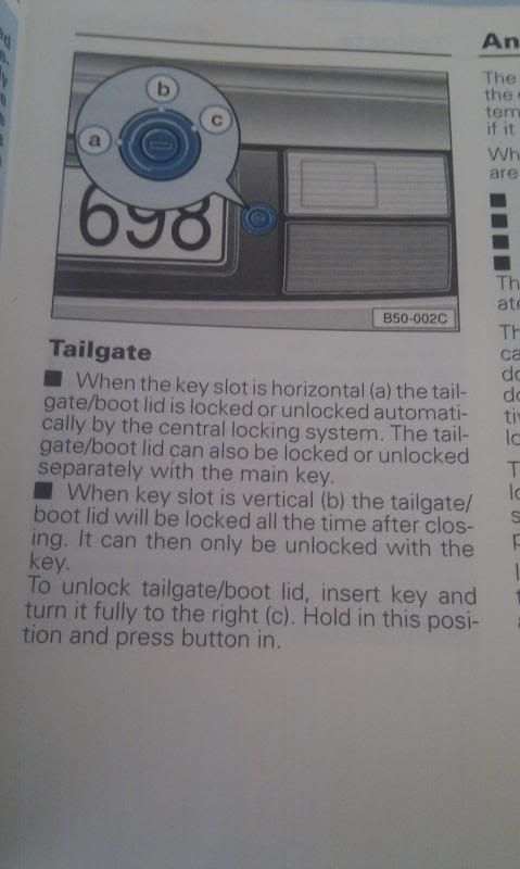

There's three positions for the lock:
Slot vertical | = locked all the time - will not unlock with the central locking.
Slot Horizontal - locks and unlocks with the central locking. Pusing the button opens the hatch if the car is unlocked.
Slot rotated 45 degrees Clockwise from Vertical / AND then push key in manually unlocks the hatch regardless of if the car is locked or unlocked. If your alarm is set, it will go off ;)
At least on mine it does :)
Found the page in the handbook:
Edited by timmaaah
Handbook pic
Ahh, ok, that make sense - maybe it's just a bit "fiddly" to get into position C, I'l have to check it out.
