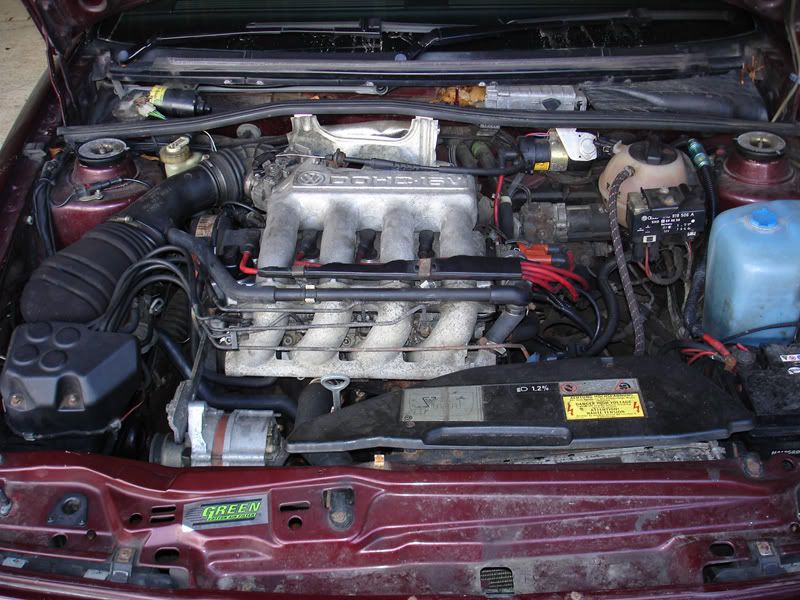

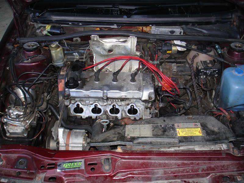

mrbeige 0 Posted January 21, 2007 Started stripping down the inlet today, and snapped the end of my 6mm Allen key off in one of the hex bolts that holds the lower section of the manifold onto the head! :x still managed to get it off by smaking a 12mm socket over the top of the little bugger :twisted: Before After Next job is to remove the metering head and stuff, but ran out of light, so that's a job for next weekend! Quote Share this post Link to post Share on other sites
