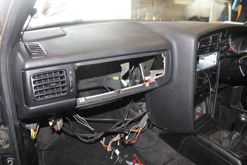

I need to remove my glovebox, I've remove the 4 screws holding it in but can't remove it, it's loose but just won't come out of the hole..

Cheers for the tips fella's, managed to get it with a fair amount of brute strength and ignorance...lol

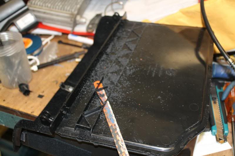

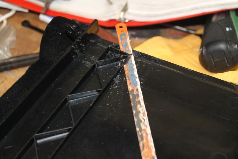

While it was out I decided to remove the ridge.
Just used a hacksaw blade, easy peasy.

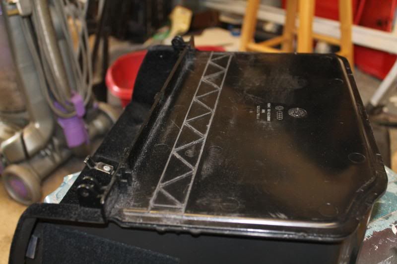

A little rub over with the sander and it's done.
It's a lot easier to get out now which should come in handy when I finally lose my rag with the alarm and rip it out... we have already had words....
