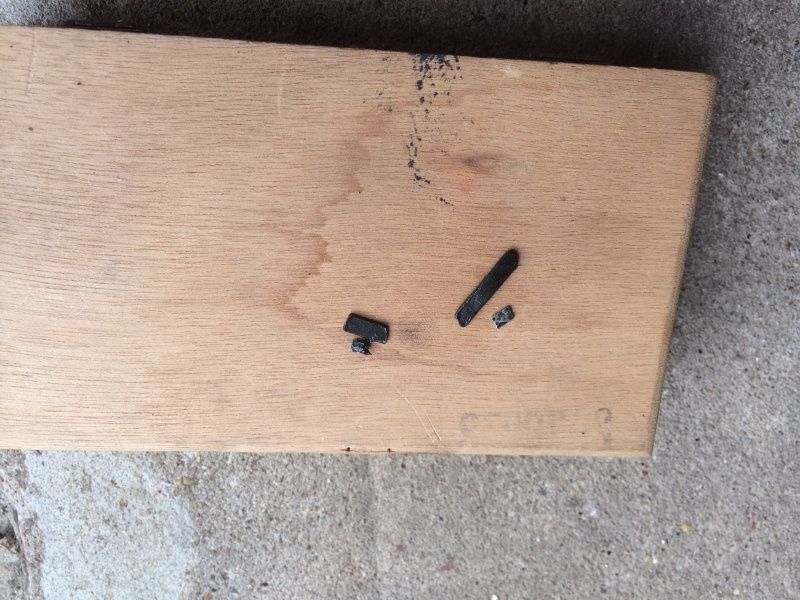

rabbit82 0 Posted September 17, 2014 Took the intercooler hoses of loads of oil in the super charger but like grey in colour also up near the inlet to the throttle body I found these little bits is this part of one of the seals from the super charger Quote Share this post Link to post Share on other sites
