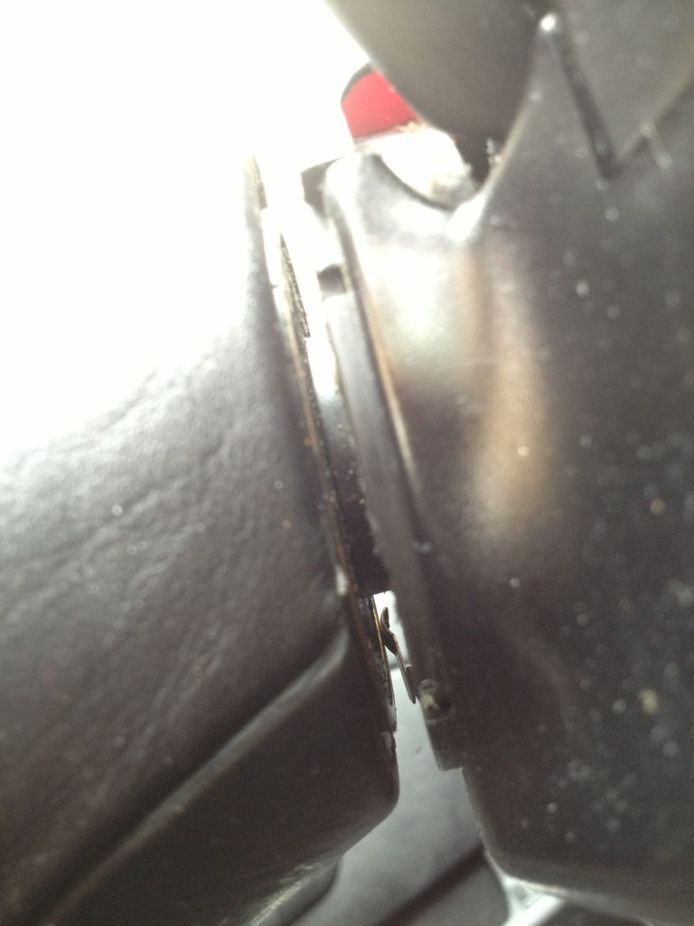

Just spray the electrical contact cleaner you've got behind the steering wheel, before you go and start removing.
If you do take the steering wheel off just use any normal grease you have. You will only need a little amount, you could even use some Vaseline or a similar product you might have as lubricant.

I get that too, sometimes running a credit card around the small gap between wheel and column gets rid of it. I think its the horn contacts that make the noise.
Use credit card to remove that gold metal clip thing at bottom of steering wheel/column?
That making noise?
That making noise?
Removing that gold bit will stop your horn working. Just add a bit of grease to it.....I got chills, there multiplying

Not remove it Wayne, just use a credit card to push any dirt thats trapped out of it. The clip makes contact with a brass ring on the back of the steering wheel. Its why your horn works no matter what position the wheel is at. :cool:
Still not sure by use credit card?
In my pic i cant see any contact from steering wheel to column (except that gold clip)
Er ...do have a 2nd opinion about my horn (cough)(cough) working (cough) :eek:
So it must be inside that steering column - the scraping???
it will be grit or dirt between the gold clip you can see making contact with the gold ring
take the steering wheel off & clean both & then put a little grease on both of said contacts & refit
i very much doubt it is your column m8
