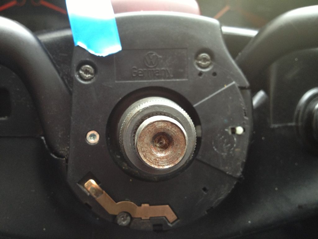

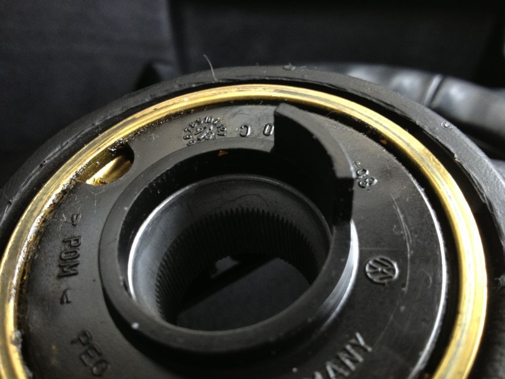

Wayne2015 10 Posted March 27, 2015 it will be grit or dirt between the gold clip you can see making contact with the gold ring take the steering wheel off & clean both & then put a little grease on both of said contacts & refit i very much doubt it is your column m8 Ok! So grease on gold clip ok? Its not some sort of electrical contact is it (if greased then no contact!:eek:) Quote Share this post Link to post Share on other sites

seanl82 23 Posted March 27, 2015 Ok! So grease on gold clip ok? Its not some sort of electrical contact is it (if greased then no contact!:eek:) Correct, and yes its an electrical clip. Grease will conduct perfectly well so long as you don't go massively overboard mate. A very light smear is all thats required. Quote Share this post Link to post Share on other sites
Wayne2015 10 Posted March 27, 2015 Correct, and yes its an electrical clip. Grease will conduct perfectly well so long as you don't go massively overboard mate. A very light smear is all thats required. Cool! Just a quick wipe for today :) Quote Share this post Link to post Share on other sites

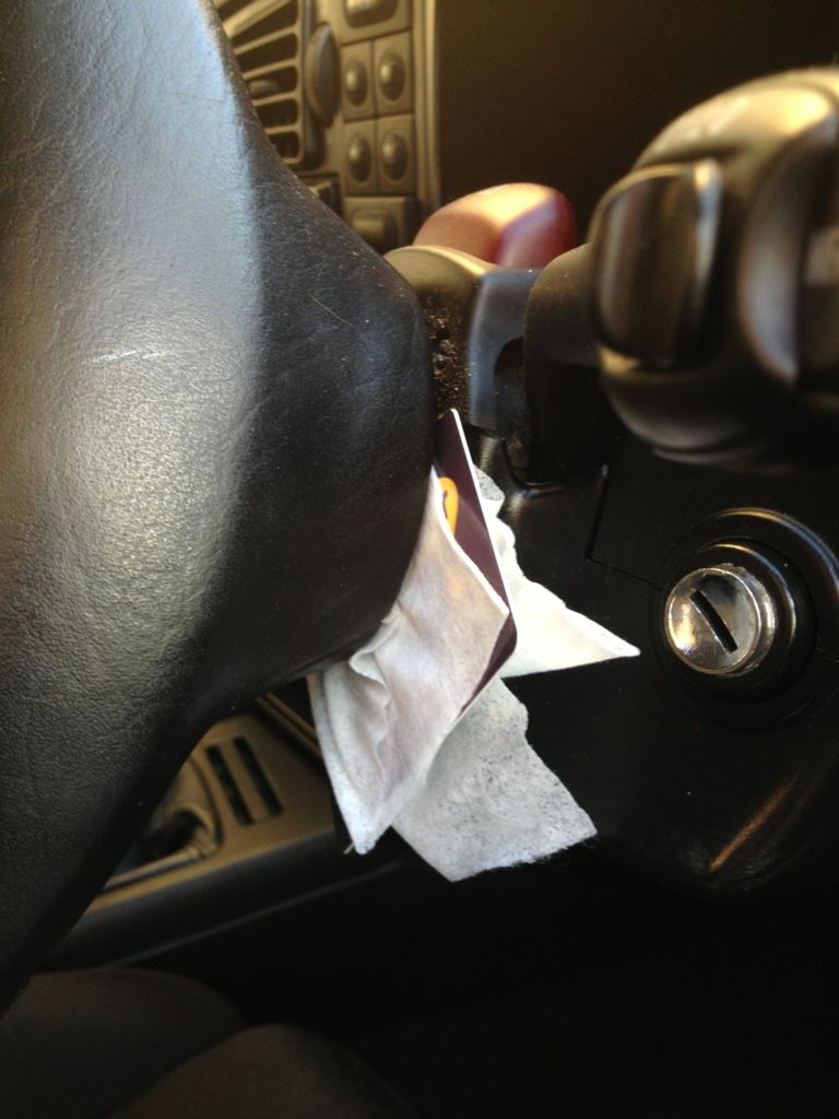

Hairyarse 10 Posted March 27, 2015 Did it add any points to your Nectar card? Quote Share this post Link to post Share on other sites
Wayne2015 10 Posted March 27, 2015 Did it add any points to your Nectar card? Nah, Andy It even deducted points coz it said I used it to pay for that wet wipe :eek: :lol: Quote Share this post Link to post Share on other sites

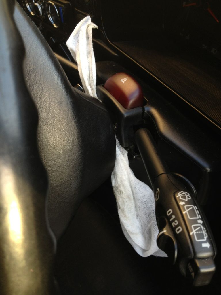

Wayne2015 10 Posted March 27, 2015 Ok Wasted nectar points Less scraping on steering wheel But, still there :( Quote Share this post Link to post Share on other sites

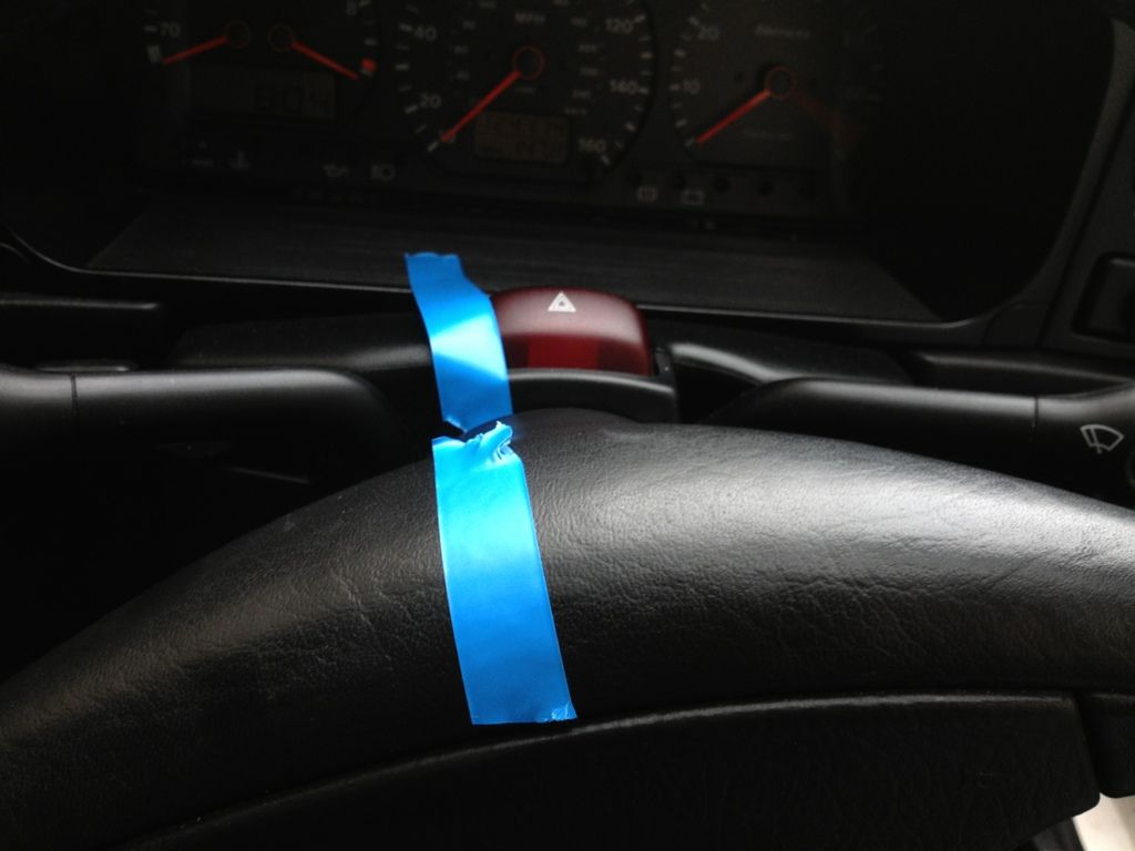

Wayne2015 10 Posted March 27, 2015 Wait for the car to be cool, you'll have no worry of the fans activating then. Turn the fans and if there is any notchy or heavy resistance, get them changed. If you don't want to touch them, use a bit of wood! Forgot about this - will check 2moro! Quote Share this post Link to post Share on other sites

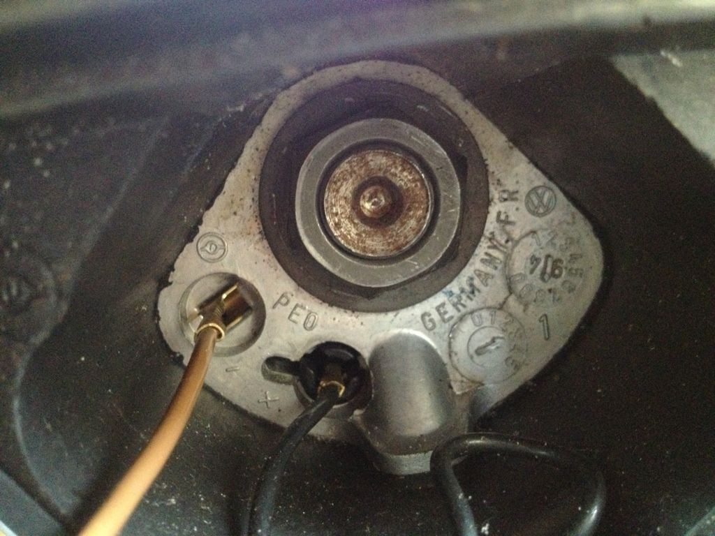

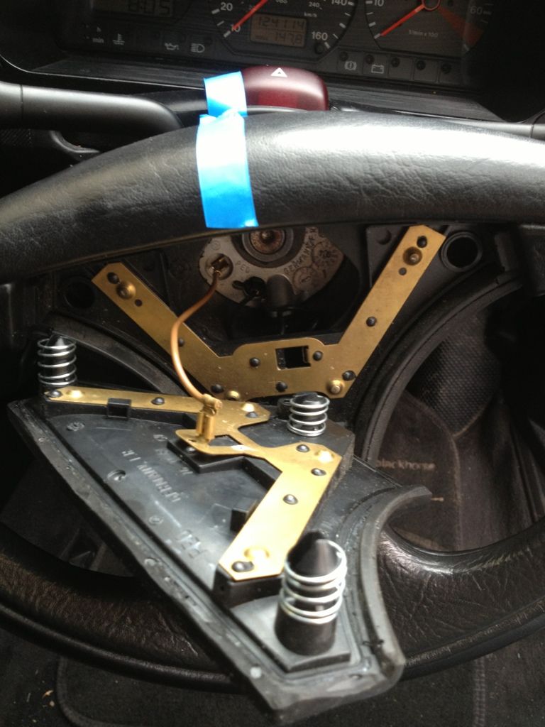

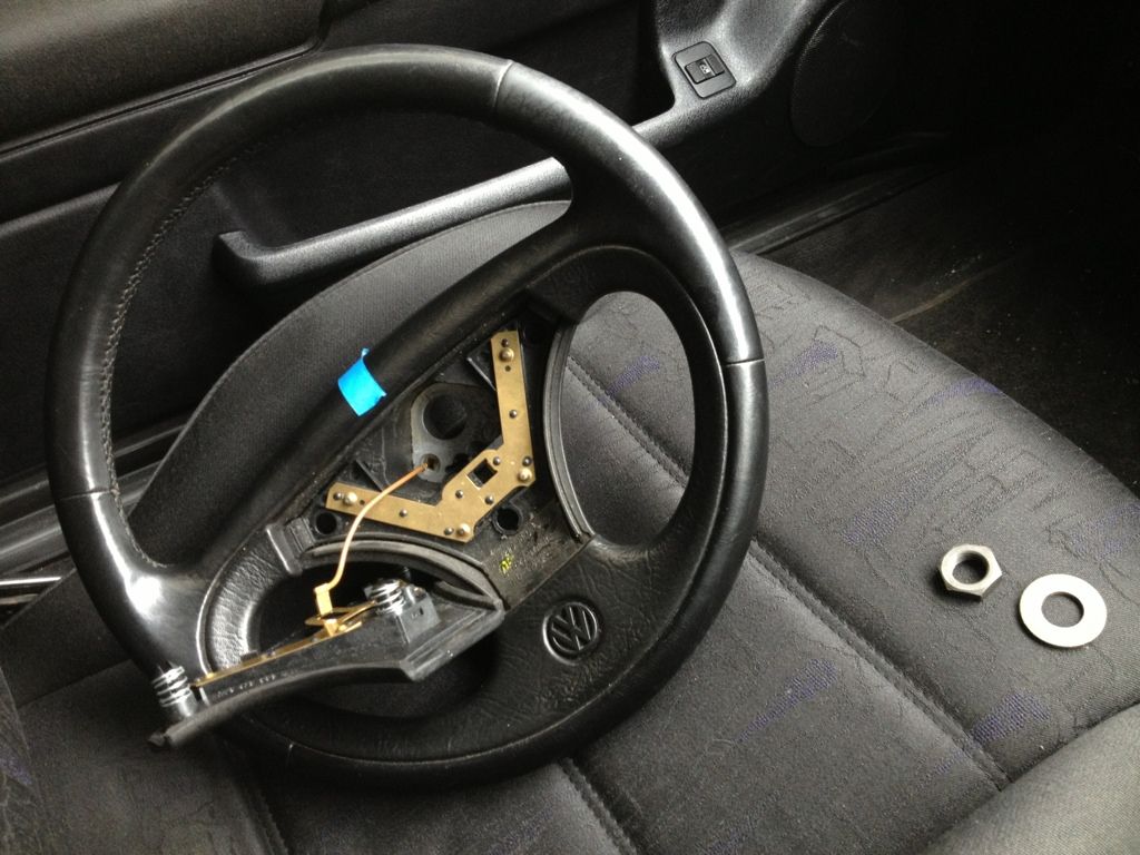

Wayne2015 10 Posted March 27, 2015 Pull off horn cover, taking care not to pull too hard as its connected with a spade connector. Disconnect spade, undo bolt, pull off wheel. Simples! Silicon grease can be got from any motor factors or DIY store mate. How tight do I tighten that bolt? I ll give this a go tomorrow too! Quote Share this post Link to post Share on other sites
delfinis38 1 Posted March 27, 2015 How tight do I tighten that bolt? I ll give this a go tomorrow too! At a guess 40N/m Quote Share this post Link to post Share on other sites
Wayne2015 10 Posted March 27, 2015 At a guess 40N/m English for Dummies, please! :scratch: Quote Share this post Link to post Share on other sites
seanl82 23 Posted March 27, 2015 At a guess you don't have a torque wrench if you are asking that Wayne, which kinda makes your question irrelevant. Pretty tight mate........ Better answer? :lol: Quote Share this post Link to post Share on other sites
Wayne2015 10 Posted March 27, 2015 At a guess you don't have a torque wrench if you are asking that Wayne, which kinda makes your question irrelevant. Pretty tight mate........ Better answer? :lol: :thumb right: Lol - I do have a torque wrench! :lol: But never actually used it! Thought they were ONLY for wheels? I still learning something new these days :lol: Quote Share this post Link to post Share on other sites

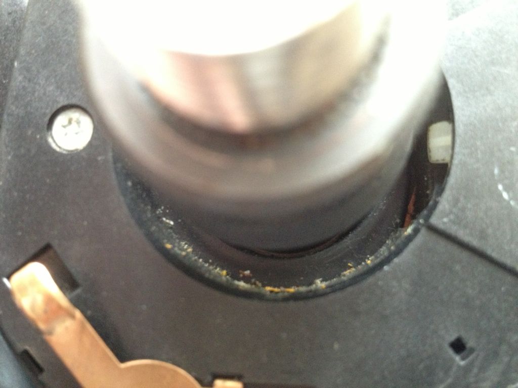

Wayne2015 10 Posted March 28, 2015 Guys U think its this causing the scraping? I did noticed from time to time quite a bit of debris falls onto the dash (not sure from where? Dodgy windscreen replacement? I mean all windows are shut etc - but ONLY happens when I drive fast!)...this TAB on back of steering wheel and this recess covered with debris on steering column... Quote Share this post Link to post Share on other sites

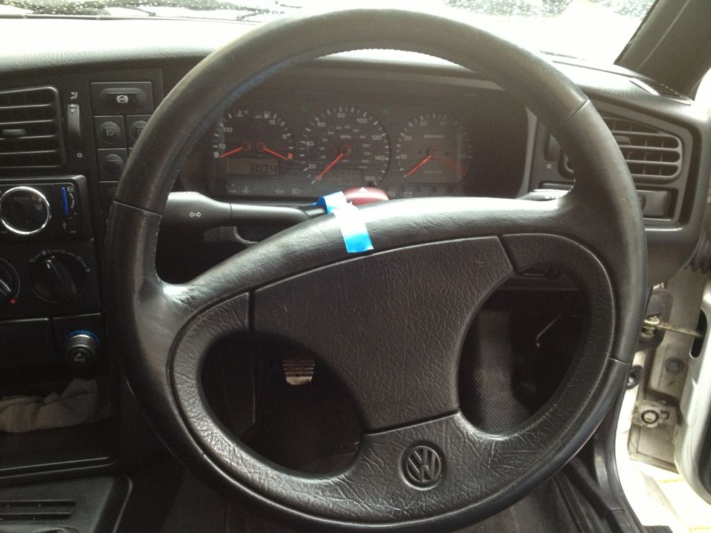

Wayne2015 10 Posted March 28, 2015 Done! :dance: Quote Share this post Link to post Share on other sites
Wayne2015 10 Posted March 28, 2015 Both fans are very very loose - spins like silk! :clap: Quote Share this post Link to post Share on other sites
Wayne2015 10 Posted March 28, 2015 er, is there a separate horn fuse? Quote Share this post Link to post Share on other sites
seanl82 23 Posted March 28, 2015 Yes mate, have a look on the bottom of the fusebox cover to see which position it is. Ignition needs to be on for the horn to work btw. Quote Share this post Link to post Share on other sites
