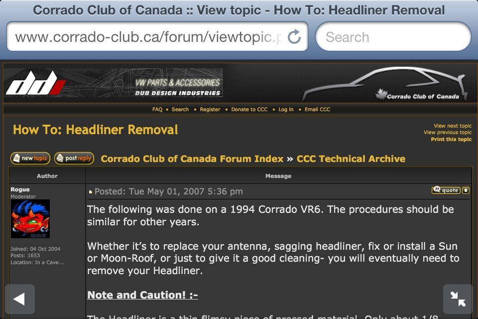

g0ldf1ng3r 14 Posted March 31, 2015 Found this awesome headliner removal steps :thumb right: I want to give it a go too (check sunroof leak, aerial leak, sort any rust too :)) http://www.corrado-club.ca/forum/viewtopic.php?t=9258 nice find wayne printed & stored with my other how to's lol Quote Share this post Link to post Share on other sites

MZpog 10 Posted March 31, 2015 Headliner removal is/was pretty easy, but I wouldn't try it alone as it's easy to bend/break it. Quote Share this post Link to post Share on other sites
Wayne2015 10 Posted March 31, 2015 nice find wayne printed & stored with my other how to's lol No worries, bud 8) I removed mine and find the following to add: That link very very good step by step removal of headliner. But, Be warn that its very very tight to pull out headliner. So, I recommend : 1. Remove as much trim as possible (or at lease loosen up)!!! 2. Prepare to get the inside covered in debris/old foam 3. Prepare to warp (of even crease/snap sponge headliner) 4. U need TWO people when pulling out the headliner (one to pull the other to keep bending the trims!) 5. Headliner needs new foam strips to replace on the topside (either they old or ripped out when sliding out :eek:) 6. Think about HOW to slot headliner back in :shocked!: But, this is just my experience :lol: Quote Share this post Link to post Share on other sites
Wayne2015 10 Posted March 31, 2015 Headliner removal is/was pretty easy, but I wouldn't try it alone as it's easy to bend/break it. Totally agree! I think did mine within 30mins...but at the end did struggle and got my son to sit inside to bend the trims more... Quote Share this post Link to post Share on other sites
