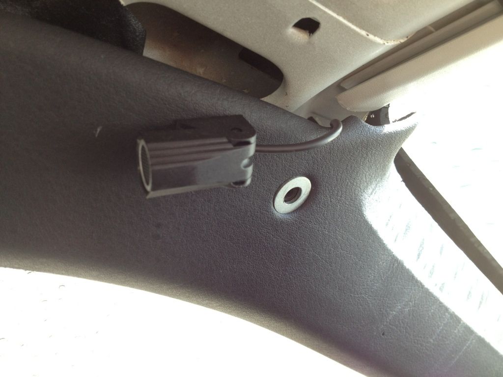

Wayne2015 10 Posted March 31, 2015 Weather today from hot sunny but windy, To heavy torrential rain :eek: But got out to have a THIRD go at removing this: Rear coat hooks: 1. First go: push up with force - nope :( 2. 2nd go: whacked with mallet - nope :eek: 3. Now: prise with flat blades and push up - nope :shocked!: Got fed up so tried twisting it - have i broken the brass hook underneath? I just think IMPOSSIBLE to separate brass hook underneath from hook :( I cant even see the brass hook:eek: Quote Share this post Link to post Share on other sites

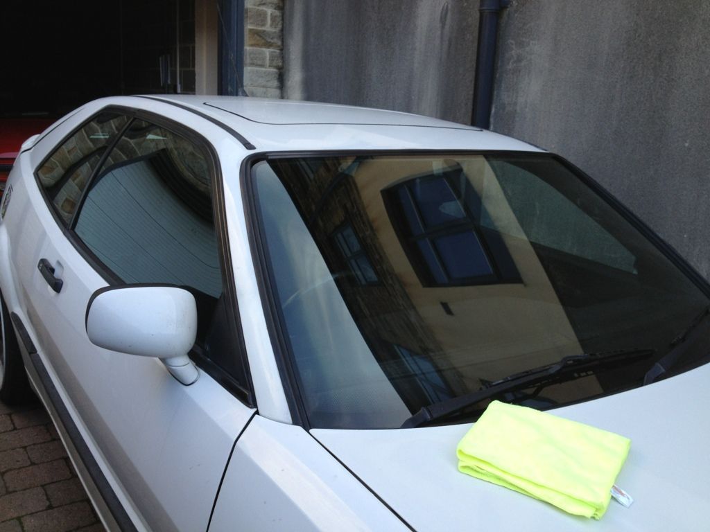

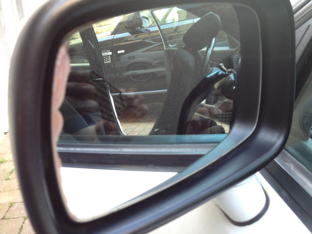

Wayne2015 10 Posted April 8, 2015 Detailing windows! BEFORE Wash glass Clay glass IPA Rain repellant all round (AngelWax H2GO) - one coat sides - 2 coats rear - 3 coats front RainX 2-1 (rubbish! So using it inside rather than outside!) AFTER (pics does no justice! :() Quote Share this post Link to post Share on other sites
