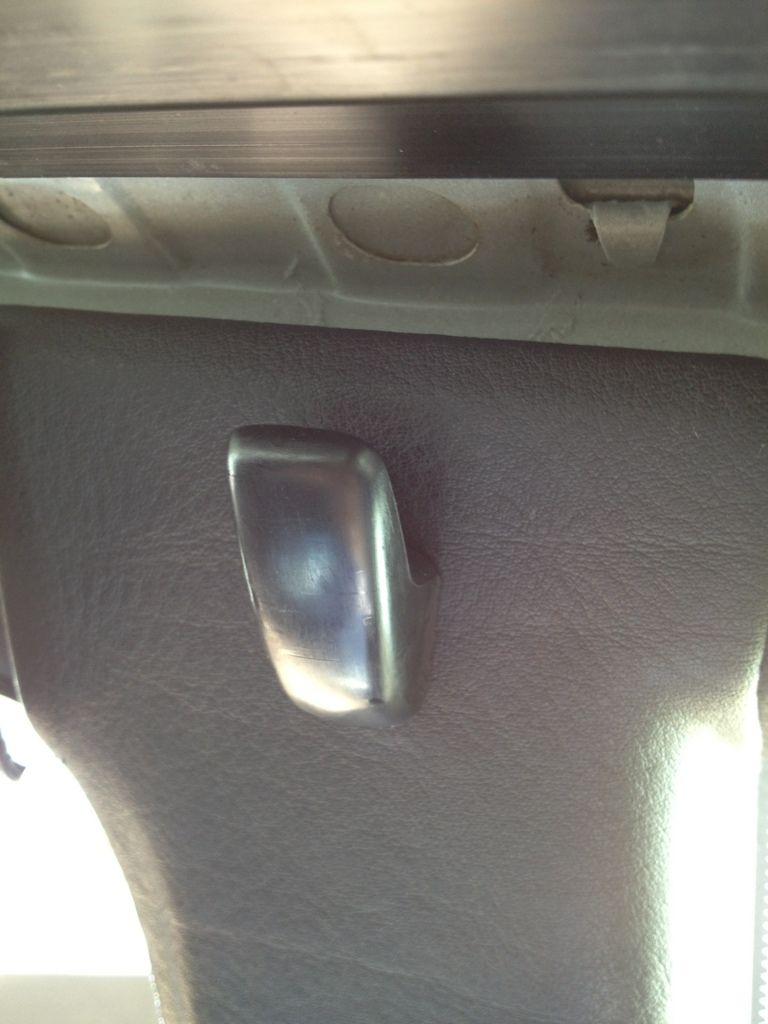

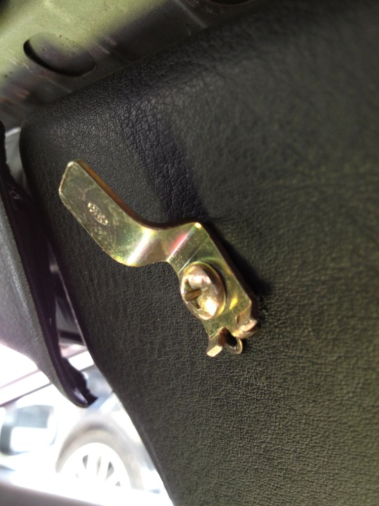

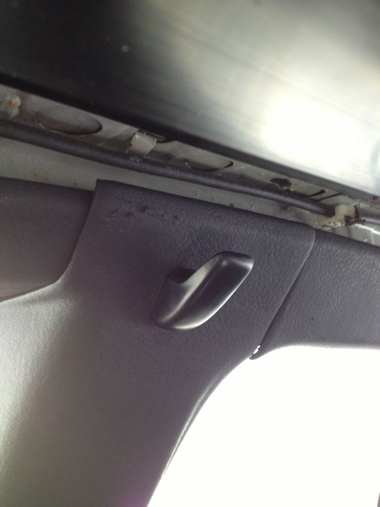

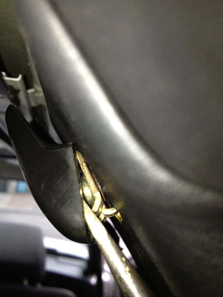

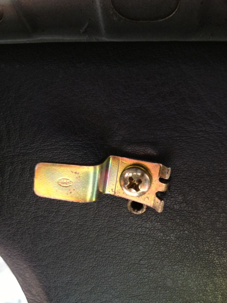

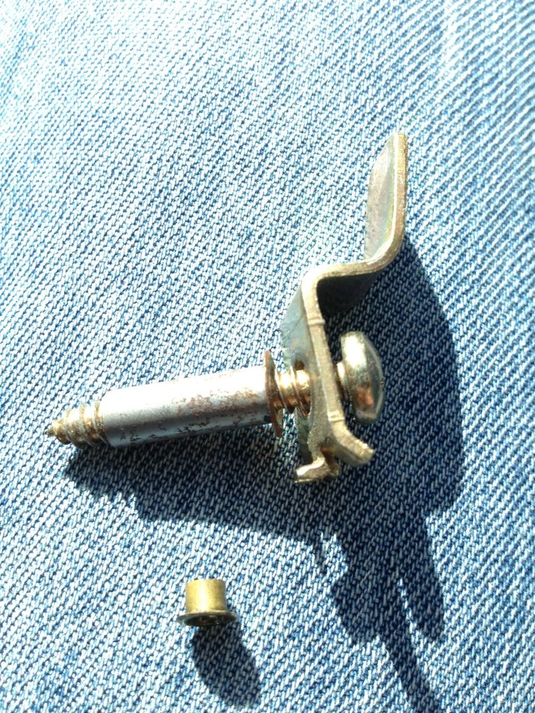

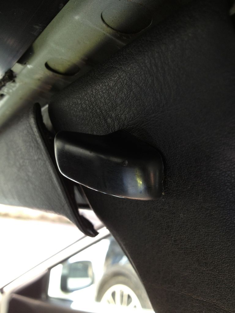

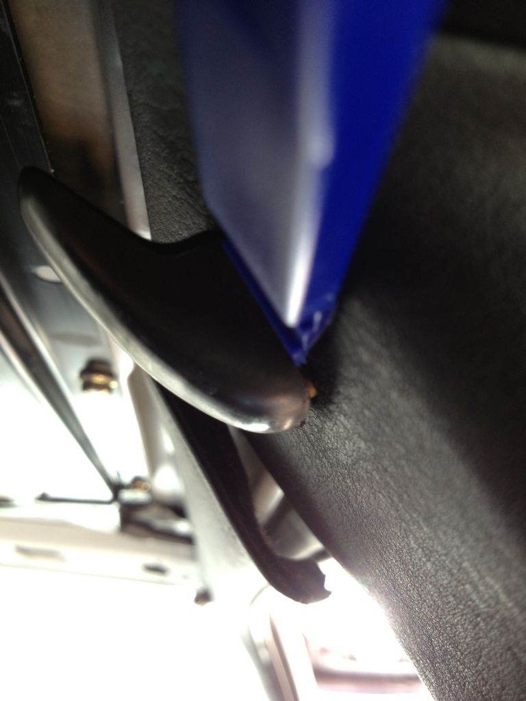

But got out to have a THIRD go at removing this:
Rear coat hooks:
1. First go: push up with force - nope :(
2. 2nd go: whacked with mallet - nope :eek:
3. Now: prise with flat blades and push up - nope :shocked!:
Got fed up so tried twisting it - have i broken the brass hook underneath?
I just think IMPOSSIBLE to separate brass hook underneath from hook :(
I cant even see the brass hook:eek:
Ok

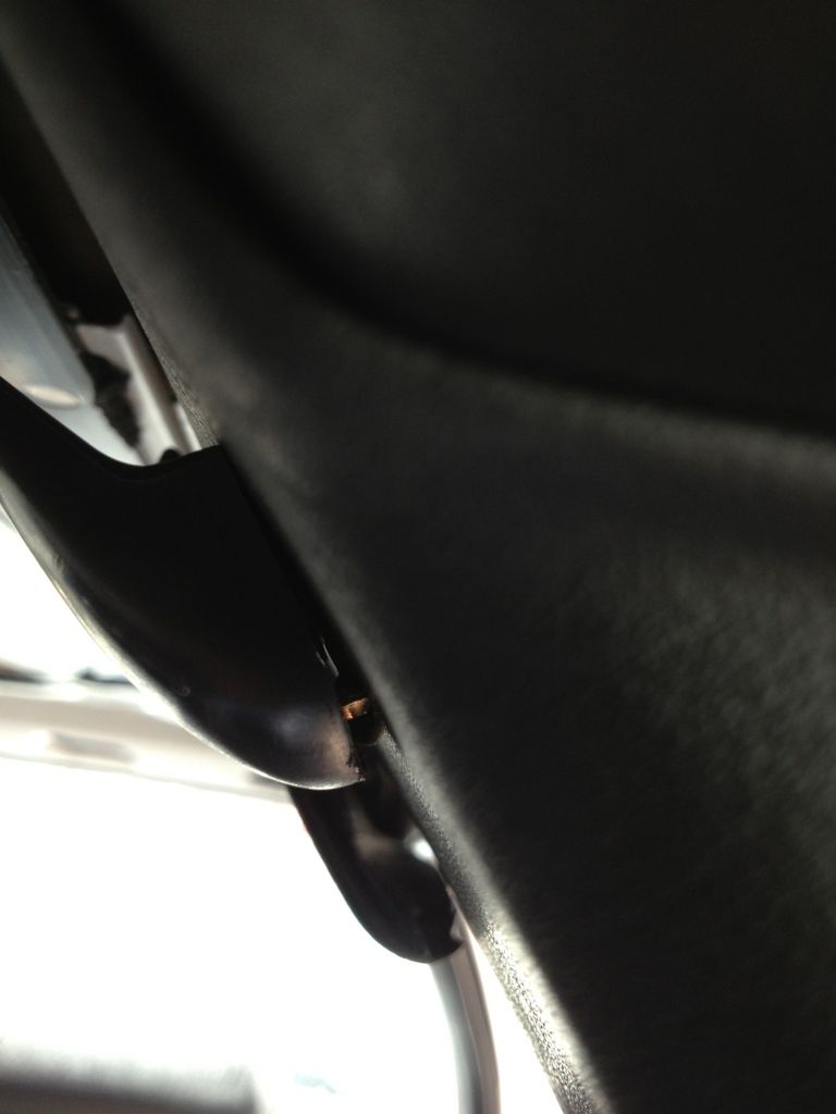

FORTH attempt at removing the coat hooks! Grrrrrr! :mad:
After forcing a screw driver wedged between plastic hook and screw fixing underneath...
U CANNOT simply push up and remove the hook! :eek:
U have to separate the bottom of the hook from the screw fixing first, THEN u can push up and remove...

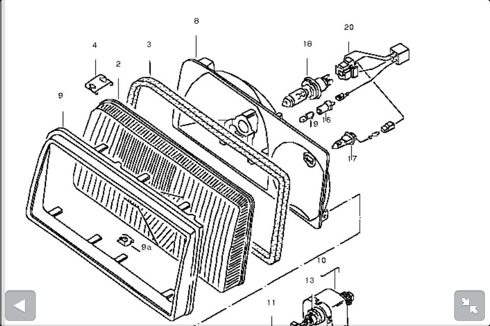

Still unsure what bulbs for:
1. Side indicators are
2. Front turn indicators
3. No.19 in pic below are?

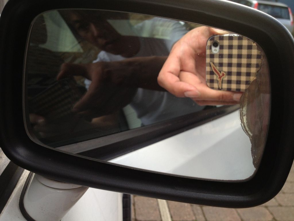

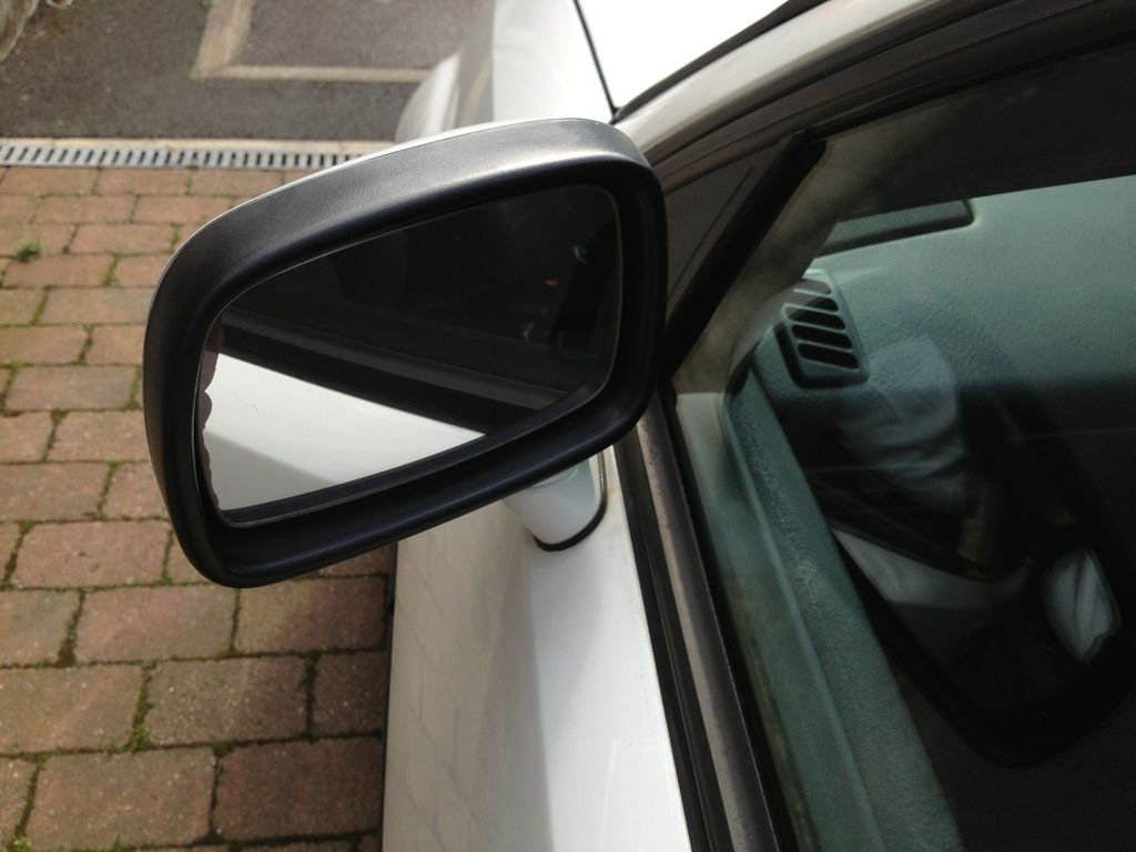

Have also bought replacement wing mirror glass,
as mine are severely corroded from the edges,
and the driver mirror is very poor coverage to almost dangerous! :eek:

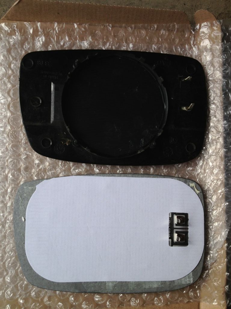

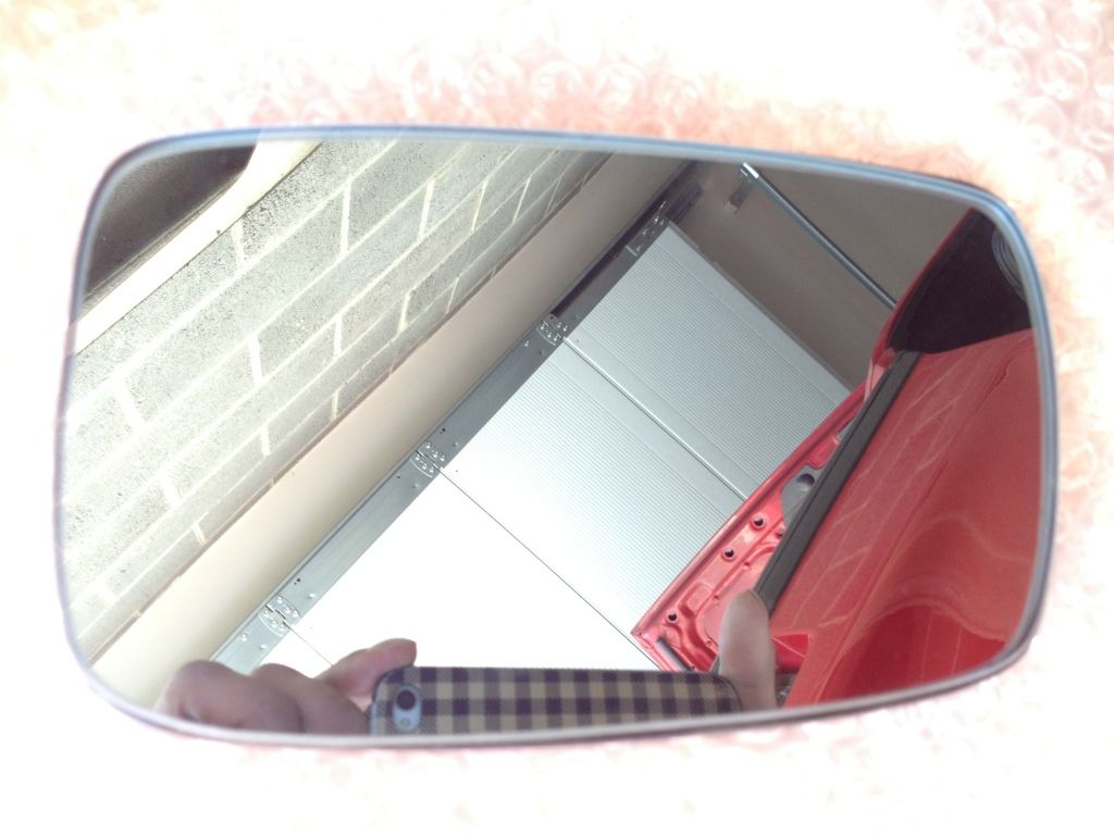

Heated convex blue-tinted Mirrors arrived:
Had some free time so here goes ...
BEFORE (driver side corroded and poor vision)
To be continue ...

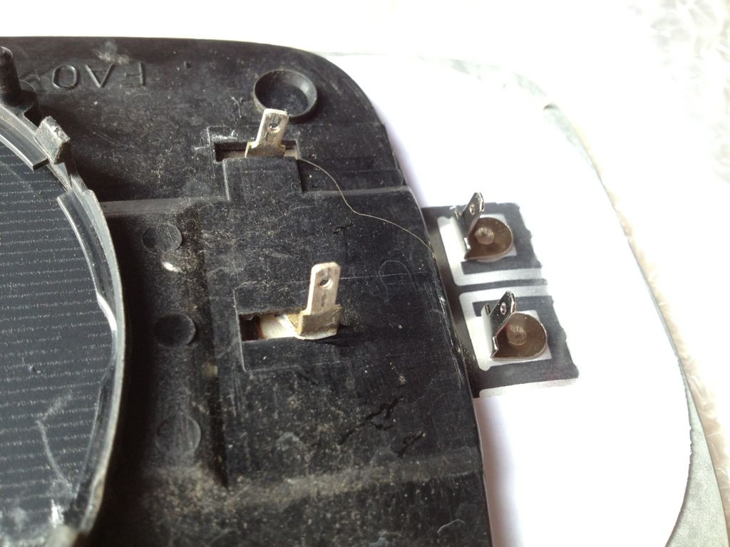

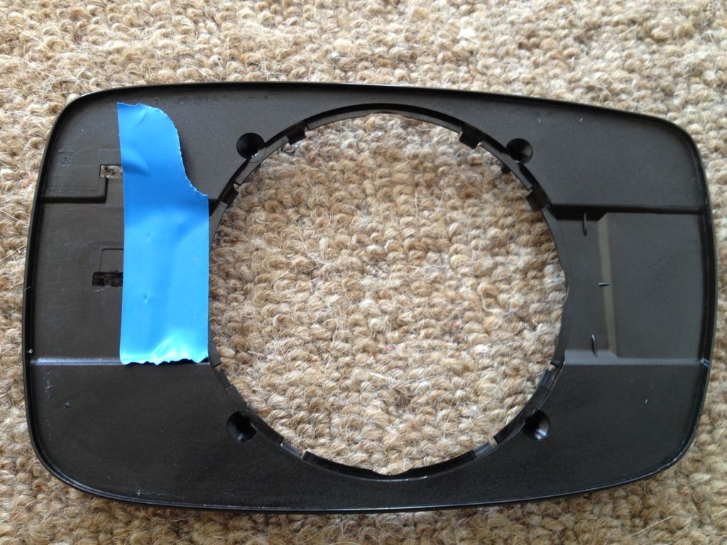

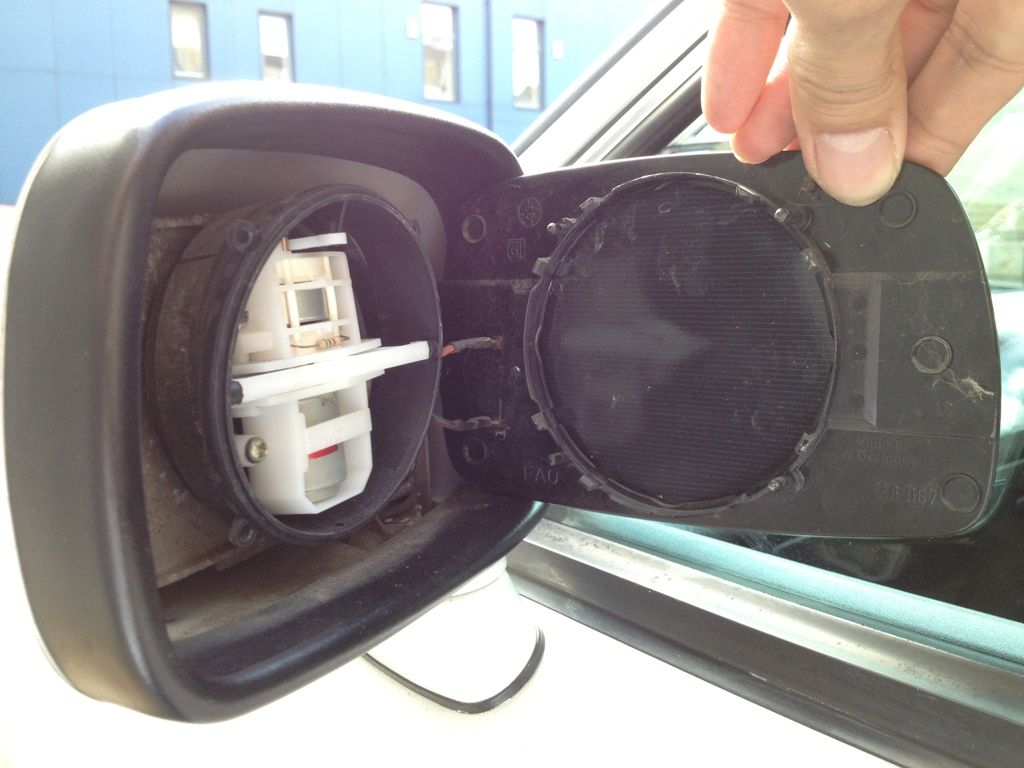

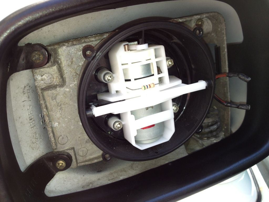

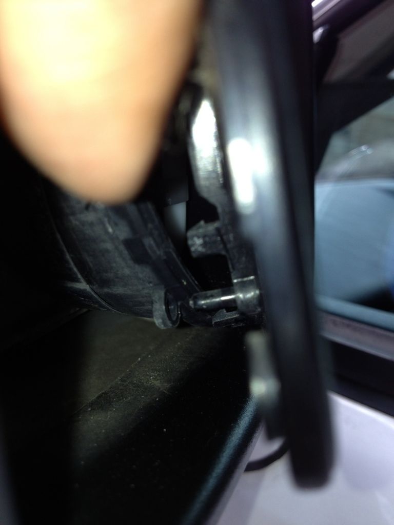

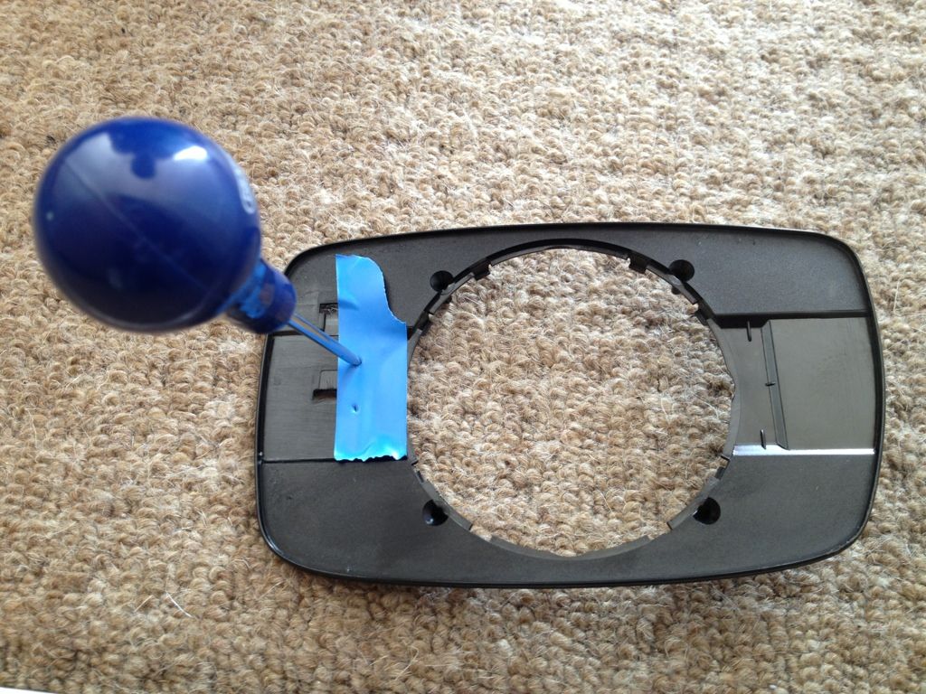

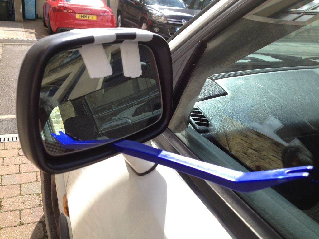

x4 tabs (or clips) to prise away backing plate off

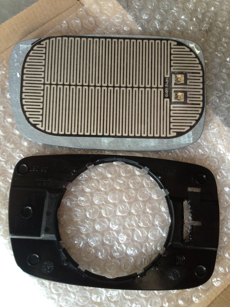

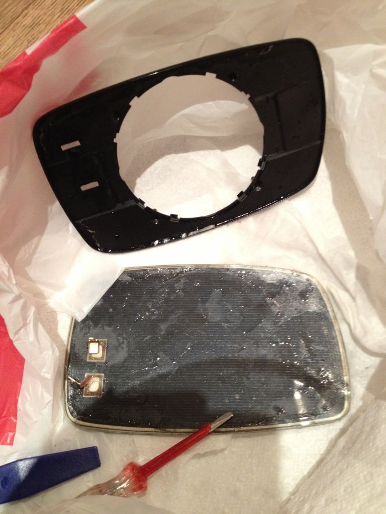

Passenger backing plate + mirror vs new mirror

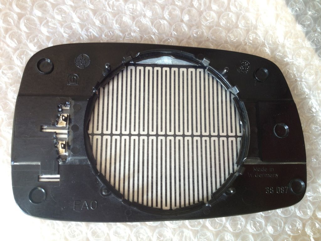

New Heated mirror tabs in WRONG place!
Electrical cleaner to spray into heated mirror terminals
(Thanks to member Sanky :thumb right:)
Trim cleaner to clean wing mirror housing trims + backing plates

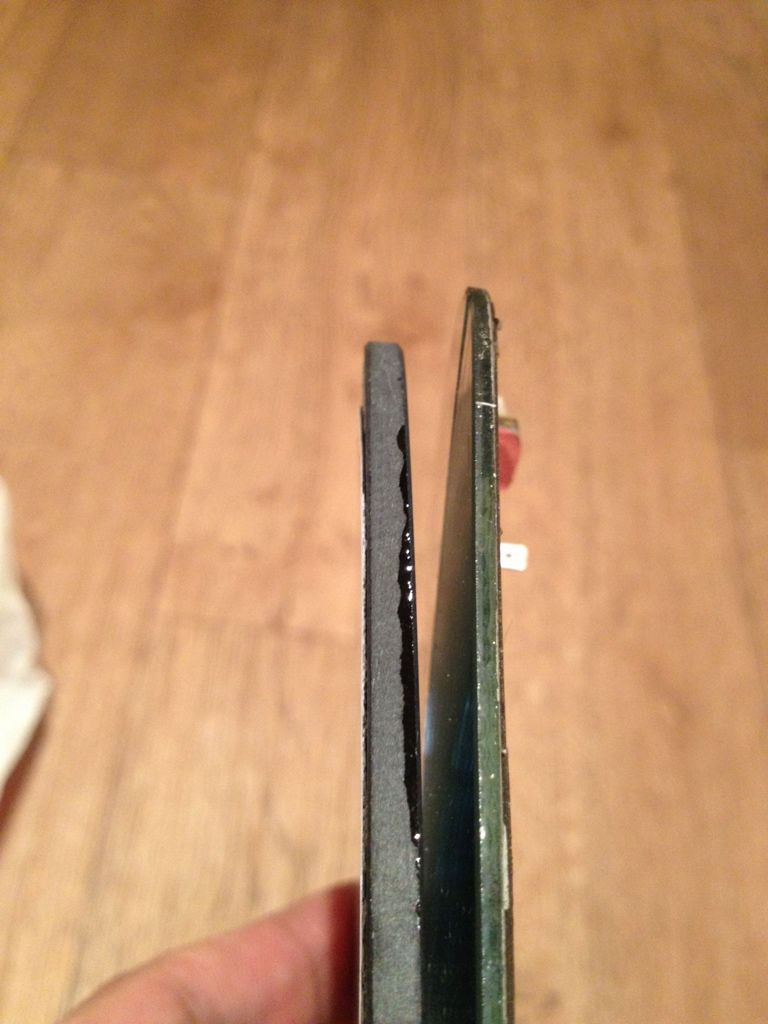

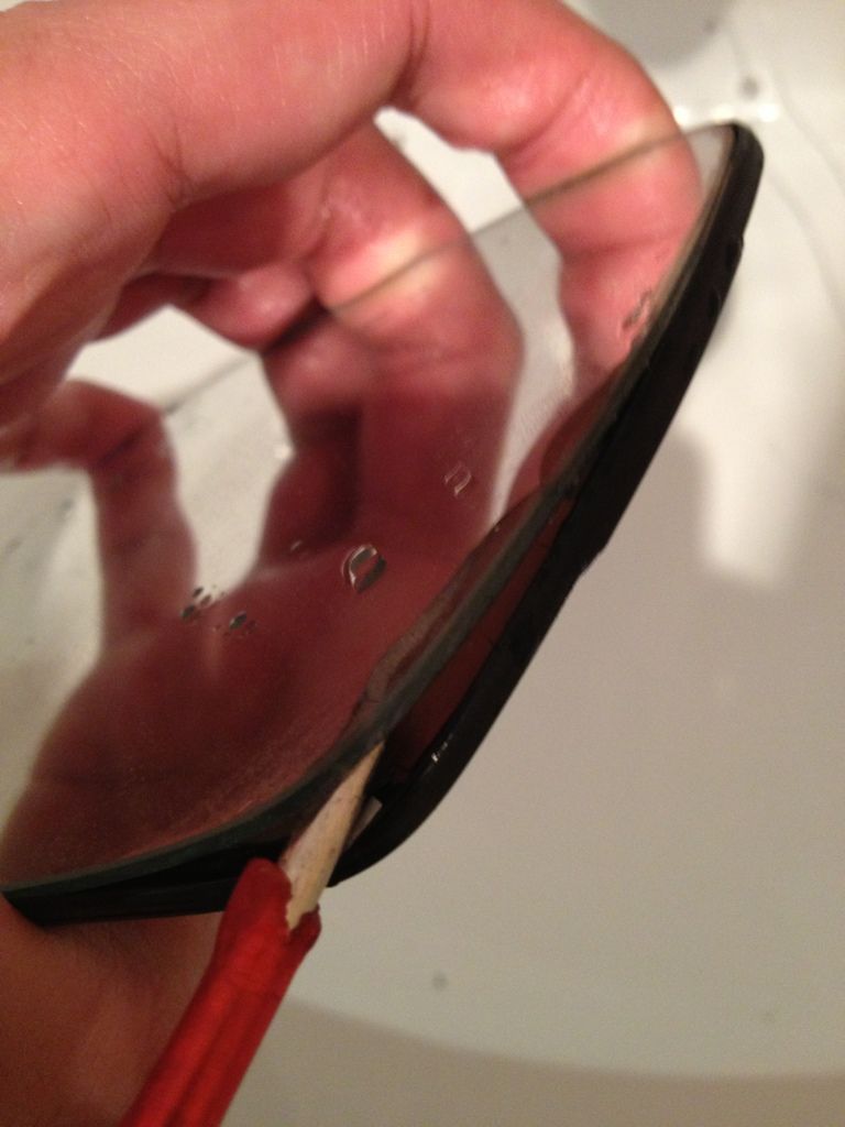

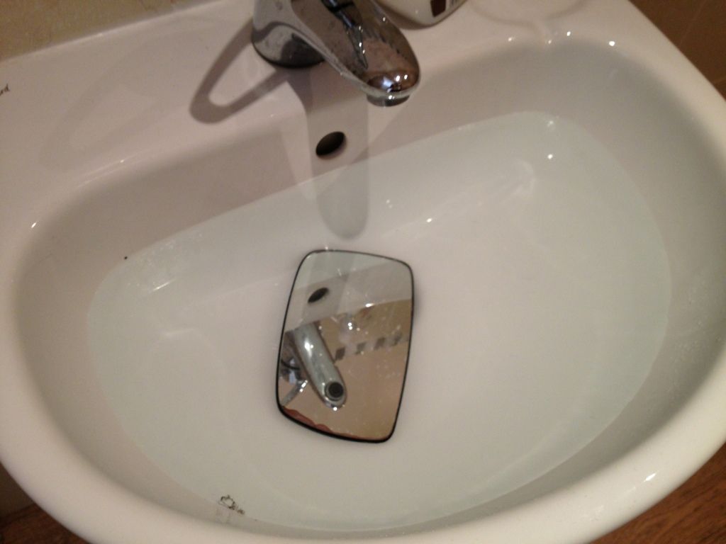

I tried dental floss to remove old mirror from backing plate - but no luck :( :( :(
Thanks to Andy (HairyArse) HOT water is the way to lift old mirror from backing plate!
Piece of cake! :dance:
THANKS Andy!!! :) :D
New mirrors THICKER!

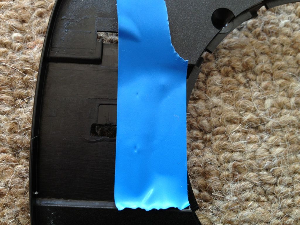

Mark where new heated tabs goes
And cut out new holes for new mirror heated tabs!
New passenger side mirror a tight fit into backing plate
But driver mirror was a perfect fit! :)

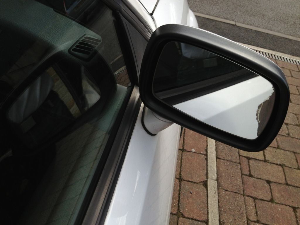

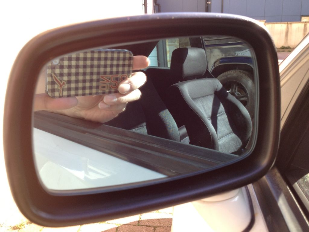

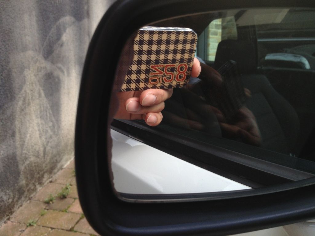

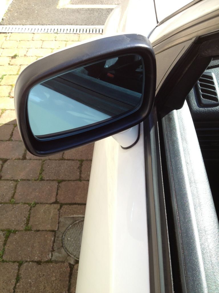

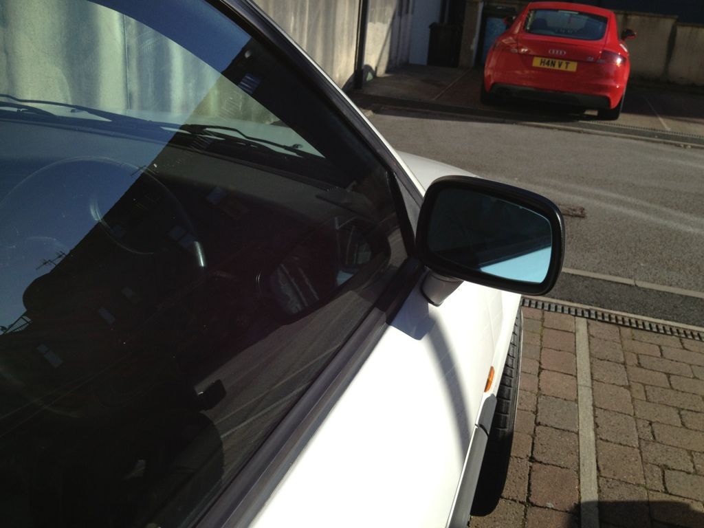

Done!
2.5 hour afternoon job :dance: :D

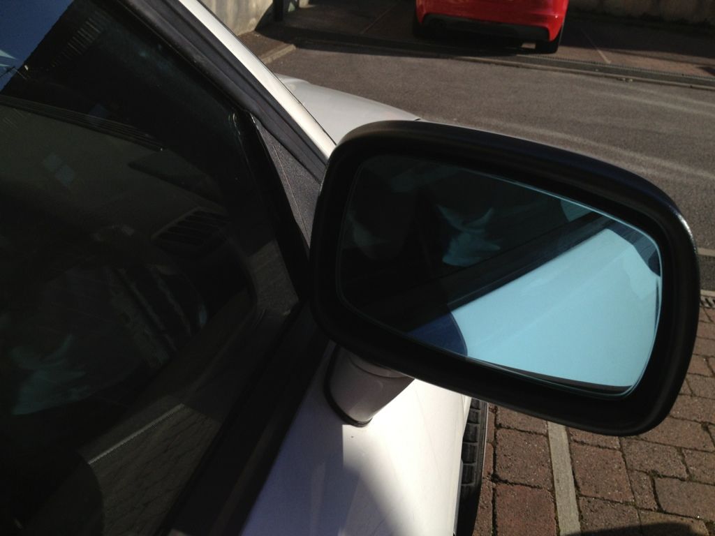

Nice blue tinted heated convex mirrors :)
Again FIRST time i ever change wing mirrors! :eek:
So am VERY PLEASED!

Really nice work on the mirrors, looking great!
This is something I need to do myself, but I'm not to sure about getting the normal ones or the blue versions.
Did you notice any differences besides the look of them?
One positive thing I can imagine, is that the lights of others are less irritating at night.
