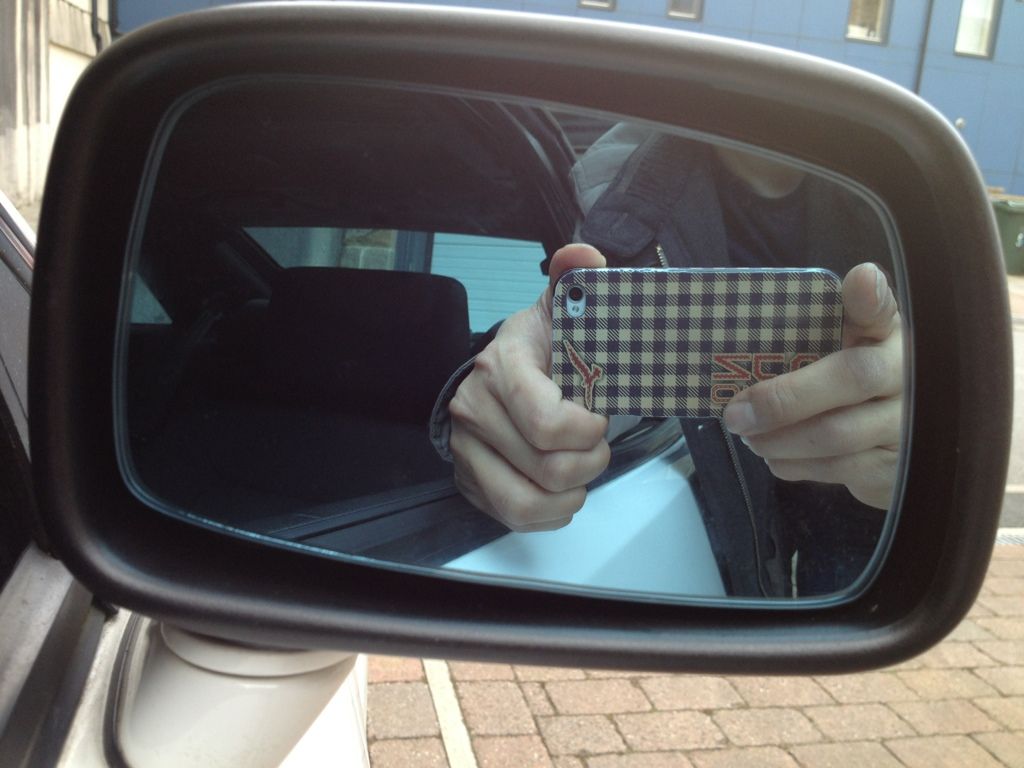

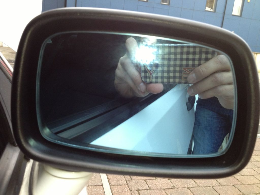

Really nice work on the mirrors, looking great!
This is something I need to do myself, but I'm not to sure about getting the normal ones or the blue versions.
Did you notice any differences besides the look of them?
One positive thing I can imagine, is that the lights of others are less irritating at night.
Thanks bud :)
Will drive the car today (after fitting mirrors) and feedback! :thumb right:
Mine main bugbear was the fact the driver mirror gave the illusion things were different as it is AND its teeny coverage of your side view :( :( :(

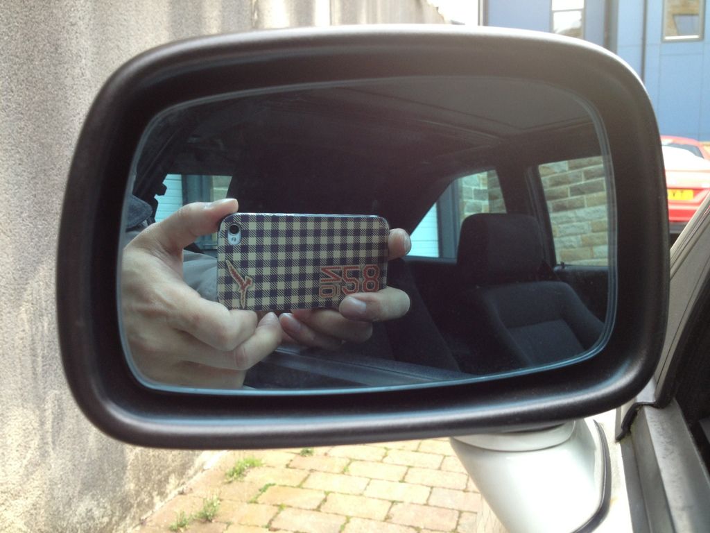

Ok,
U know u said "make sure mirrors are PROPER fitted else they might fall off ..."?
Well,
My pssenger one sits perfectly in housing
Driver side looks a bit wonky
So thinking what u said
Maybe my driver side not properly fitted to all 4 slots/clips? :shrug:
So popped it out again just now, and re-fitted it...
Ah....better?

Hi bud
Did a drive today - MUCH better vision in driver mirror (less of a blind spot - certainly NOT like looking thru a magnifier glass as before! :eek:) :thumb right:
No idea if heating element ever worked before - hopefully they do work :)
Blue tint gives nice softer look (love them or hate them) - I love them! :)
Not sure night time vision - but will find out tonight! :cool:

Drove car tonight
New blue-tinted mirrors crystal clear :thumb right:
U right, less dazzling.
Not as dim as if u had rear dimmable rear mirrors - but slightly dimmed :D
