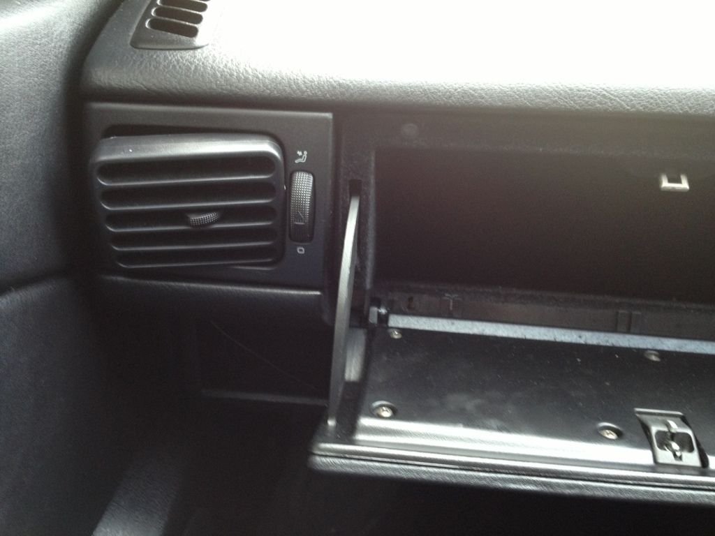

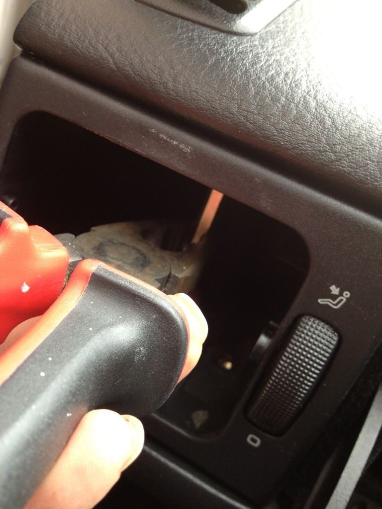

The protruding bit (bottom middle of glove box)

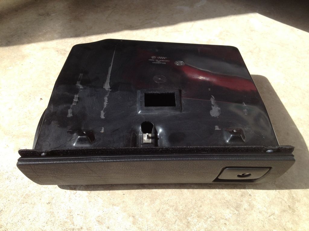

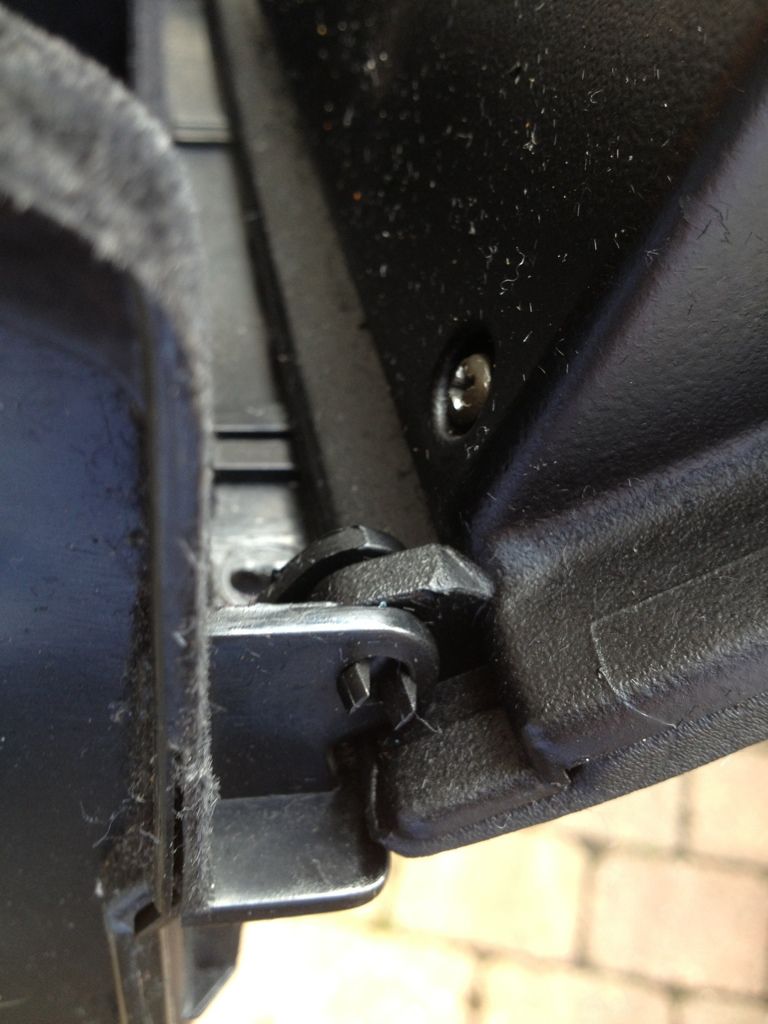

My glove box wasnt shutting properly (lock not stating in lock position)
So took glove box door apart
Take hinge out either side of door bottom
Nothing to take apart/clean really :shrug:
Re-assembled
And the door now closes and locks perfect! :thumbleft:
Guess it just needed re-aligning??? :shrug:

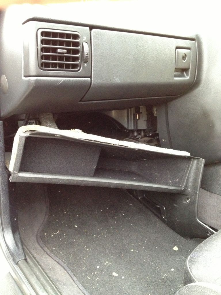

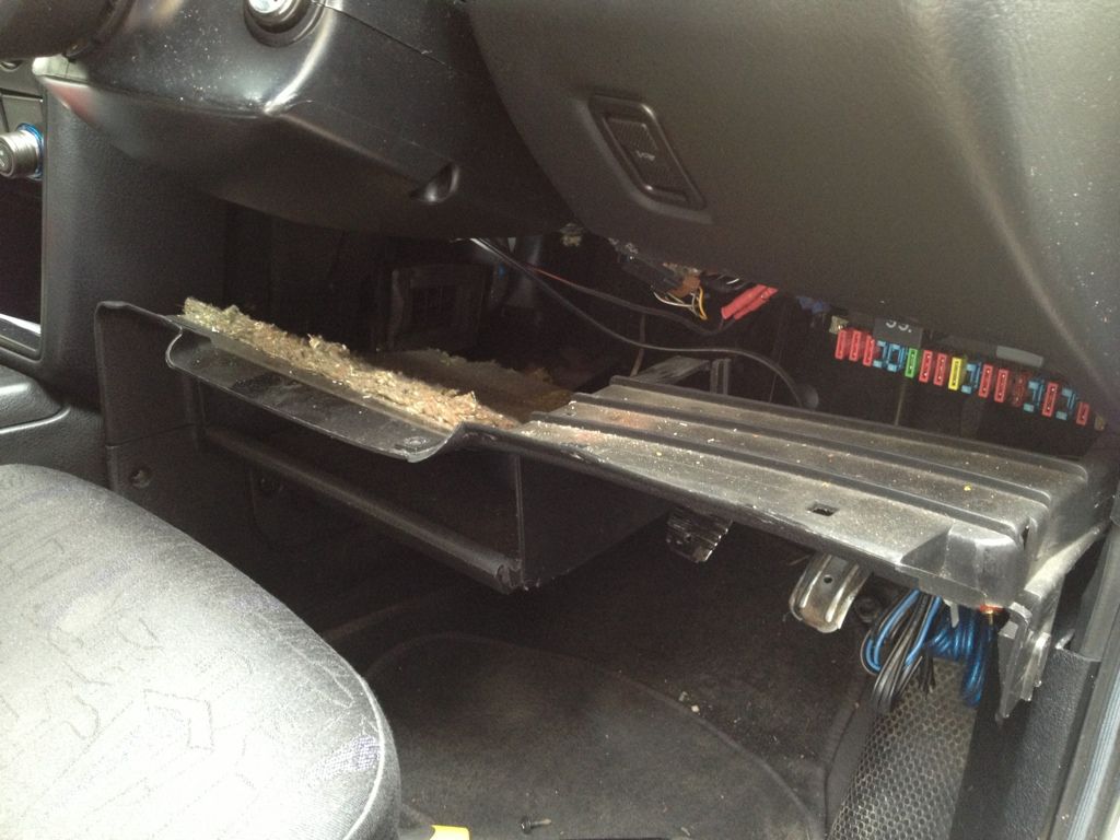

Putting glove box back in a little easier ...
As u can see the protruding part and FORCE it over the metal frame ...
I find it easier to remove glove box if u remove the trim/storage panel under it ...

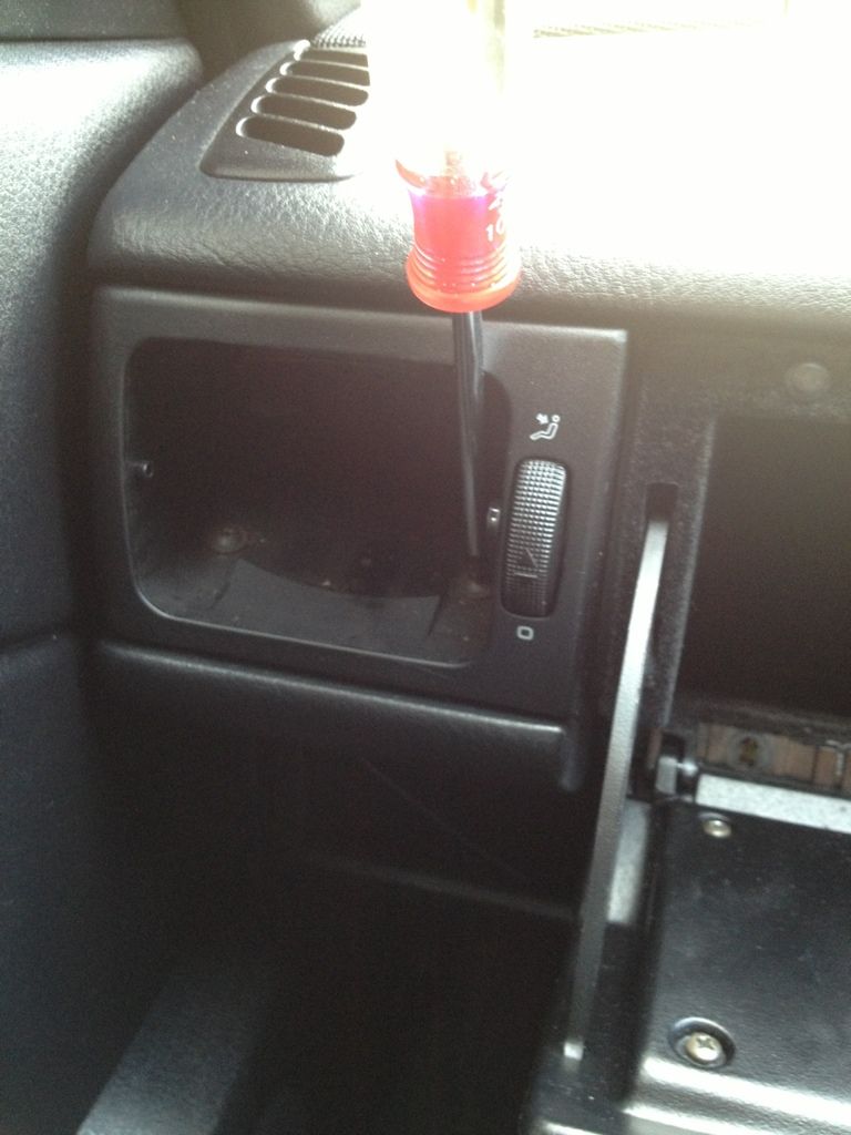

Passenger dash speaker + vent grilles ...
Pull out grille
x2 screws bottom
x1 screw top

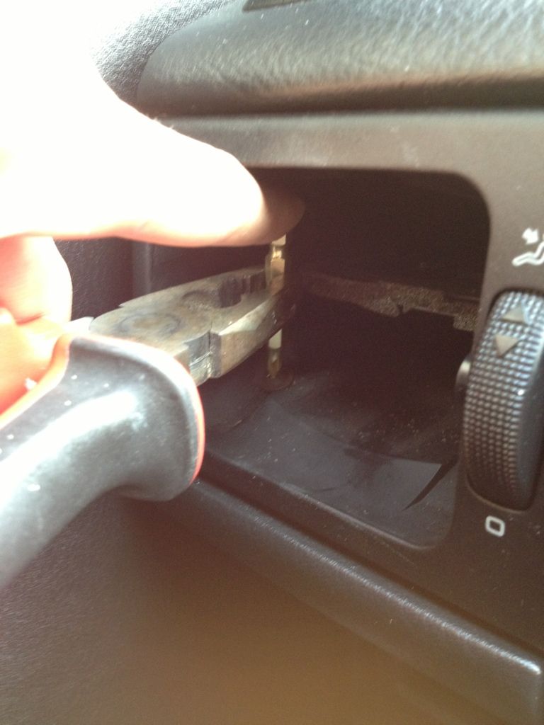

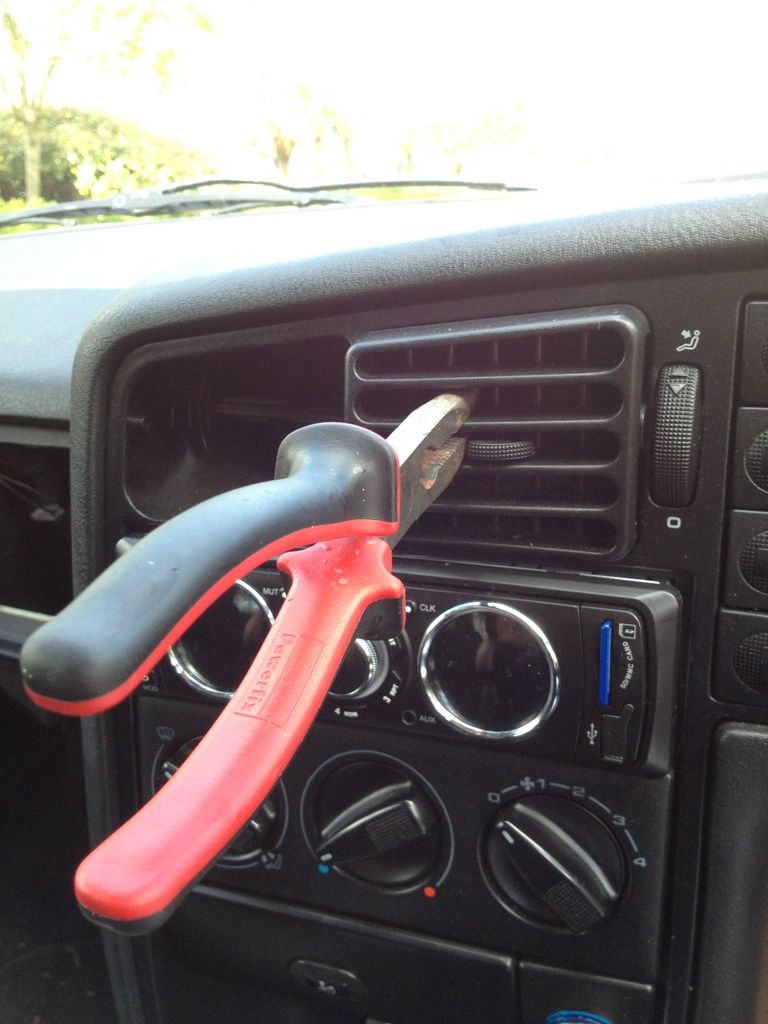

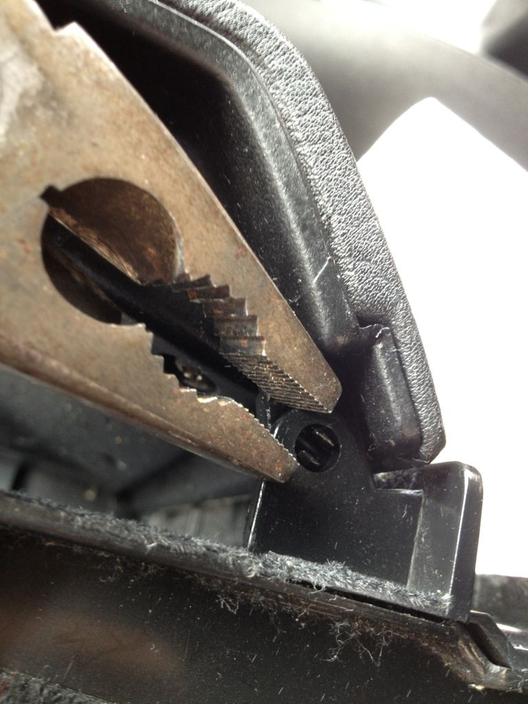

If u have no specialist tool s to remove screws in tight spots
Then like me use screwdriver bit and turn by pliers! :lol:
Bottom
Top
Just pull out vent housing from inside/back

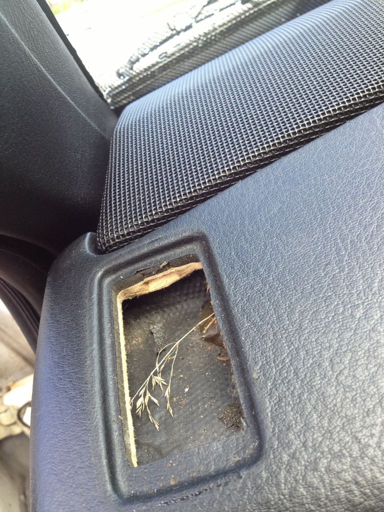

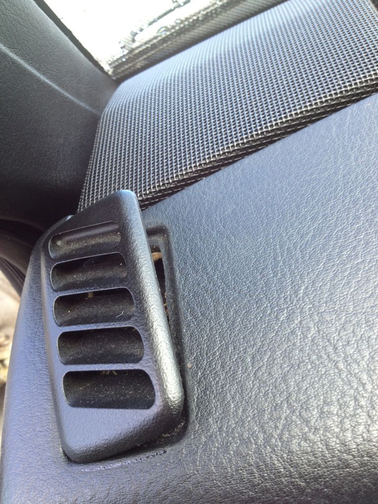

Window vents (pull off)
Look at the debris!

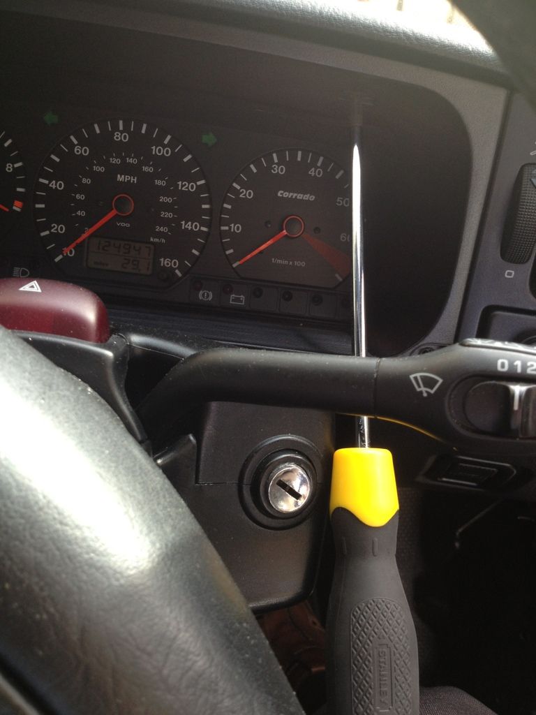

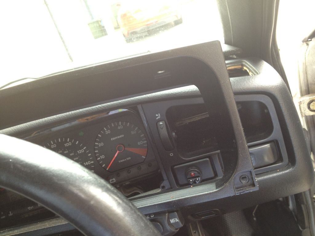

Driver dash speaker + vent grilles + speedo surround ...
Pull out dash vent and just x1 screw top
x2 screws bottom speedo surround
(In my case x1 screw and BLUE TACK :eek: )
x2 screws top
Pull out and remove

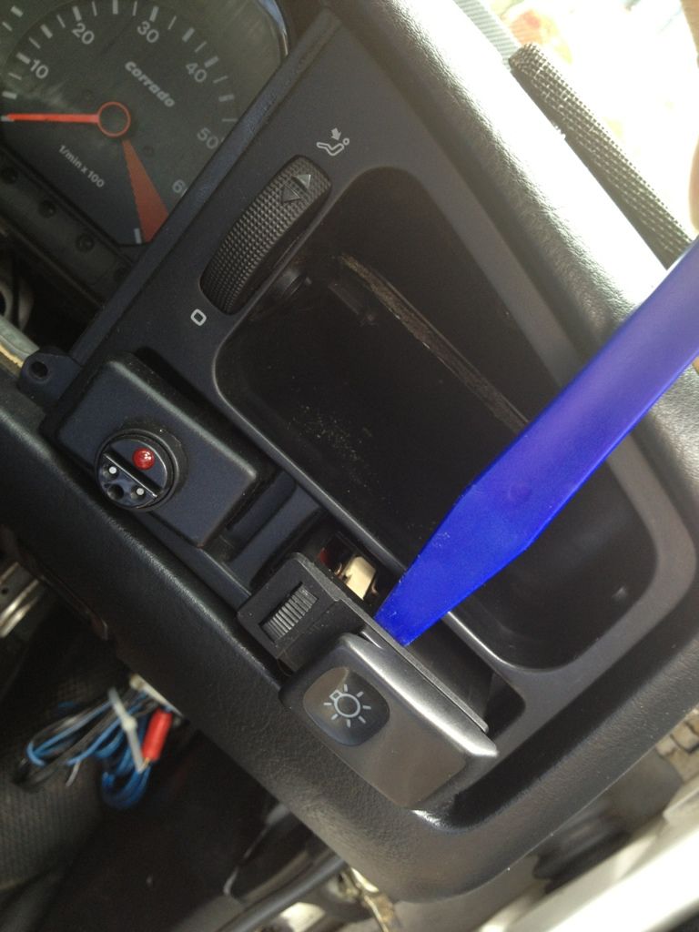

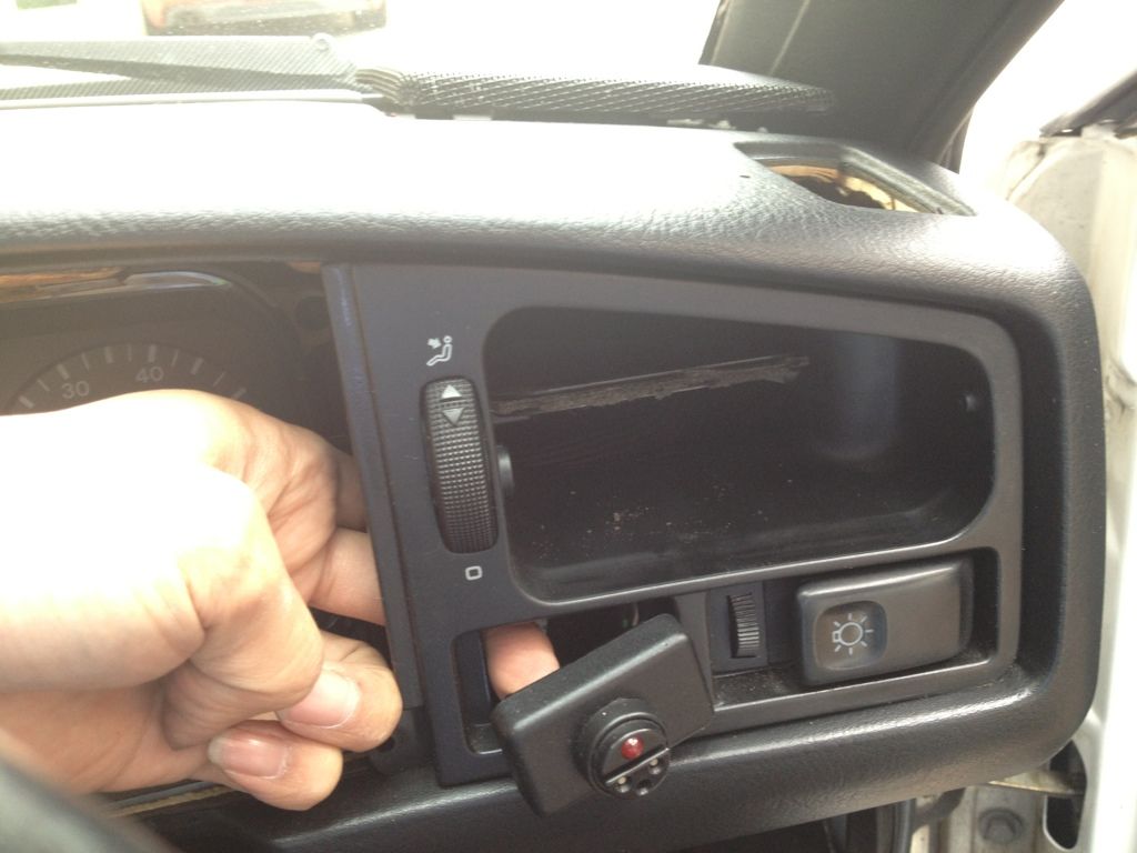

Push out cover (in my case alarm LED)
Same with headlight switch

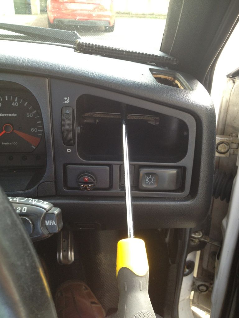

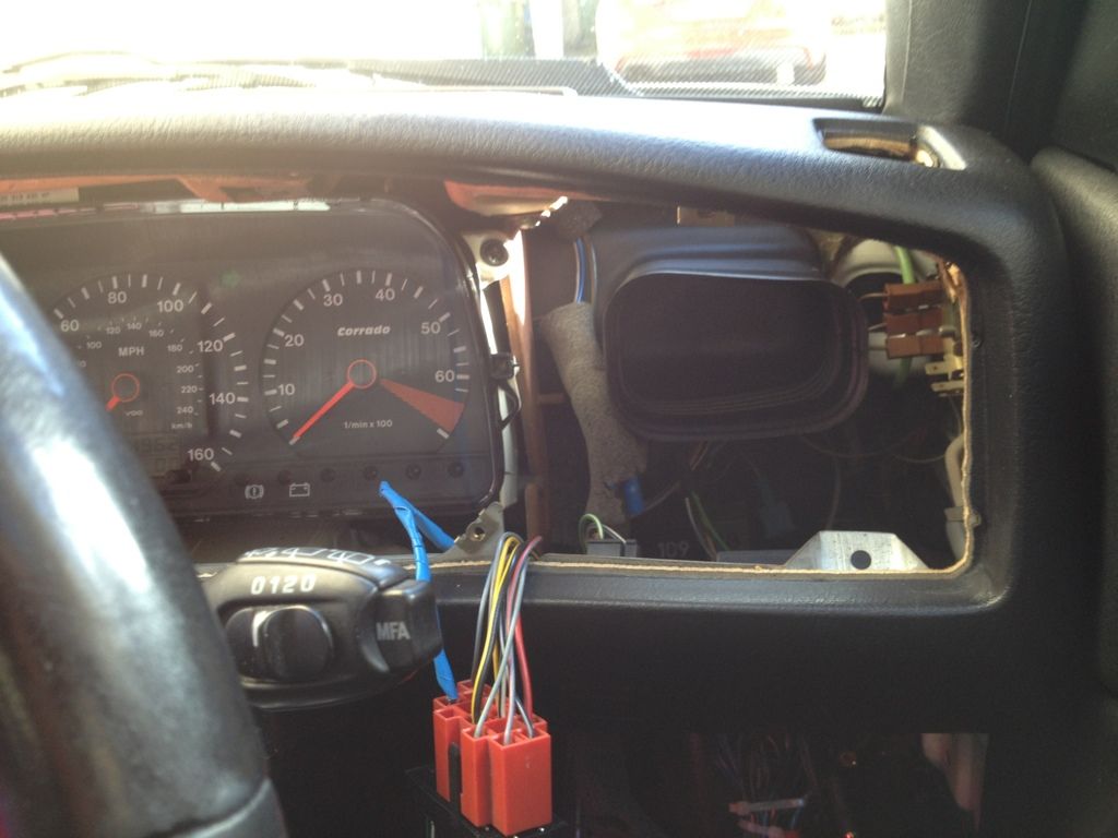

Pull out dash vent housing (from back/inside)

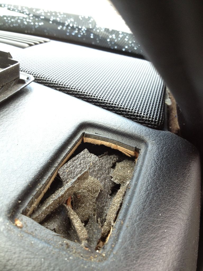

Remove dash speakers + window vent (as u did on passenger side)
My window vent :shocked!:
Think
As this stage i went a bit crazy
And started to remove anything and everything!!! :eek:

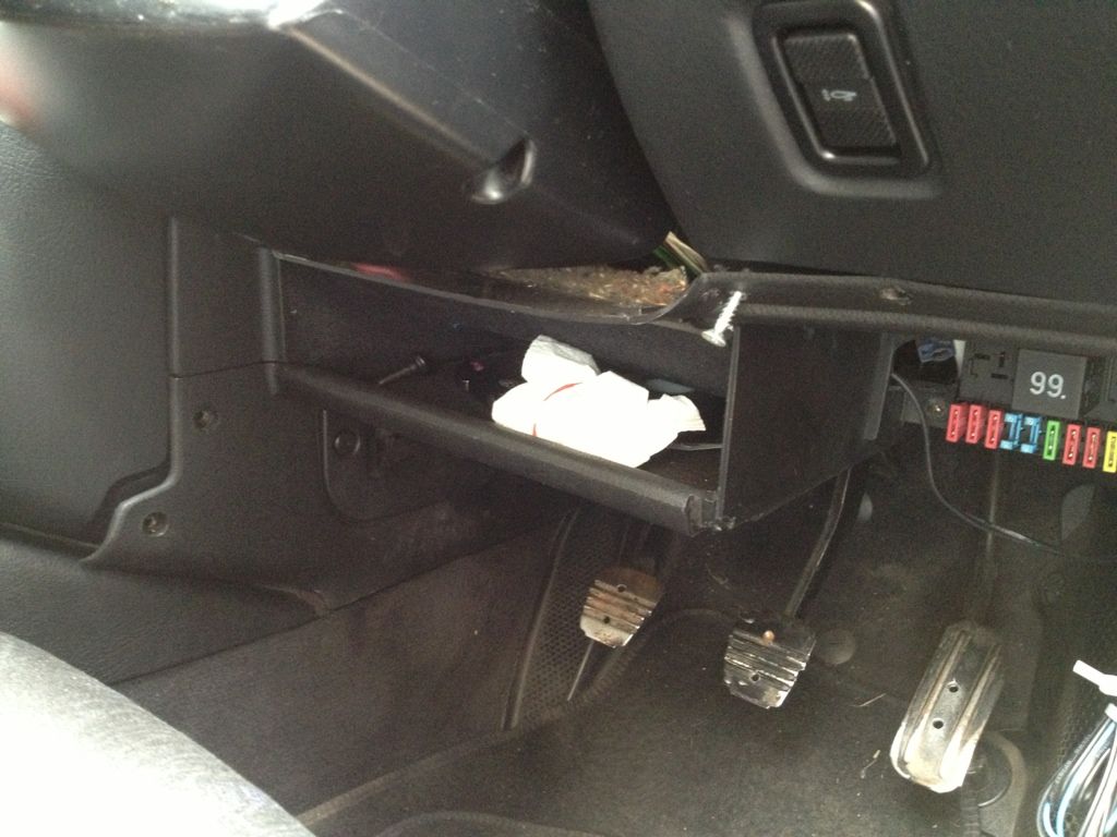

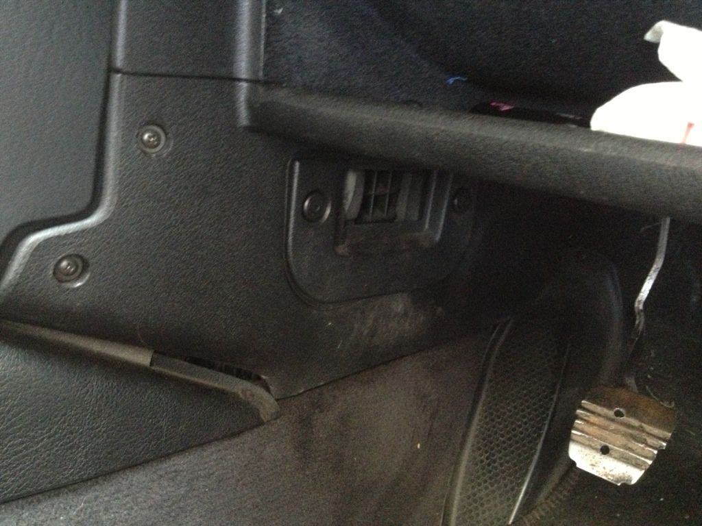

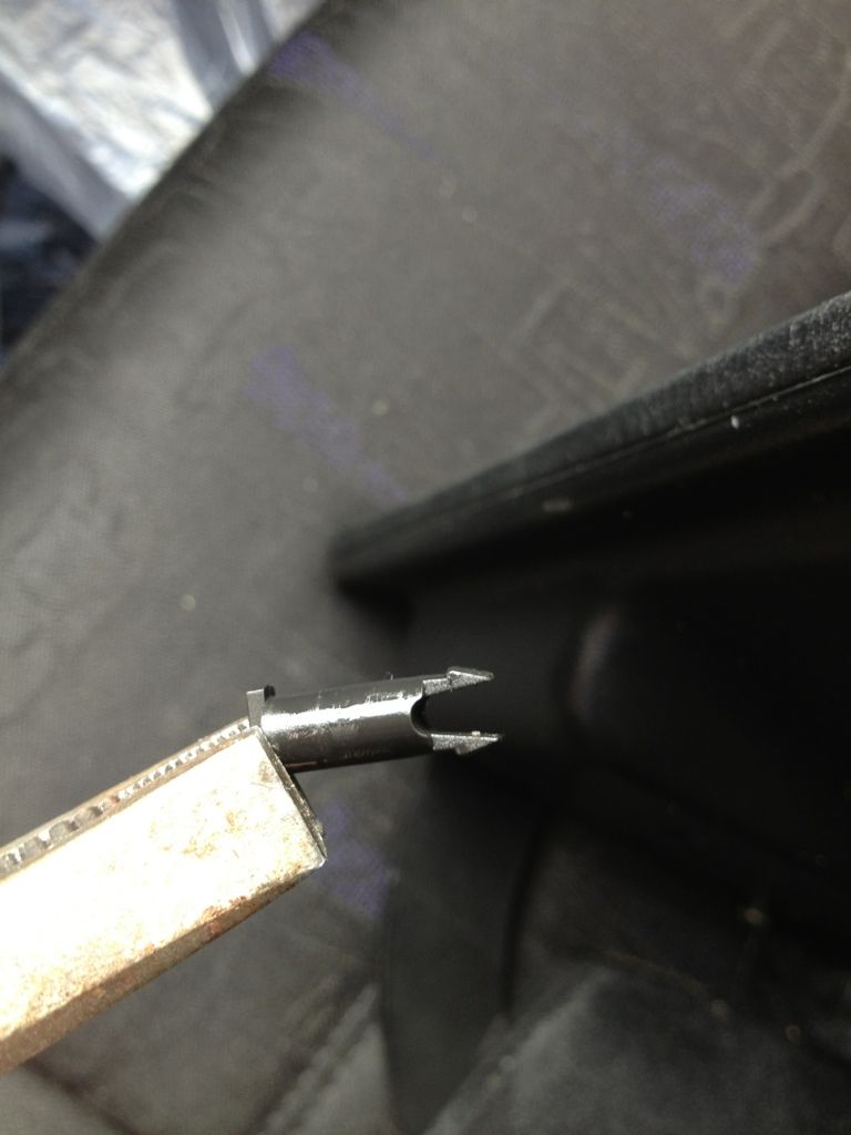

Putting back the storage panel under the glove box ...
Anyone know what clips/screw caps /cover for this fixture (to secure the storage panel to floor)???
