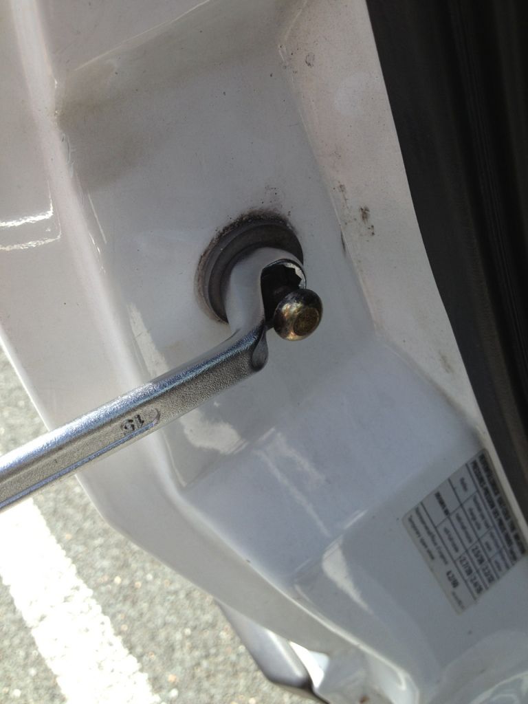

My driver door i REALLY need to slam it to close :eek:
Or hold it and push hard/fast to close :shocked!:

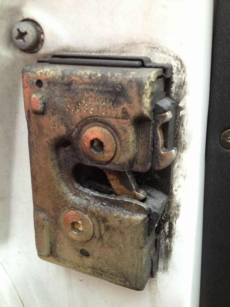

Unlike my Honda which i can adjust the door lock latch adjusting those 2 screws:
How do I adjust the C door so close softer? :shrug:
That's it Wayne. 12a should be on the inside face of the handle. If it's missing, it's also easy to fit and cheap enough.
Oh
There is TWO white plastic bits???
I guess the original one was lost BEFORE i bought the C then...
Actually I'm wrong Wayne. It should be item 13, but that's not very clear on the drawing. Item 12 goes on the inner face of the handle like item 12A.
12 and 12A are black.
Your stricker pin should also have a bit of nylon around it.

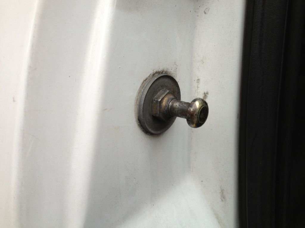

The door pin on the bodywork is adjustable. Simply put a spanner on it, unscrew it a couple of turns and it will slide up, down, in and out. Slide it out slightly, nip it up and try closing the door and you should have a 'softer close'. Keep trying until you get it the way you want it. I'd suggest fitting new pins as there should be a nylon sleeve on the pin. Simply screw the pin completely out and screw the new one in. They are widely available on e-bay for very little money. Check out the example below.

I will play with my current pin then - if no joy, will purchase on ebay- cheers Leon! :thumbleft:

Cheers to both Sean + Leon :clap:
Sorted! :o
Now closes with a more gentler push :thumbleft:
