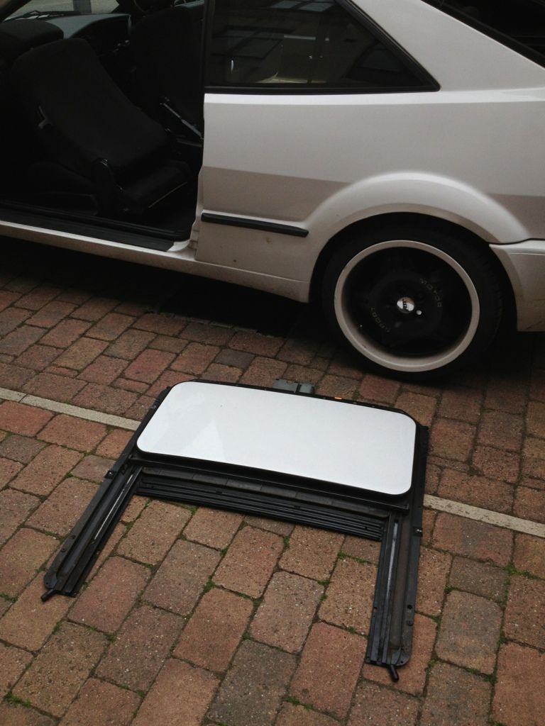

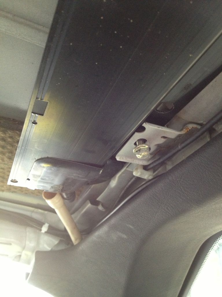

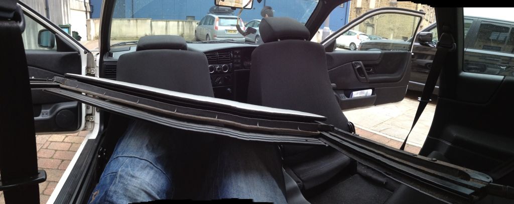

Removing complete sunroof cartridge to track that leak!
BEFORE / AFTER

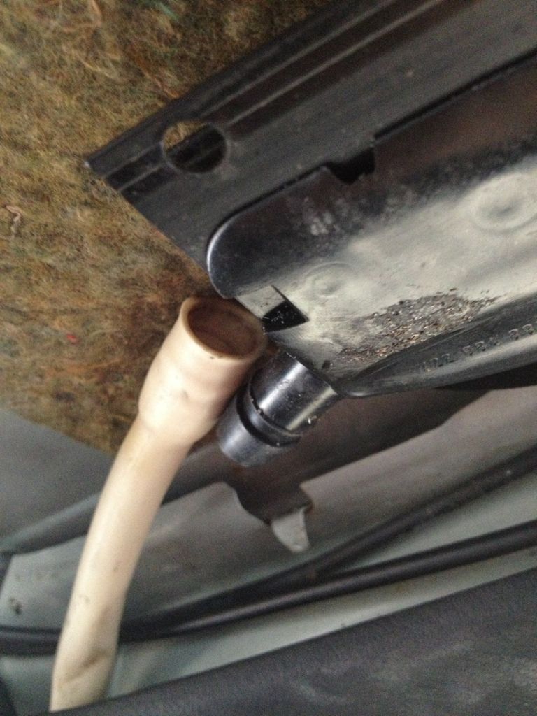

Detach drain tubes (x4)
Remove 10mm bolts (x10)
One man job (me!)

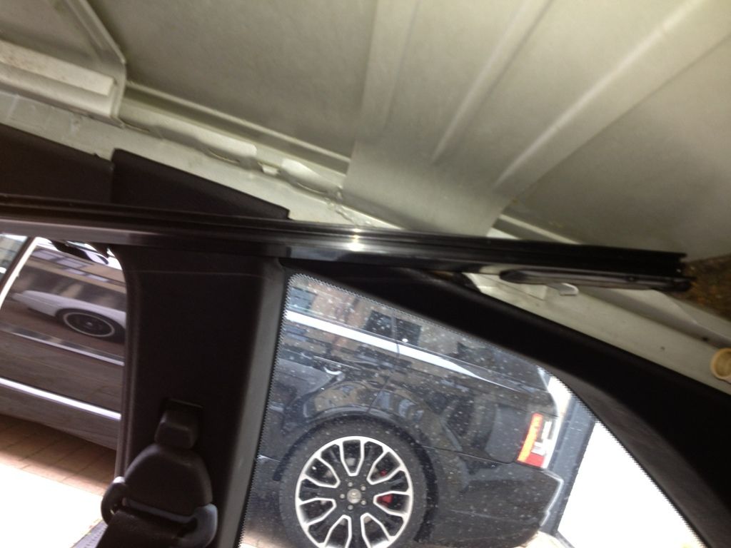

Rear sunroof supported by silver bracket each side
Front USE YOUR HEAD as u unbolt last bolts at front of sunroof!
Angle sunroof towards front
Then some manouerve to get it out of front door

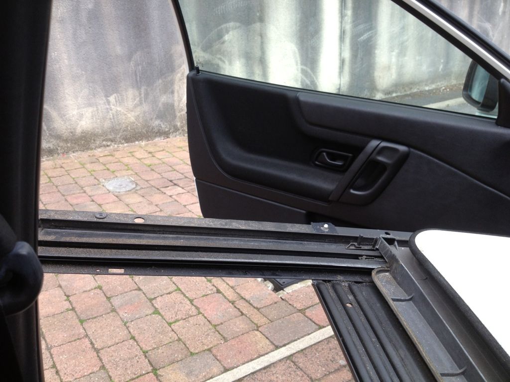

Now
The leaking driver side
NOTHING SEEMS WRONG to me??? :shrug:

Now

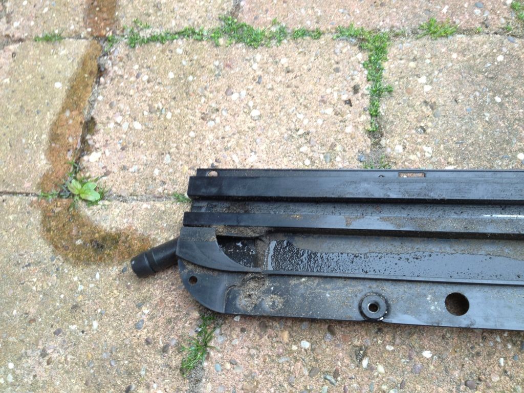

This part came lose from somewhere???? :shrug:
Only one of these - anyone know where it goes???!!!
Bolts bit corroded...so de-rust

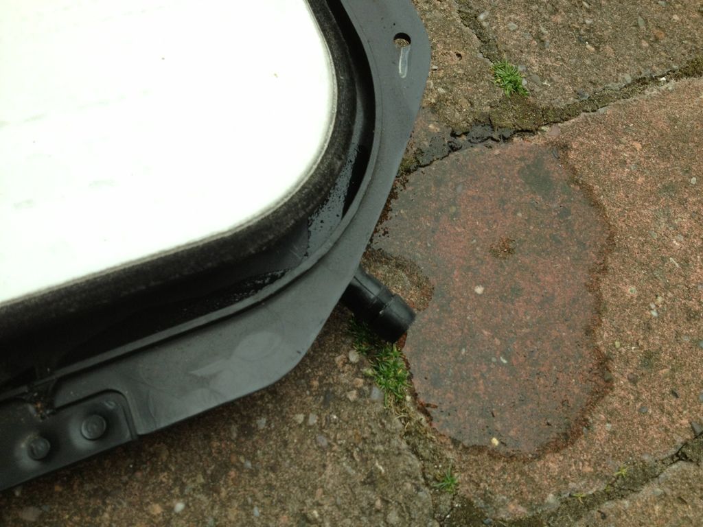

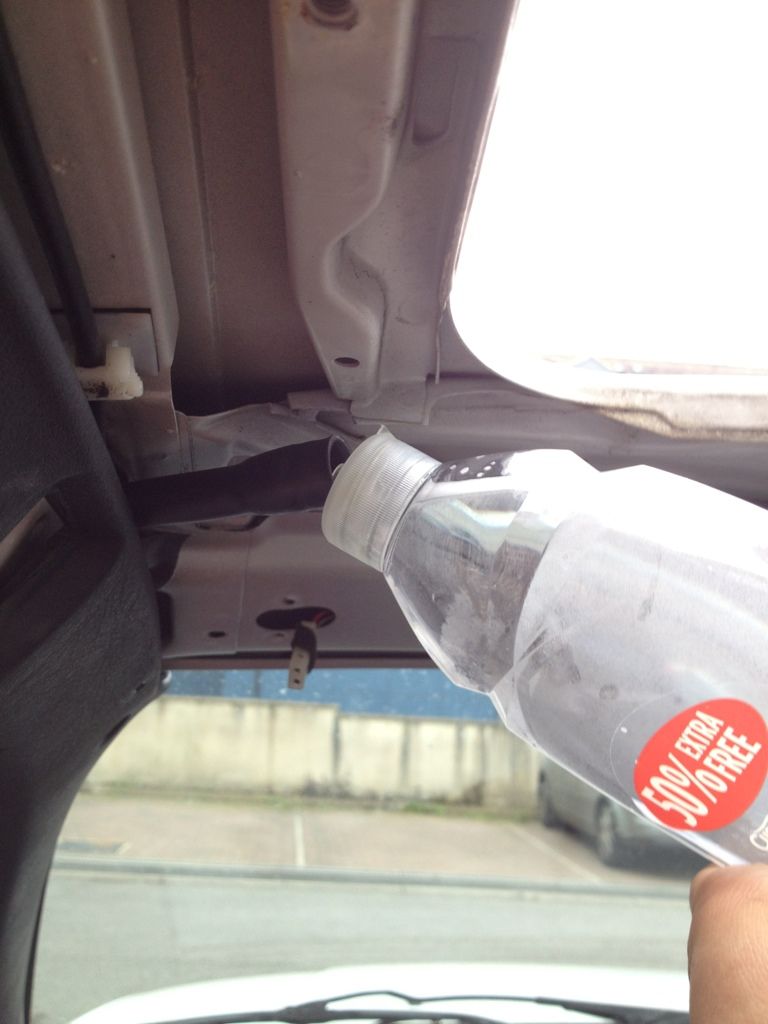

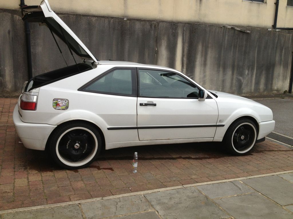

Proof in the pudding my tubes are cleared
Drain channels are fine too!
So there is no blockage
No issues
Nothing to fix???? :shrug:

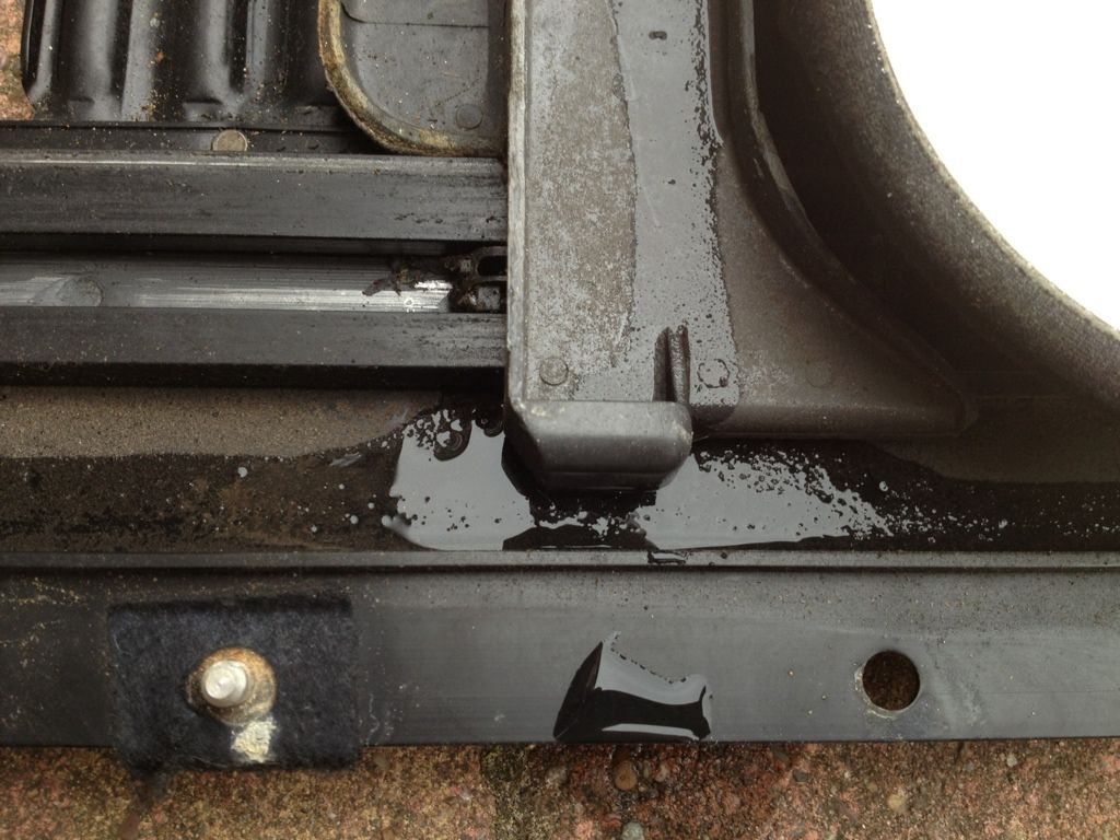

Ref the leak on driver side (onto driver + rear seat)?? !!!!
Could it be this?
Where there is LOTs of rain and it overflows ACROSS the drain channels??? :bonk:

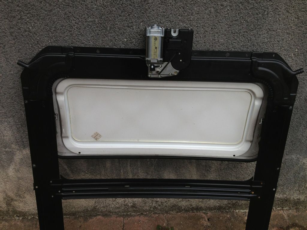

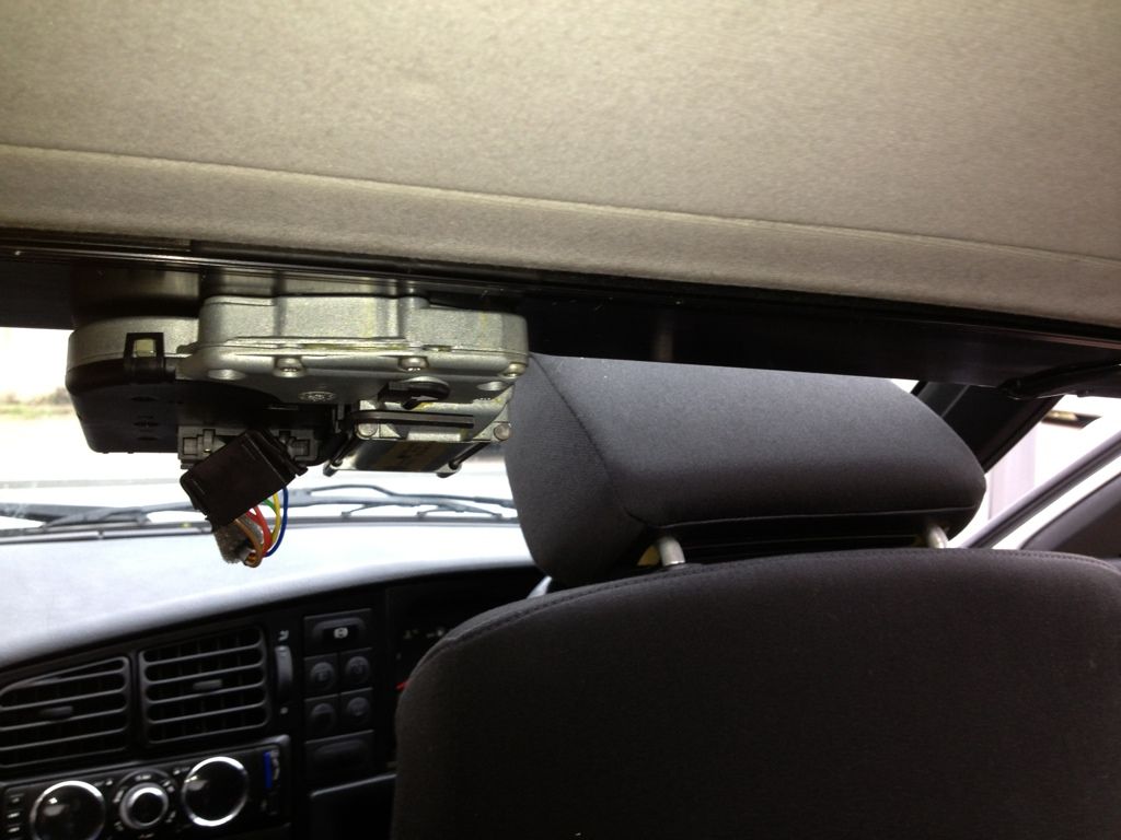

Tilt fully open to remove sunroof panel headliner
Lots of debris on this
I suspect its where it falls onto my steering column and makes it grinding noise when turning :eek:
Opportunity to lube as many bits as possible
NOT that the sunroof works :lol:
Good polish of sunroof panel + surround
Dont think i fix anything (as couldnt find cause of leak) :(
But its done anyway and I learnt how to remove/install sunroof :thumbleft: :o

Wayne you're a proper mechanic now I reckon ;) Maybe just 'servicing' the sunroof will help reduce/stop the leak? That silicon grease is good stuff - very sticky though!!
If you put a lot on then be prepared for it squirting out everywhere! lol

but your brave enough to remove the sunroof ;)
your leak is an odd one! but i think if you get some one with a hose pipe on it whilst your in the car looking for it the leak will become clear, good luck!

If i use a hose pipe it will produce the another leak! :( :shocked!:
It is a bizzare one, as the third leak i understand.
But not the leak from near the drain outlets ??? :bonk: :shrug:
lol dont use the hose full bore on it! just enough so its got a nice steady flow into the center of the sun roof, or point it straight up full bore for rain effect haha
Lol
I use a slow steady hose pipe flow to rinse car (after wash) and it trickled into middle back of sunroof (between sunroof inner headliner and outsr sunroof headliner).
I think the reason is my outside sunroof seal shrunk - so letting more water in than usual.
So that i understand.
But the leak that wets my driver seat and rear seat???
As all drains clear
All drain outlet clear
All drain channels clear
No blockages (as tested when i took sunroof off)
So a funny one :bonk:

LOL, well hopefully you have fixed it without realising!
After several days rain (some heavy and overnight)...
Bizzarely, the sunroof has NOT leaked once?!!! :clap:
No drips
No wet patches
No drops from the sunroof cartridge??? :shrug: :bonk:
TOUCH WOOD whatever was the reason before - its fixed! :thumbleft:
NOT that i fixed anything??? :bonk:
