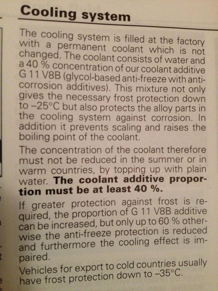

Wayne2015 10 Posted February 11, 2015 Coolant lasts the LIFE of the car. I thought BMW longlife engine oil was long. But for the LIFE of the car? WOW! Quote Share this post Link to post Share on other sites
