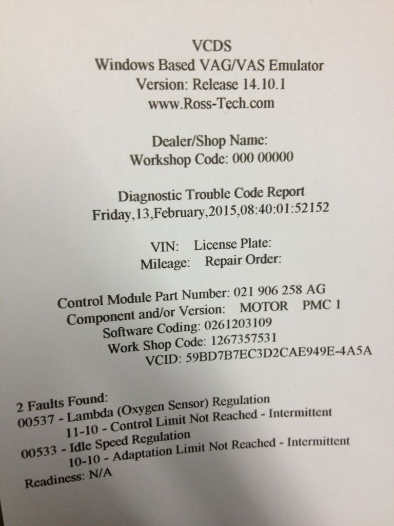

Wayne2015 10 Posted February 13, 2015 Garage today said computer indicate these problems ... Quote Share this post Link to post Share on other sites
Macdaddy 10 Posted February 15, 2015 Have you had chance to test any of the diagnoses to check what's to fault? Quote Share this post Link to post Share on other sites
Wayne2015 10 Posted February 15, 2015 Macdaddy said: Have you had chance to test any of the diagnoses to check what's to fault? Car still with garage until they get the parts coming week Will report back when fixed! :) Quote Share this post Link to post Share on other sites
Macdaddy 10 Posted February 15, 2015 Do you know what they are replacing out of interest? Quote Share this post Link to post Share on other sites
Wayne2015 10 Posted February 15, 2015 Macdaddy said: Do you know what they are replacing out of interest? Just Lambda sensor Idle speed regulator thingy Quote Share this post Link to post Share on other sites
