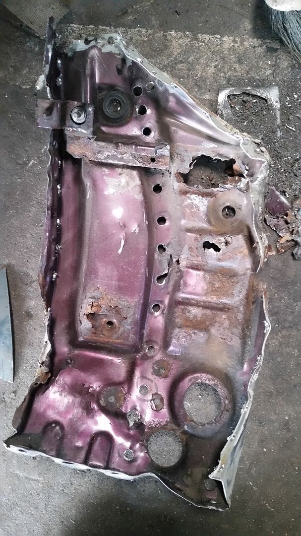

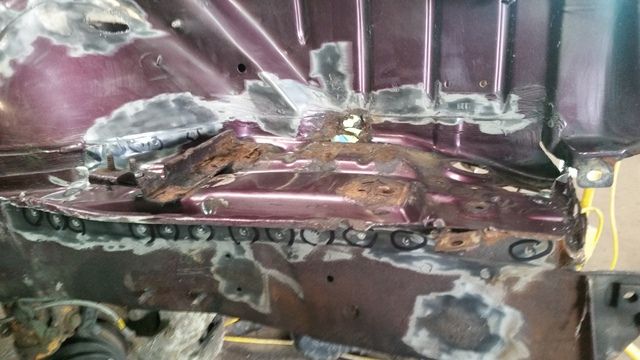

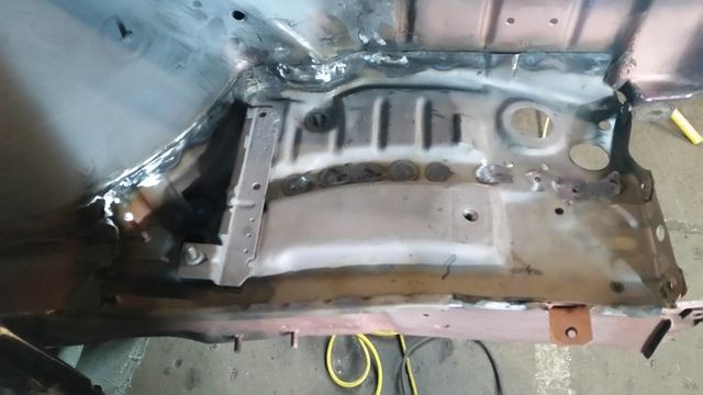

KeVR 10 Posted April 9, 2015 Crust battery tray, worst part of the car: All dressed off now and ready to have the replacement from breakers fitted, Some holiday I'm having, back to work Monday... Quote Share this post Link to post Share on other sites

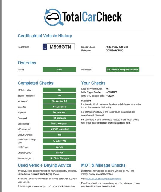

KeVR 10 Posted April 10, 2015 Massive thanks to Tony (thegolfman)for passing this on, something I should have done never did: Also mileage checks out on Vosa history, gonna contact DVLA and get a list of previous keepers to see if I can get some response. Someone somewhere might just be holding on to the history (I did it with a Jetta 16v that the insurance took after it was stolen, years later I was able to pass it on). Quote Share this post Link to post Share on other sites

KeVR 10 Posted April 10, 2015 That would be spot on Tony... Little update though they may slow down, back to work Monday.... Gonna seam sealer it then a couple coats of 2k filler primer prior to paint... No bodge at all, hate the stuff. Quote Share this post Link to post Share on other sites

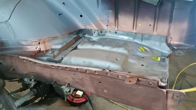

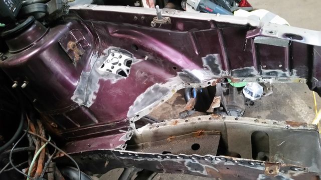

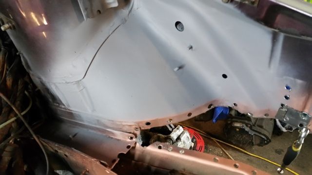

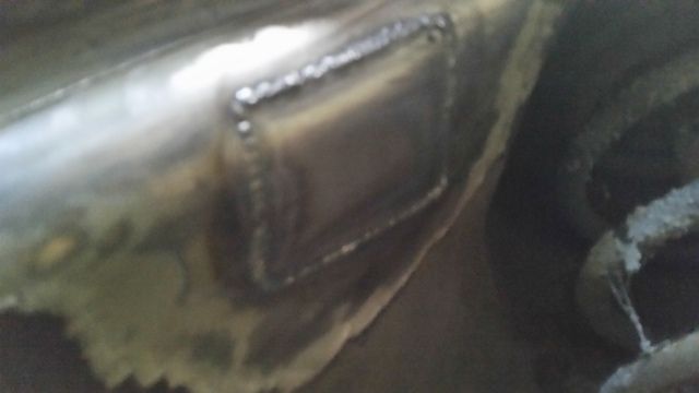

KeVR 10 Posted April 20, 2015 Got a little bit more done last night, work is swallowing my time making it difficult to crack on at the pace I'd like. Excuse the seam sealer but I don't want this one rusting out. [ATTACH=CONFIG]81357[/ATTACH] [ATTACH=CONFIG]81358[/ATTACH] Quote Share this post Link to post Share on other sites

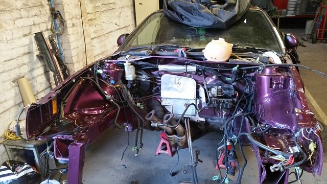

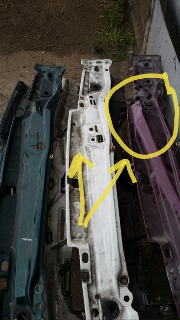

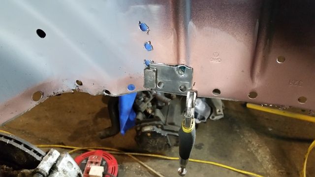

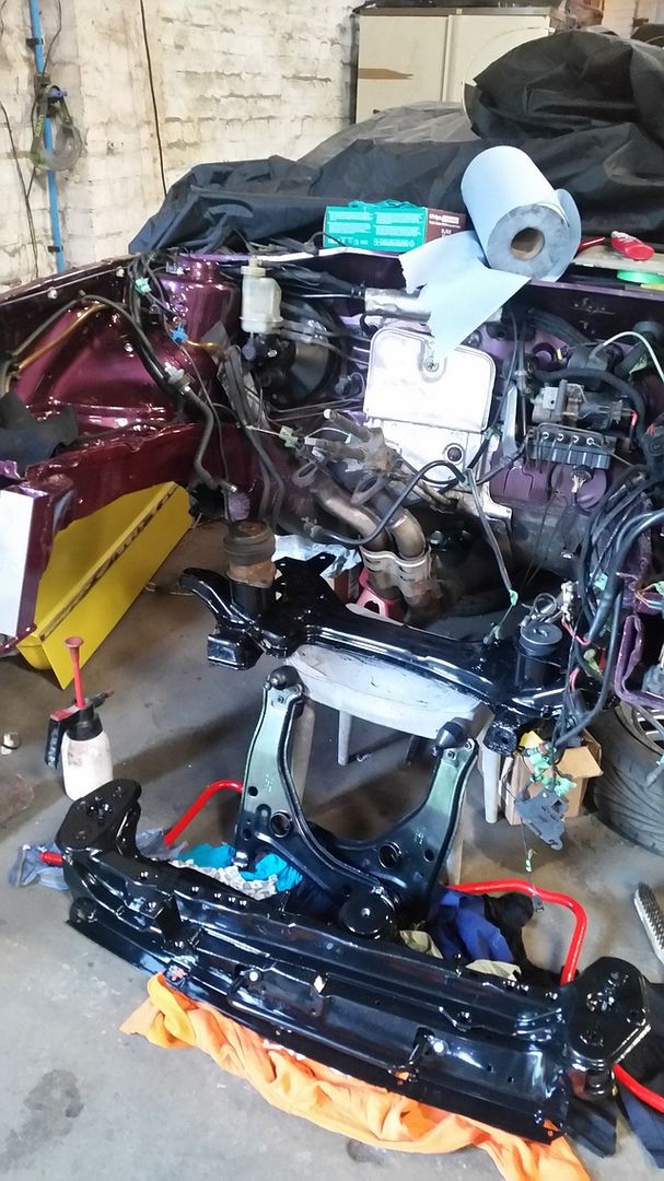

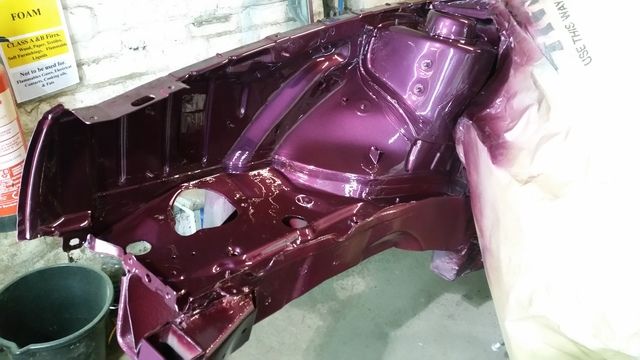

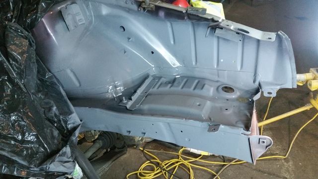

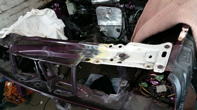

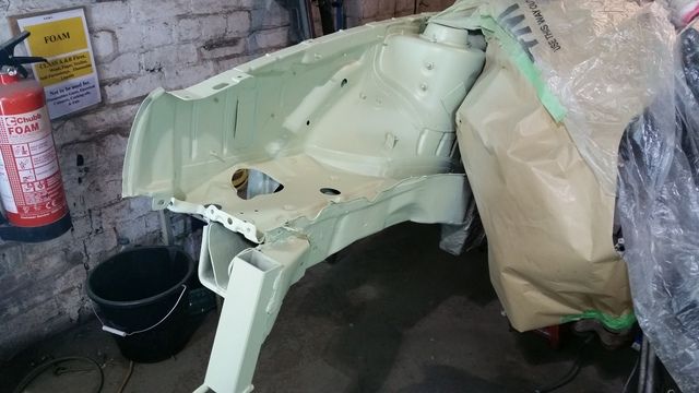

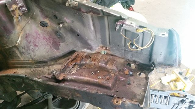

KeVR 10 Posted May 3, 2015 Been busy back at graft so progress slowed down somewhat, not to mention the slush fund starting to dry up lol... Stuff like timing chain kits, clutch kits, new spray guns and other stuff I hadn't planned into my budget is killing me but what the hell. The VR is being built as a keeper so not counting the cost. Anyways some further developments include powder coated running gear, N/S wing all repaired and painted, engine out and stripped, front panel cut n shut to replaced rusty section. Had no idea the VR front panel was different to the late 16v, mine was starting to rot from the inside out (only found when blasting with media) massive shout to Chris who has been pretty much focal in helping me out with advice and parts during my build. Forgot also started replacing all the brake pipes with the OEM quality ones, I must add what a fantastic fit these are. More to come.... Quote Share this post Link to post Share on other sites
