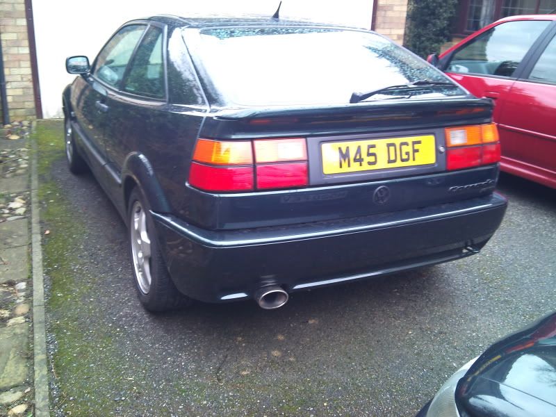

VR6 Lee 0 Posted April 26, 2015 I bought a 2nd hand Magnex exhaust off here, all fitted and sounds great but the exhaust sits way out of the cut out part of the rear bumper, has anyone got any photos of there fitment including the rear hanger as I have a feeling mine is modified Quote Share this post Link to post Share on other sites

dickie 0 Posted April 26, 2015 Mines the same as how the silver one is sitting. Quote Share this post Link to post Share on other sites

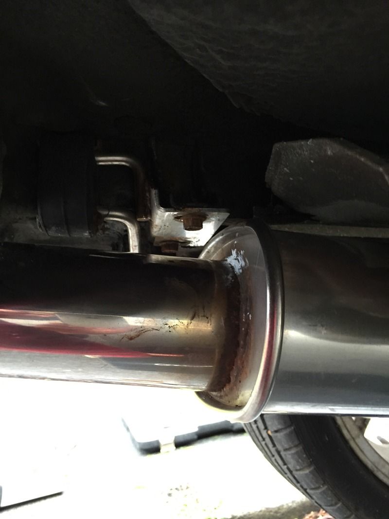

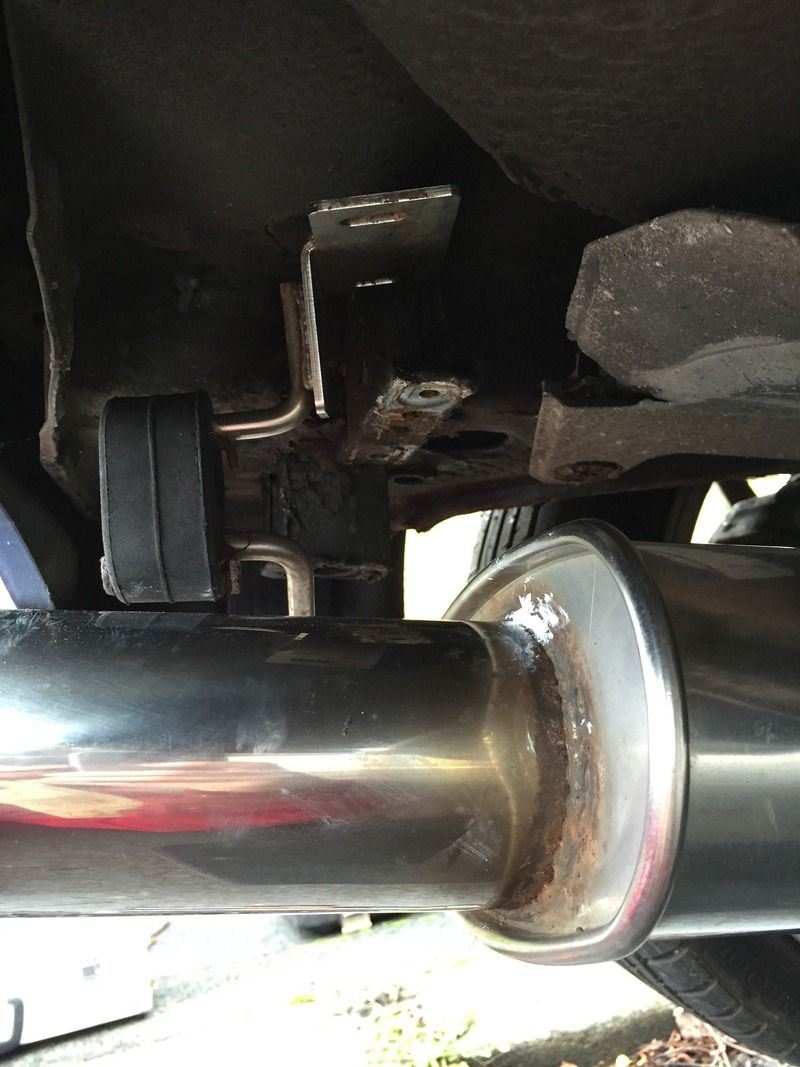

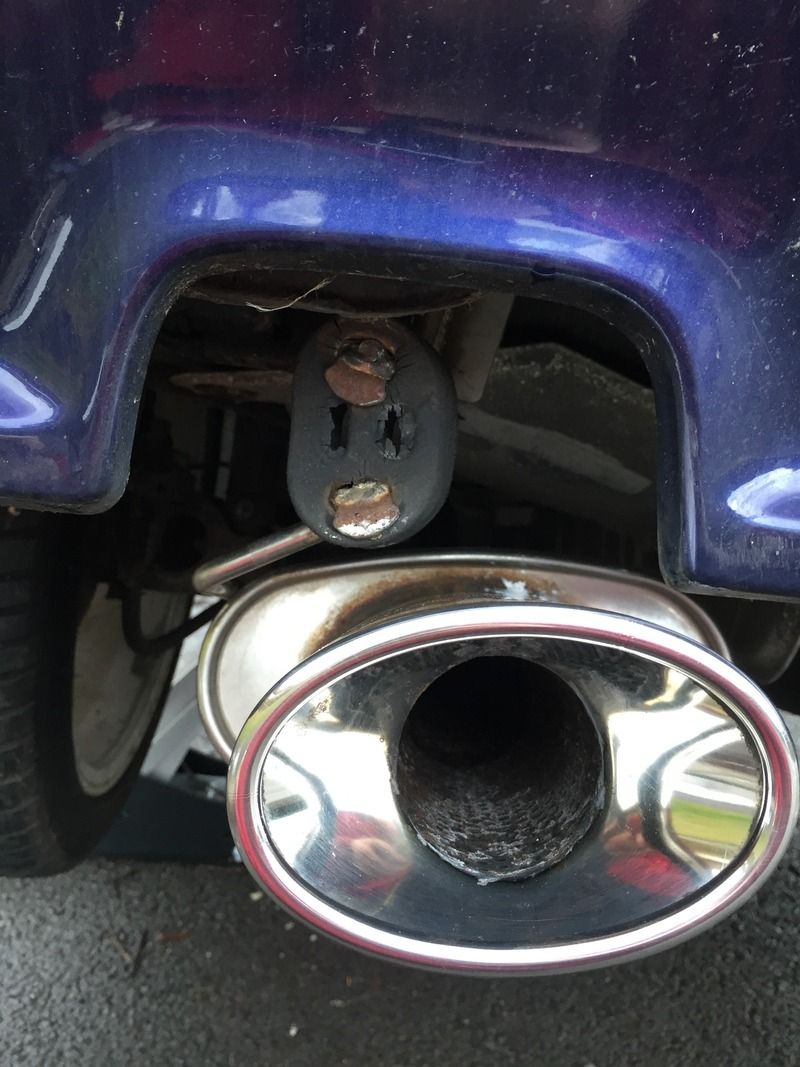

VR6 Lee 0 Posted April 27, 2015 Few pictures Bracket on OEM way round but even though I turn it round the other way it does not really move the exhaust up Quote Share this post Link to post Share on other sites

VR6 Lee 0 Posted April 27, 2015 Thanks Jim. Can you see if you can get a pic of the actual metal bit which comes off the exhaust as I feel that mine has been modified Quote Share this post Link to post Share on other sites
Jim Bowen 1 Posted April 27, 2015 Yeah I noticed yours. Mine points straight out in the same plane as the tailpipe. Quote Share this post Link to post Share on other sites
borachris 0 Posted April 28, 2015 Yours looks like it has had part of the hanger cut off or straightened out, it should be an 'L' shape, like Jim has said though you really need the correct magnex bracket to mount it correctly. A half decent exhaust place should be able to knock up something that'll do the job. Quote Share this post Link to post Share on other sites

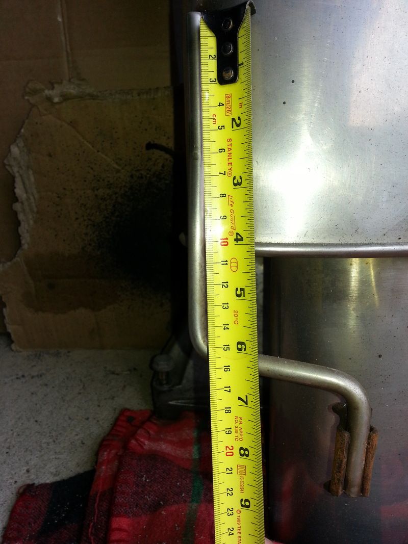

VR6 Lee 0 Posted May 2, 2015 I have mine off the car if pics would help you. Hi Jim, that would be fantastic. Any chance you can measure how long the piece of metal is off the back of the exhaust as well Quote Share this post Link to post Share on other sites

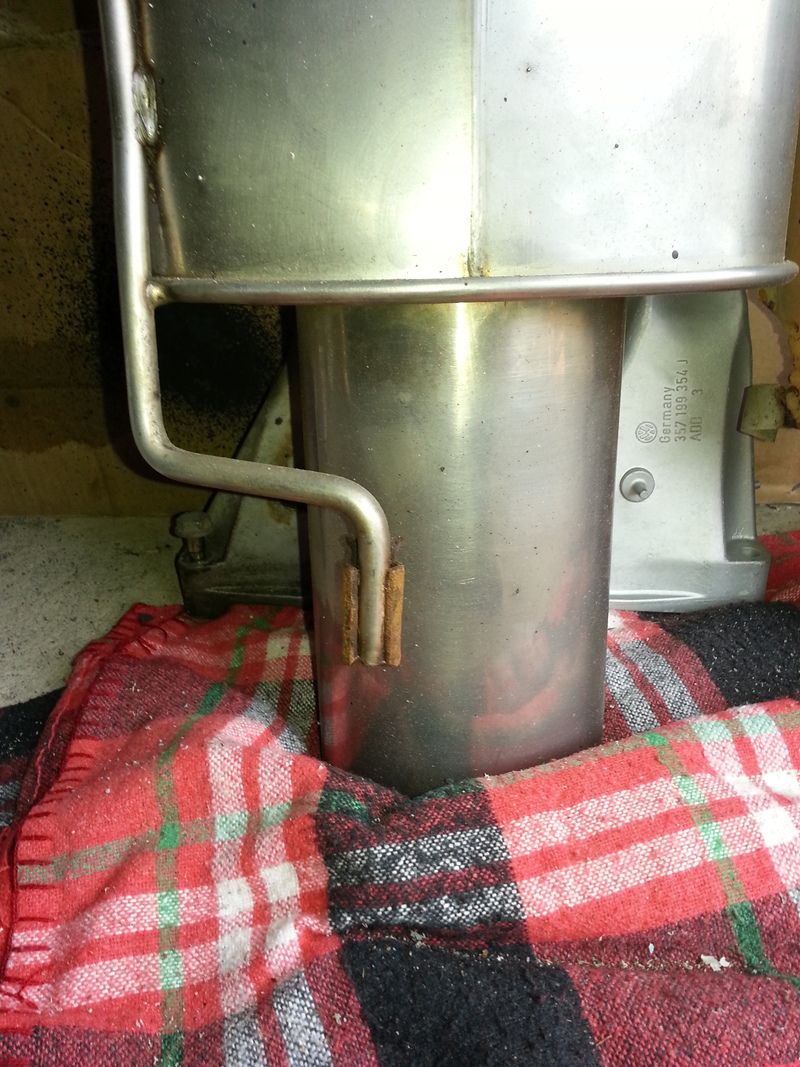

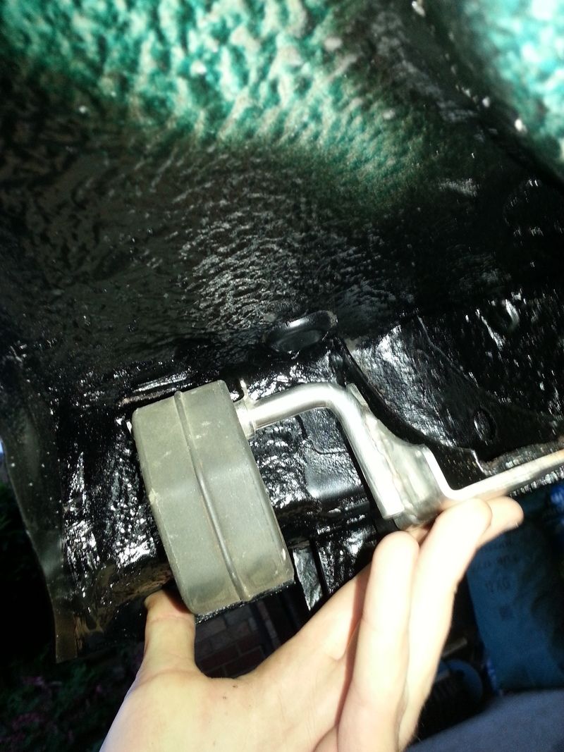

borachris 0 Posted May 2, 2015 Took these before I fitted mine, the magnex supplied bracket is attached in the pics too. Quote Share this post Link to post Share on other sites
borachris 0 Posted May 2, 2015 This is fitted in the correct way And just to give you all a giggle this is how I tried to fit it whilst hungover, took me a good 10 mins to figure out I had the bracket upside down lol Quote Share this post Link to post Share on other sites

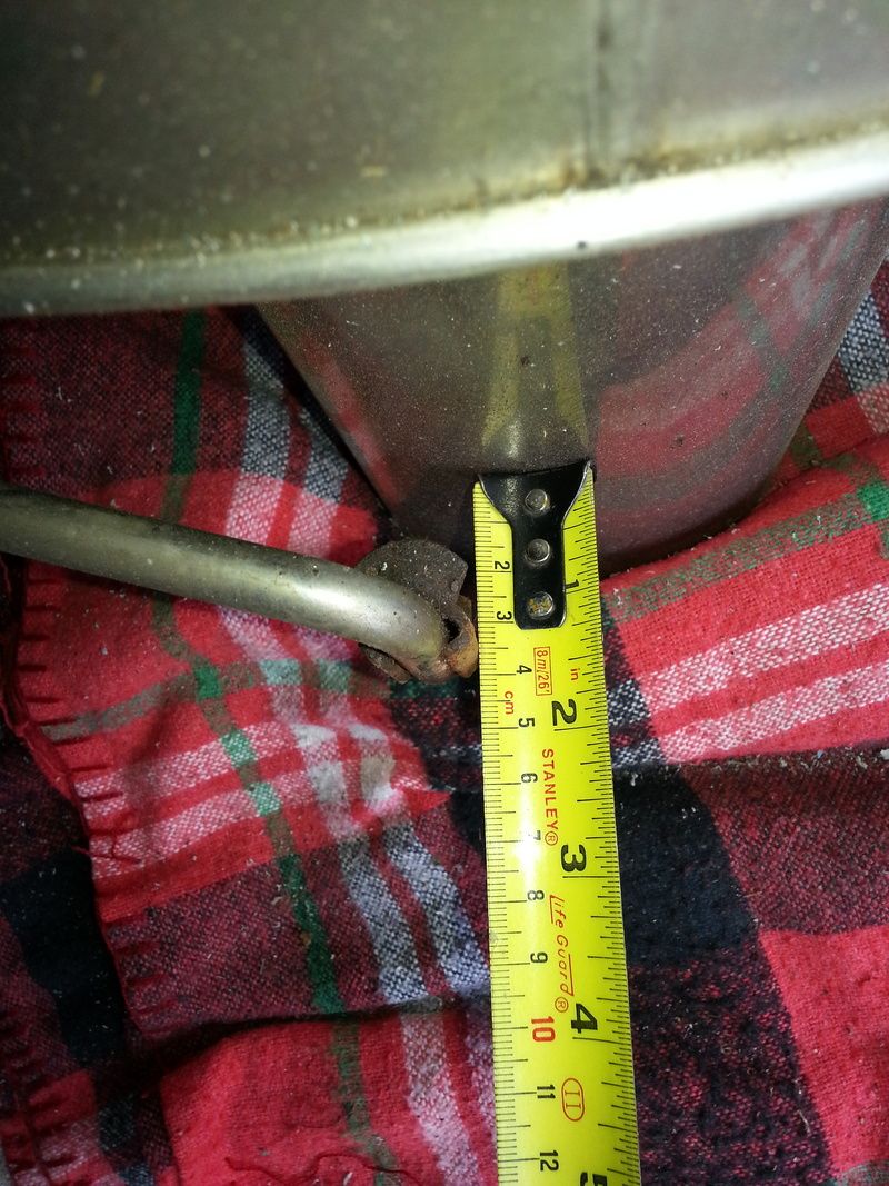

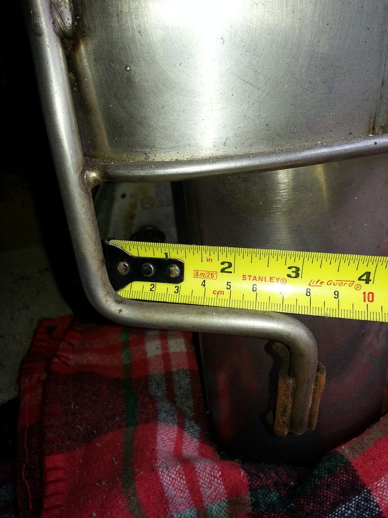

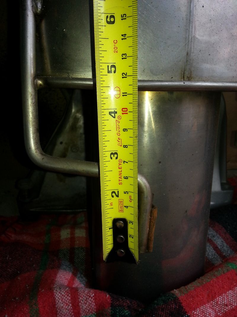

VR6 Lee 0 Posted May 3, 2015 Thanks borachris, what I need is the length of the metal part coming off the exhaust so I can modify mine, any chance? Quote Share this post Link to post Share on other sites
Jim Bowen 1 Posted May 3, 2015 Will get the pics tomorrow for you Quote Share this post Link to post Share on other sites
Jim Bowen 1 Posted May 4, 2015 Here you go... Quote Share this post Link to post Share on other sites
VR6 Lee 0 Posted May 14, 2015 Thanks Jim you are a star! What the little thing where the hanger sits, on the end can bit Quote Share this post Link to post Share on other sites
Jim Bowen 1 Posted May 14, 2015 Is just a little bit of metal that pushes into the rubber hanger bit. Came with that. Think it's on all the hanger connections. Quote Share this post Link to post Share on other sites
