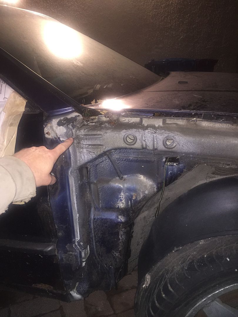

easypops 8 Posted October 24, 2015 Possibly, where the wing meets the body at the bottom corner of the windscreen there is usually a bit there......I found it easiest to heat the outer wing with a heat gun(not a blowtorch) to soften the sealant ......I'll go and take a picture of the area I mean Quote Share this post Link to post Share on other sites
easypops 8 Posted October 24, 2015 This area is where it usually sticks, although you might be unlucky and have more. Also if you look below where I'm pointing you'll see the inner arch bolt hole Quote Share this post Link to post Share on other sites
