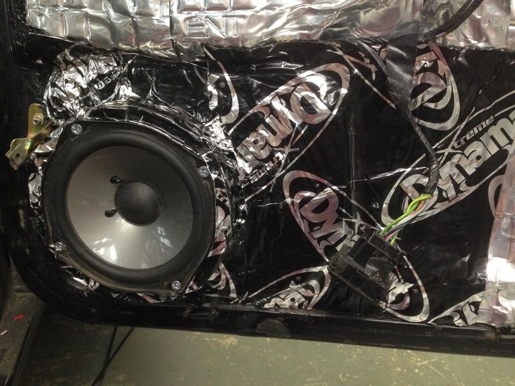

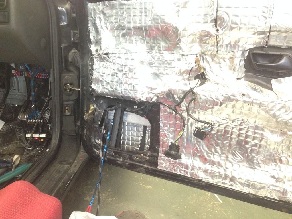

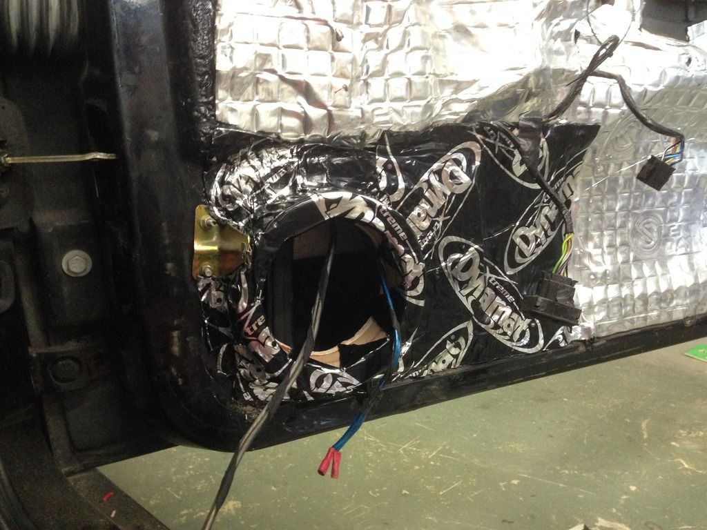

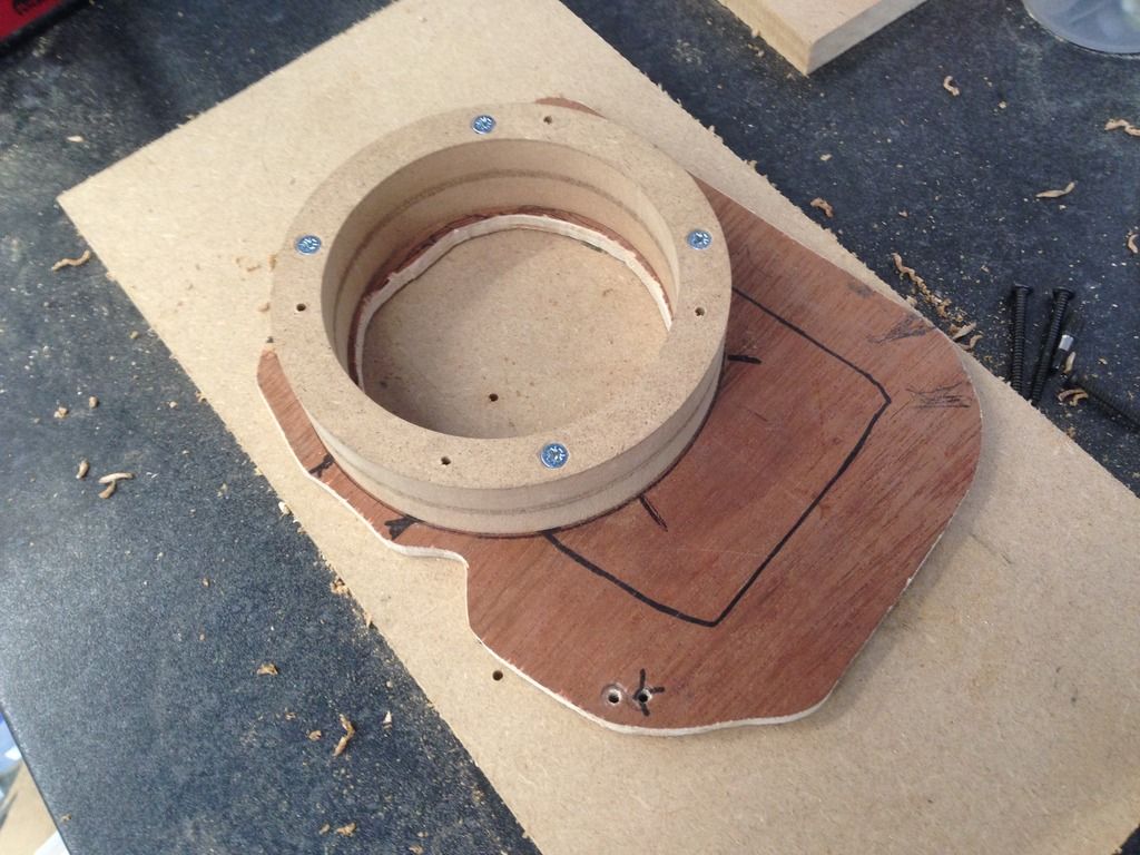

EJ Taylor 22 Posted June 2, 2016 get some mdf rings and a bit of plywood and make some door buld to imo, i whipped mine up in an hour or so, so easy, and door card goes straight back over the top no problem, having speaking floating in the door cards destroys any chance of them every being able to sound good, regardless of what speakers they are. ill find some pics. Quote Share this post Link to post Share on other sites

EJ Taylor 22 Posted June 2, 2016 Silent Coat, sound proofing, got bloomin tones of the stuff on each door, now im going down the speed route i may have to peel it off though i recon. we shall see Quote Share this post Link to post Share on other sites
g0ldf1ng3r 17 Posted June 2, 2016 EJ Taylor said: Silent Coat, sound proofing, got bloomin tones of the stuff on each door, now im going down the speed route i may have to peel it off though i recon. we shall see ahh i see i thought it was something different as i knew you had used a lot of dynamat for soundproofing. it looks like it is stuck well to the doors in lots of places, does it have a sticky back or did you use the black horrible putty stuff? Quote Share this post Link to post Share on other sites
EJ Taylor 22 Posted June 2, 2016 Yer it's self adhesive bro. Sticks well!!! Sent from my iPhone using Tapatalk Quote Share this post Link to post Share on other sites
