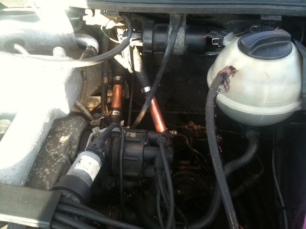

Remove the bypass valves and just plumb the pipework directly to through to the bulkhead using copper pipe like below.
You should then be able to tell if its the matrix or the bypass valves that are faulty. More likely bypass valves, but if your matrix is old then the additional pressure on it by removing them may cause it to pop. Worth replacing it if you can as I'm not sure the bypass valves are still available. If you can get them then you may be ok.
I couldnt source replacements and havnt had any problems in the 15 years ive had them removed/bypassed....
Its bound to pop next time i start it after saying that.....lol
