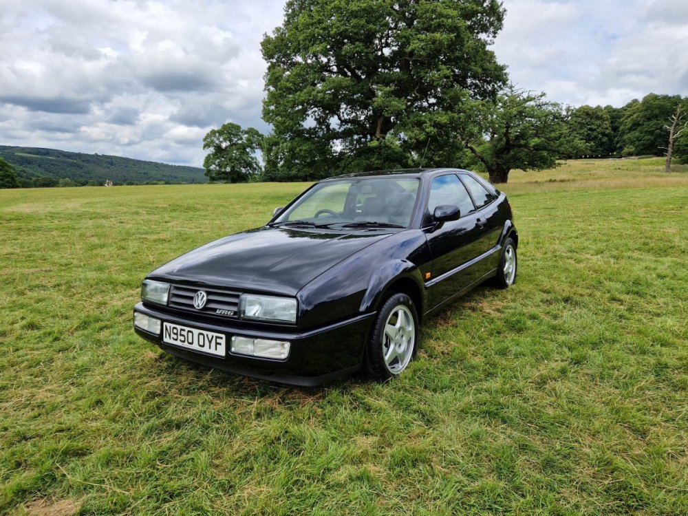

ChrisL 20 Posted July 24, 2024 Thanks for that. some pics from the the national day Quote Share this post Link to post Share on other sites
Cressa 44 Posted July 25, 2024 Looks great. Must have been nice to get out for the drive on a lovely day. I was going to go to this, but work got in the way unfortunately Quote Share this post Link to post Share on other sites

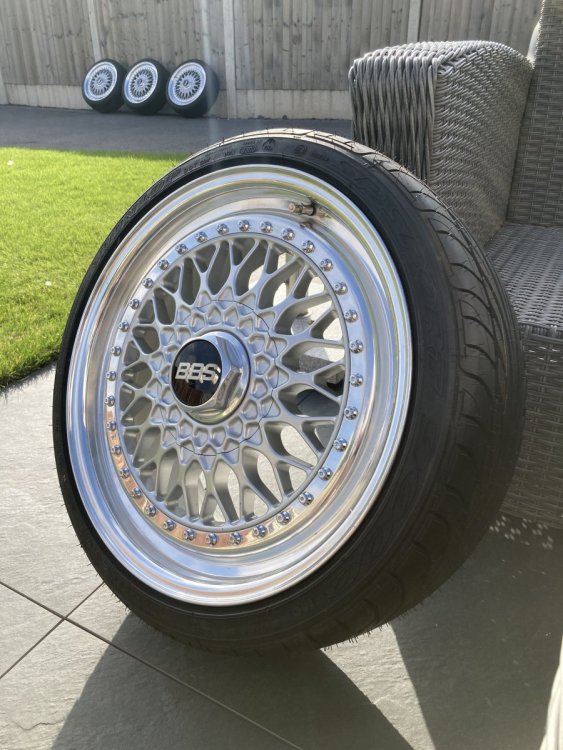

ChrisL 20 Posted August 31, 2024 Well, a set of RS301’s became available so looks like the corrado won’t be standard for too long. 1 Quote Share this post Link to post Share on other sites
_Matt_ 32 Posted September 1, 2024 Chris they will be epic on your corrado. You can easily put it back to standard when the need arises but you can't easily get your hands on a set of those and for 99% of people some tasteful mods such as these would never detract from your efforts. Hell I'd love a set (anyone reading please point me in the right direction!!).Sent from my SM-G990B2 using Tapatalk Quote Share this post Link to post Share on other sites

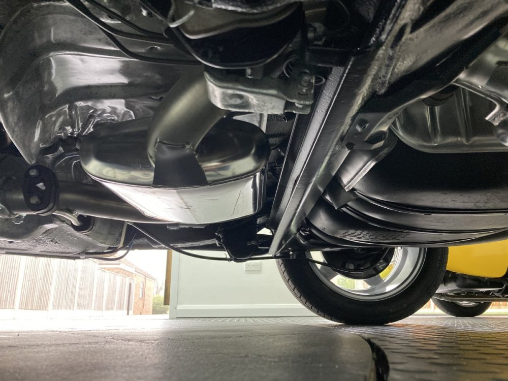

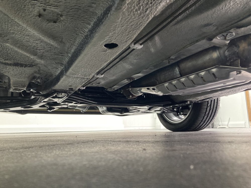

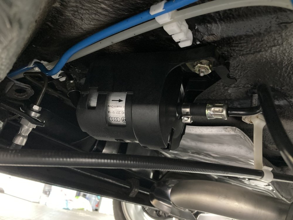

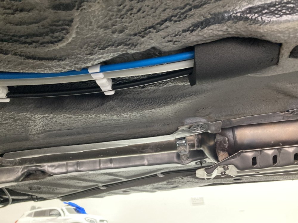

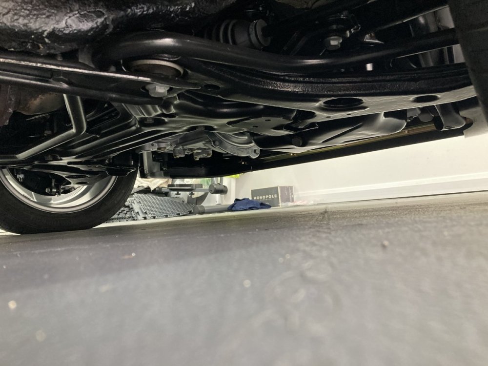

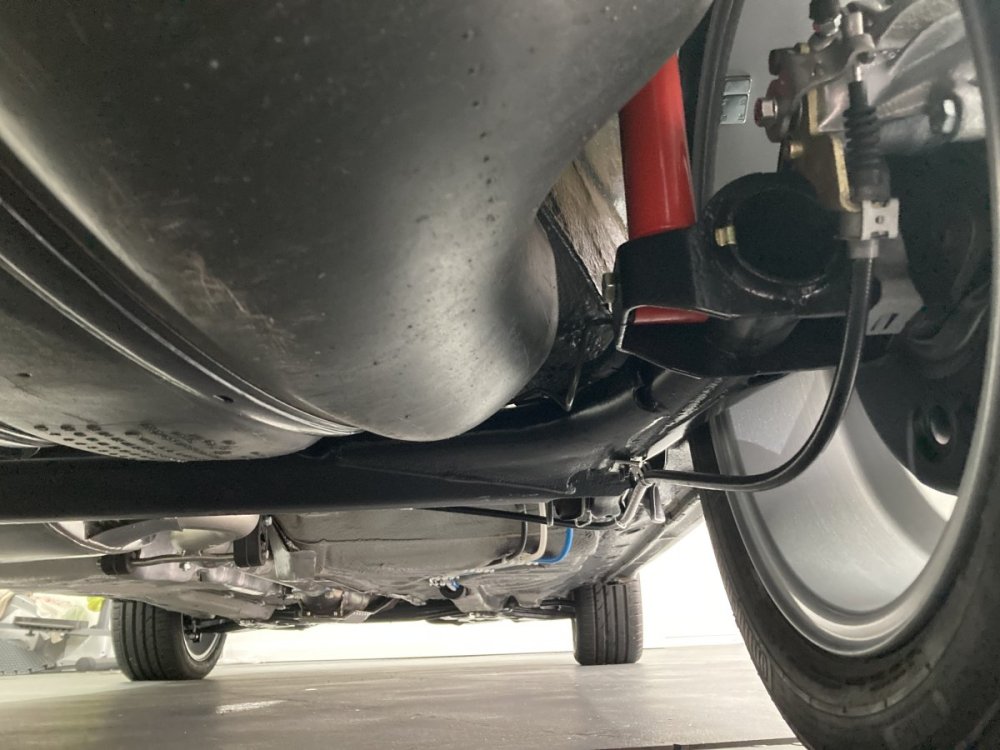

ChrisL 20 Posted December 17, 2024 Not added much to this lately but here’s some summary pics of underneath 1 Quote Share this post Link to post Share on other sites
_Matt_ 32 Posted December 19, 2024 That is a beauty! Merry Christmas to you as well :) Mines is clean but not a patch on yours. It is better than that auction car though for sure! Quote Share this post Link to post Share on other sites
Cressa 44 Posted December 25, 2024 That car is a thing of beauty 😍 Quote Share this post Link to post Share on other sites
