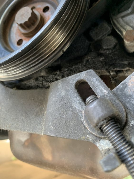

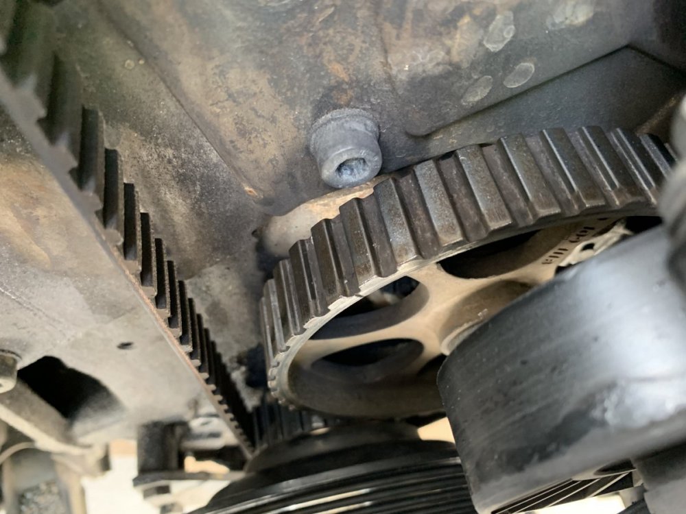

Popeye775 16 Posted June 13, 2020 On 6/11/2020 at 7:04 PM, Dox said: Sounds like its jumped teeth, retime and check again Update sir, I set the timing to TDC and checked all of the gears. To which I found the intermediate shaft and the crank pulley timing marks no longer in line with each other. I have uploaded photos showing what I mean. In order to fix this, do I just need to rotate the crank pulley to line up with the arrow on the timing belt cover, and then rotate the intermediate shaft to line up with the mark on the crank pulley? Quote Share this post Link to post Share on other sites
Cressa 45 Posted June 13, 2020 I suppose that answers your compression and crap starting. Do you have the Bentley Manual? Quote Share this post Link to post Share on other sites
Popeye775 16 Posted June 13, 2020 On 6/13/2020 at 6:45 PM, Cressa said: I suppose that answers your compression and crap starting. Do you have the Bentley Manual?Yes I do. I just cracked it open to find how to align the pulleysSent from my iPhone using Tapatalk Quote Share this post Link to post Share on other sites
