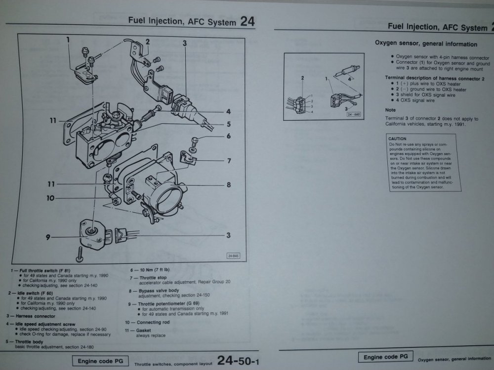

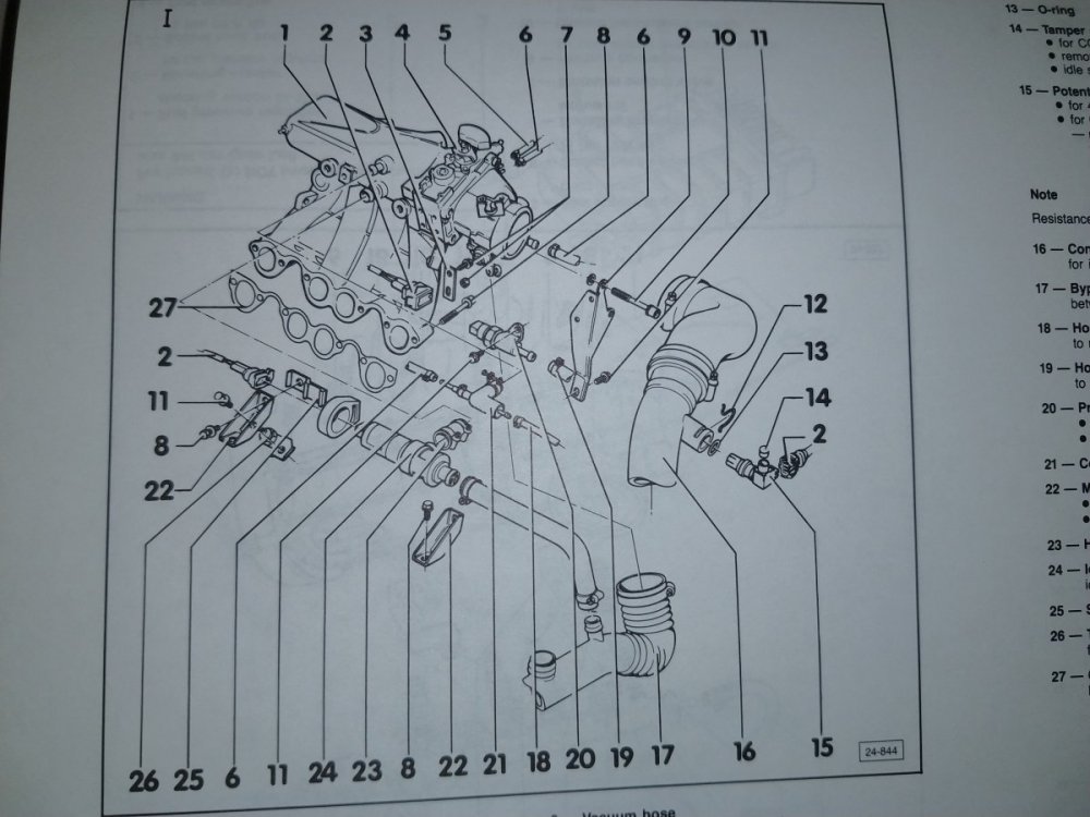

Reading through your above post and watching your uploaded video, I'm inclined to think it's possibly wiring/electrical issue/s, firstly you unplugged the blue coolant temperature sensor in your video, then you also mentioned when you unplug your lambda sensor (O2 sensor) it idles a lot better, and doesn't fluctuate at all or not as much. I think unplugging those two sensors will increase the fuel mixture, as the ECU can't read the signals from those sensors when they're unplugged. For the engine to fluctuate yes it can be an air leak, but I've never seen an engine fluctuate that much and up to 5000rpm, there's got to be something else that the ECU doesn't like or can't see when it's making it's fuel to air ratio calculations. Or as POPEYE775 has mentioned could possibly be a vacuum/breather issue, but it would have to be quite bad to effect the engine like this ?

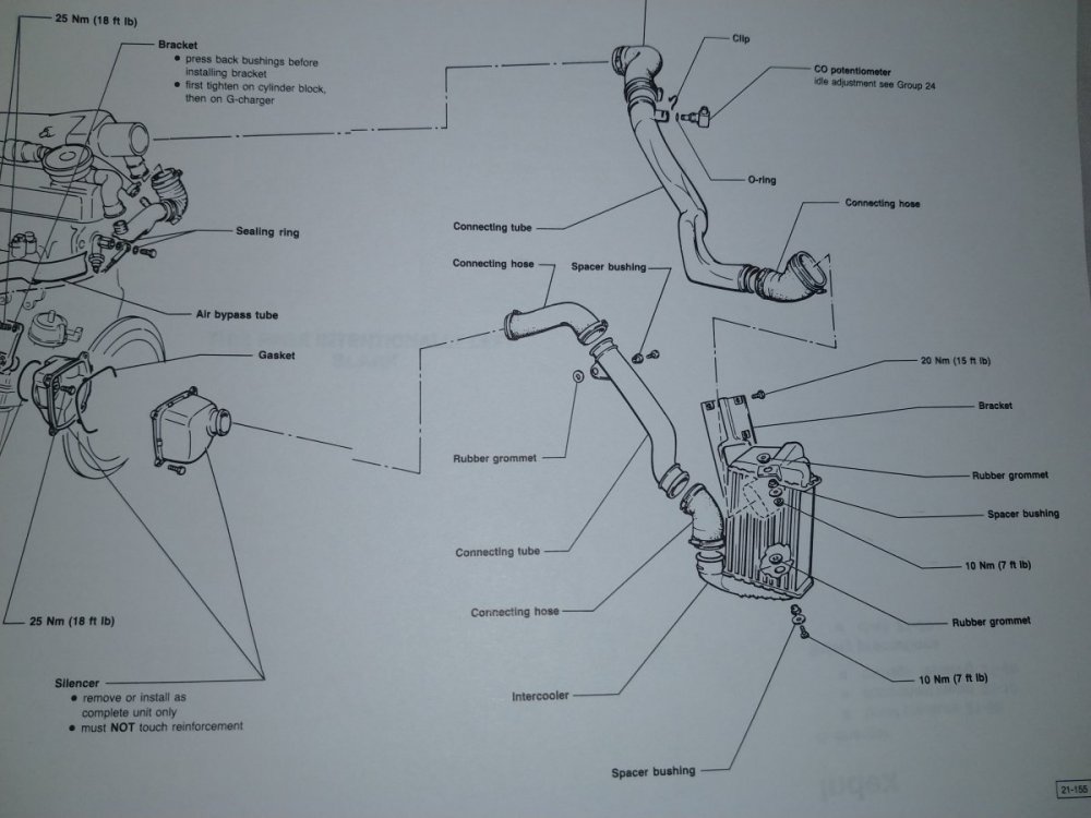

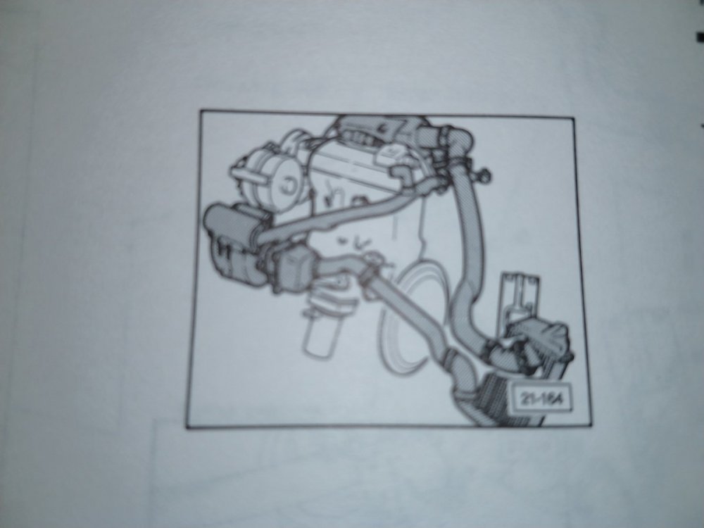

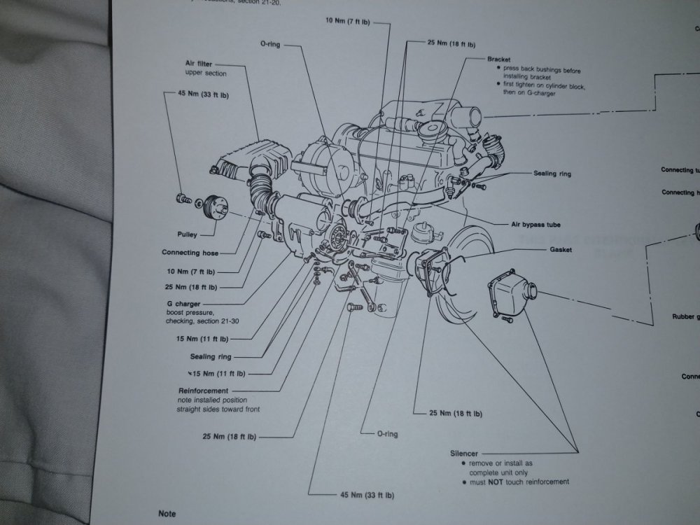

Looking in the Bentley manual at the G60 engine, it's showing a large crank case breather, going from the bottom of throttle flange, then small hose comes off to valve cover, then main breather pipe goes to supercharger. I can see in your video it's connected ok to valve cover and throttle flange, but can't see the back of supercharger. In the manual it mentions when carrying out a boost pressure system leak check, you have to disconnect the crank case breather recirculation pipe, I presume to aid getting an accurate reading when testing. What I'm saying is this breather recirculation pipe is it all rooted correctly to supercharger.

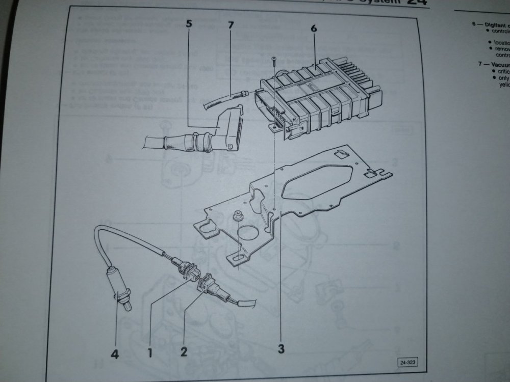

3) none standard ECU was fitted before but has since been changed back to standard OEM, I think this ECU has to measure the vacuum to help calculate correct idle of engine. In the Bentley manual it states this vacuum hose to ECU must be bang on correct as 100cm (1 meter) long, no more / no less, states highly critical.
