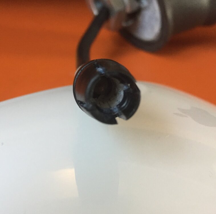

I'm trying to source a new aerial as the one I have is buckled after I had the roof bars on and some timber press down on it πŸ™.
Thing is, I'm struggling to get a replacement. The one fitted currently, has a female fitting on the aerial, and all the ones I see on ebay are the other way round.
Anyone out there been in the same situation and have a solution and/or know where to obtain a new unit ?
Here's the one I have:

I don't have any idea about a direct replacement sorry James, but its just 50ohm Coaxial cable so easily snipped off and remade via a connecting piece in the worst case.
I vaguely remember there being a guide on here on how to bypass the amplifier within the aerial, which is usually the cause for poor/no reception. Surprisingly, bypassing it actually provides a better signal apparently. πŸ˜³
Yeah, cheers I did that years ago. Soldered in a jumper cable between the aerial mast and the coax (VW in their infinite wisdom supplanted the amplified circuitry inside a piece of water permiable foam, which is why the reception is shocking at best) This is more of a wholesale replacement. But thanks for the heads up.
