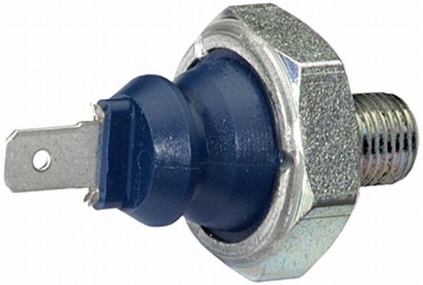

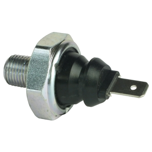

Stone0311 0 Posted May 30, 2022 Morning, If anyone can provide some direction on Oil pressure sensors for a G60 it would be much appreciated, Ekta, Bentley and the original parts I have all seem different - query relates to the one on the RH of the head where the charger takeoff is and the one on the top of the oil filter housing I have 068 919 081 and 056 919 081C but not sure which way around they were when removed: 068 919 081 marked 0.15-0.45bar (black) 056 919 081C marked 1.4 +/-0.2 bar (black) Bentley shows Head - 0.3bar (brown) Oil Filter - 1.4bar (black) Etka Head 028 919 081 H oil pressure switch 0,25BAR M10X1 (blue) Oil filter: 2 056 919 081 oil pressure switch 1,8BAR M10X1 (white) (2) 068 919 081 D oil pressure switch 1,4BAR M10X1 (black) (2) 068 919 081 C oil pressure switch 0,9BAR M10X1 (grey) Thanks Quote Share this post Link to post Share on other sites
Crasher 4 Posted May 30, 2022 The head switch was 056 919 081 C and brown, it changed number to 028 919 081 D and then again to 028 919 081 H is now blue It is a 0.25 Bar pressure to open circuit and the wire is blue/black 068 919 081 is black 1.4Bar and is now 068 919 081 D, this goes into the oil filter bracket. This is a 1.4 bar pressure to close switch. It always confused me why the PG engine had a 1.4 Bar switch for the dynamic warning system when all others had a white 1.8 Bar and the VW wiring diagram even says it is 1.8 Bar, the wire is yellow. Quote Share this post Link to post Share on other sites
