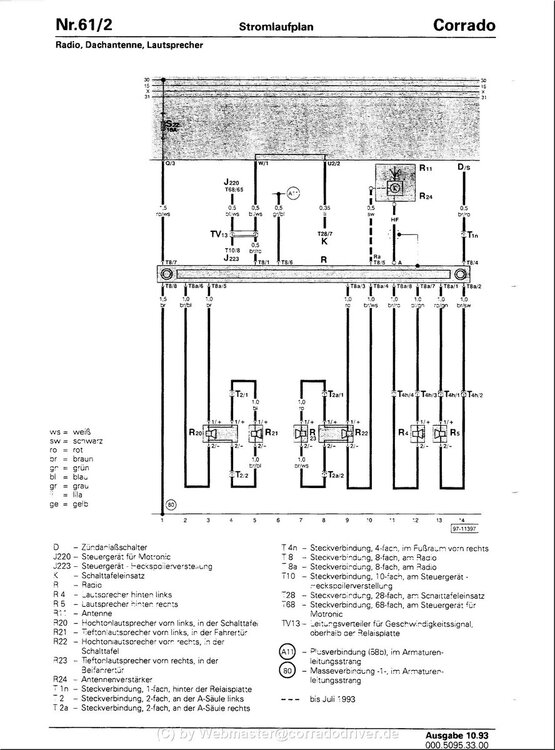

Below are the pin-outs on a standard VW Gamma IV, and then the pdf is the wiring plan for the same radio and gives the wire colours.
stromlaufplan_gamma4.pdf
