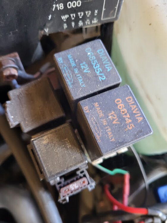

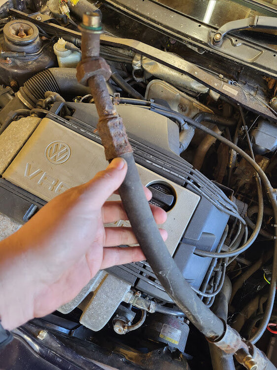

These are the bits I have immediately seen in the engine bay that i think relate to the air con. Couldn't get a pic of the condenser.
That pipe in my hand I assume goes from condenser to dryer
that pipe goes to the compressor across the front of the engine,  Its quite a messy retrofit to be honest, i think the LHD cars were much tidier.  The inlet duct also has a motorised flap, which you can see in your picture under the foliage cover - incidentally when the cooling fans come on the flap closes.
Yes those are the relays, there should be a loose fitting plastic 'box' that sits on top of them.

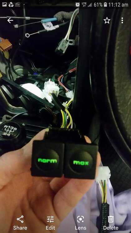

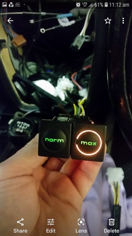

This is the mk3 golf switch. Illuminates as it should with lights on and when in use. Not dug out the paperwork yet for the wiring. I did find there were 2 different switches and only one worked correctly!

I didn't have anywhere to fit the mk3 switch, so I moved the ABS switch over to a blank on the right hand side of the steering wheel. Needed to be a smaller one but easily extended the wires. Perhaps a lot of hassle but I like an electrical challenge.

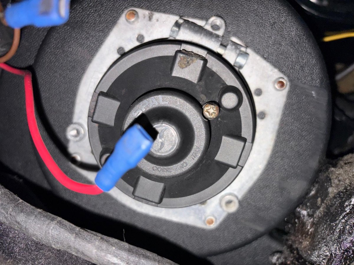

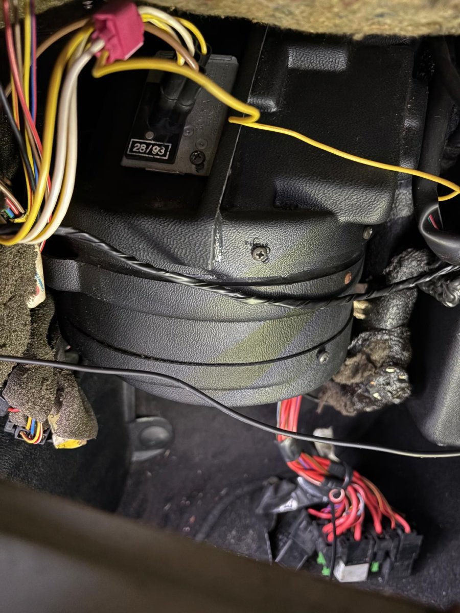

Related issue, i have AC on my RHD corrado VR6, also prob Davia,  now the blower has stopped working, pain to get out and no part number to replace, some pics attached any idea where i may pick up a replacement ? you can see a strange set up and custom blower ... My AC does not work a the mo, think it just needs a service,all parts are in place ..  my switches are on the RHS of steering wheel
