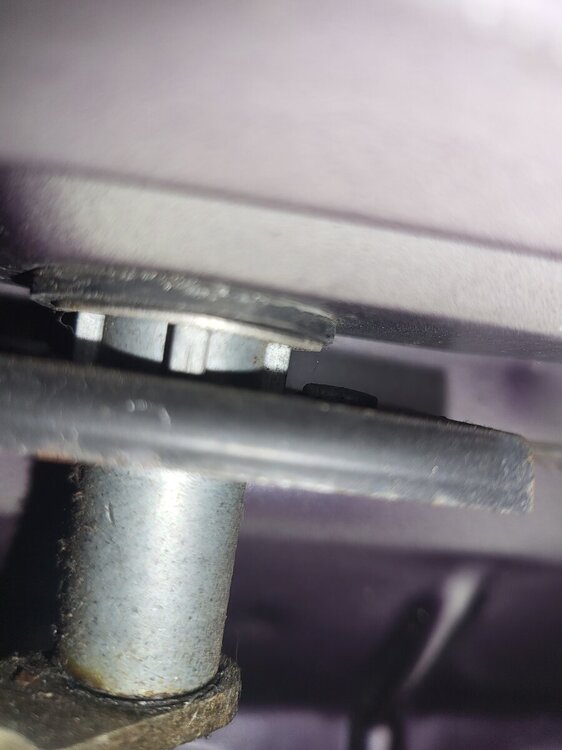

Hi all - just looking for some help and maybe pictures if possible - I'm in the middle of refubing my front wiper linkage, and forgot to make note of how the washers and spacers mount on the spindle as they go through the bulkhead.
So I have:
- a large metal washer
- a black plastic cup spacer
- a large nut
So the nut obviously is the last part to go on, but a bit confused as to the spacer and the other washer - guessing that the spacer sits with the flat part up on the spindle, this mates up to the bulkhead, and then the washer and nut on the other side? Many thanks.

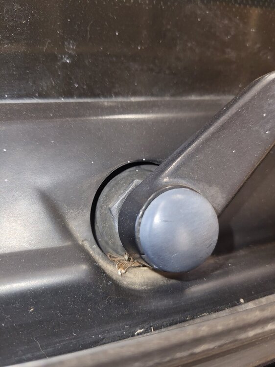

Thanks for that - so it looks like the steel washer sits on the four shoulders of the spindle, then the plastic spacer, flat side to the washer and the lock nut on the outside. Will give that a go. Many thanks  for the photos.
Edited by fendervg
Correction - there is also a rubber grommet that sits on the hole in the bulkhead - so the metal washer goes on the spindle, then the spindle is inserted from below through the grommet, then the spacer, sits around the spindle but in the grommet from the outside, flat side out, then the lock nut. You can see it in the second picture, the flat part the same colour as the lock but is the flat side of the spacer.
