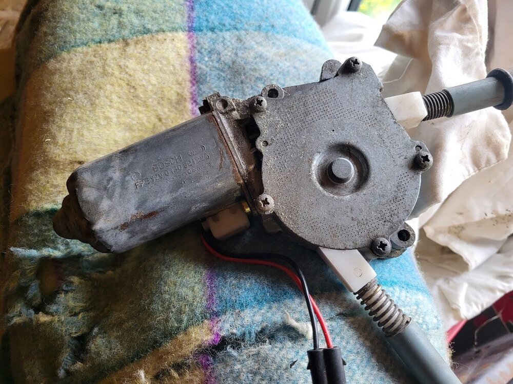

Andrew Booth 0 Posted July 4, 2023 Hoping from some help from this super-helpful community. I have read every thread on here and cannot find a definitive answer to these two questions: 1. Can you replace JUST the motor on the window regulator mechanisms (I know @fla stripped his motor down and removing it is easy - just two star/torx screws - so I cannot see why I couldn't just put a different motor back on there having removed the old (broken) one ...... but there are plenty of posts on here which say "you can't replace the motor - only the whole regulator" so I'm just checking my logic here. 2. Supposing you can replace just the motor, can you replace it with the regulator in situ? This one seems like a tall order .... My driver side motor is goosed but my regulator works ok (and the plastic stoppers are still ok, miraculously). I have sourced a different motor which works fine (attached to a broken regulator!) so my dream solution here is to leave the existing, working regulator in place (saving my knuckles and the plastic stoppers which always seem to break when people remove these) and just swap the motor. Anyone done this? Thanks in advance. Quote Share this post Link to post Share on other sites
_Matt_ 32 Posted July 4, 2023 Hi Andrew, I am not sure on answers but have a regulator handy here for pics so thought i'd share. I've never replaced before but did have a stuck passenger window. A few taps of the motor with a hammer whilst cycling up and down the button got it free'd up and it's been as good as gold since. Quote Share this post Link to post Share on other sites

fendervg 33 Posted July 4, 2023 The "hit it with a mallet" method can buy you several more years - using the windows often will also help stop them from seizing. We'll try anything to save us from doing this jjob - both beacuse it's a right pig, and because working replacements are so hard to source. The motor is part of the cable assembly, so it can't really be detached, especially when it's in the door They are also not (and have never been) available separately, although you can get aftermarket versions that have a separate motor. These were intended as an upgrade for cars without electric windows. Any time it is ever mentioned, the whole assembly needs to be replaced, although you could in theory open it up once off the car and refurbish the innards. In any case, you will need Inspector Gadget arms..... Quote Share this post Link to post Share on other sites

fla 9 Posted July 5, 2023 It really is a horrible job! On the face of it its very straightforward, but its just tye way the whole regulator is fitted, which means removal and refitting is a nightmare Quote Share this post Link to post Share on other sites
