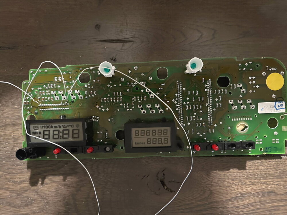

Redfox 10 Posted August 14, 2023 Right, I took the instrument cluster (ICT) out and apart. All connections for the multipin connector and the many for the MFA extra pcb, have been cleaned, de-rusted and resoldered. One of the two transistors under a copperspring, have broken leg. Soldered for now as a test, but both will have to be changed. They have their legs best too sharp at 90°, and it shouldn't be that, but a curve. The caps and the voltage regulator (also a transistor) is fine. ICT now reassembled and ready for going back into the car, but it's way too late and dark, so next time in sunny weather. I'll report back on findings afterwards. Kind regards, Redfox. Quote Share this post Link to post Share on other sites
Redfox 10 Posted August 15, 2023 Went to the Corrado this morning and reinstalled the ICT. No changes. There is one small observation though. When I start the car and give a little gas, the rev counter needle will make a small jump or movement. Hmmm... I don't know what to do next, apart from taking the whole ICT apart again and begin measuring every single component from a-z. That's some hours of work. I will probably take another look at the wires in the car as well. Any ideas are most wellcome. Kind regards, Redfox. Quote Share this post Link to post Share on other sites

Redfox 10 Posted August 17, 2023 An update: The main pcb on the instrumentation is now out again. Ground points and main ground points are measured and are fine and with correspondance between them. Pin 1, 3 and 5. So is main +, terminal 31 and 15. The 3'rd + is not used now, as it's only instrument lighting. The main transistor, called "voltage regulator" by VW, is measured to give 10,00 Volt exactly. As it should be within 9,50 Volt and 10,50 Volt, I'd say it's fine. And the voltage is completely stable, with no fluctuations. So 3 wires are soldered on to the two main +'s and the main ground mentioned in the above. That would be pin 11, 13 and 3 respectively. As I understand it, terminal 31 is the main + and terminal 15 is main + via ignition switch. Then the wires are connected to a laboratory power supply, at 12,000 Volt and 65mA max power usage. No turning on. Then voltage is raised to 12,500 Volt and consumption limit is raised to 200mA. Then the board powers on, and with same faults as if it was in the car, as described earlier. Upon pressing slightly on a specific area of the small extra pcb that is soldered on the the main pcb, lines in the two LCD's change to strange lines, and LED's for coolant and oil turns on ireglularly. Okay. Voltage is raised on the power supply to 13,2 Volt and the same happens. Irregularly that is. I'd say the chips MAY be okay, and that it MAY point to a trace or a component unstable or dead. See attatched picture for specific area under suspicion, at tip of cotton swab. No more test for today, but further investigation and testing of traces, components etc. is due asap. Question: Does anyone have a diagram of the instrumentation pcb, in any of it's forms from Corrado, Passat or similar? It would make it more easy to looks for errors. Kind regards, Redfox. Quote Share this post Link to post Share on other sites
Dox 26 Posted August 18, 2023 (edited) The 30+ year old capacitors would be on my radar as they fail with age - check for signs of expansion? You could try and desolder them to see if features return (before replacing them?) - note the orientation before removal +/-. The voltage regulator is mainly for fuel and temperature gauges, if you didn't have it the readings would differ engine off / engine running due to higher alternator voltage. Road speed is calculated by the final drive in the gearbox, RPMs from the hall sensors in the distributer (so neither affected by voltage surge). Edited August 18, 2023 by Dox Quote Share this post Link to post Share on other sites

Redfox 10 Posted August 19, 2023 Thanks guys! My friend and I am about to measure every single component on the pcb, check every single soldering pad and trace on the pcb, starting with the small pcb for the MFA. I am also more convinced that this is where the problems lie. But as the two oil and coolant LED's are sometimes provoked to light up, by also pressing on a suspect area of the smaller pcb, it could be somewhere there. Or again on pads and traced that it connects to on the bigger pcb, though all solderings for the small pcb have been cleaned up and resoldered, incl. using flux. By now, most solderings on the big main pcb have been redone. On to the smaller one. Question: Does anyone know if the instrument cluster have some sort of startup routine that it has to pass, before showing normal condition? While I know this is not normally seen, it could be such a thing that it cannot pass because of say a bad resistor or capacitor, so a voltage is not correct for a given circuit? Also: does anyone have a diagram of the instrument cluster pcb? Or a description? I''ll report back on the findings (or lack thereof). Kind regards, Redfox Quote Share this post Link to post Share on other sites

Redfox 10 Posted August 19, 2023 (edited) We've been measuring some of the main pcb and some of the secondary smaller one. - we have resoldered all input connector legs, all legs on the main pcb for the secondary smaller pcb, all legs on top of the smaller pcb, plus a variety elsewhere. After that, we have found the following: - We found that all grounds so far are good. - we found that both power supplies from the input connector are good. We did not look at the 3'rd one, as it's for lighting. - we found that the "voltage regulator" as VW calls it, the transistor, is good at 10,000 Volt. Should be between 9,5 and 10,5 Volt. - we found that there are two more transistors fastened with a sort of double copper spring. One NPN, one PNP. - we found that one leg on the NPN was broken, sitting at 90°, soldered that. It's been replaced before. - we found that measuring the NPN transistor without power attached to the main pcb, from a lab supply, it was fully working. - we found that the very same NPN transistor is unable to operate as it should, because there's +15 Volt, +2,0 Volt and +2,0 Volt. That is too little. 2,0 Volt is probably not used, so something is bad. These 2 Volt is not enough to operate the transistor, so it doesn't function. AS far as I know, no matter the voltage as such, there should be a difference of 0,7 Volt on a transistor. I've ordered a new NPN from Mouser. - we found that the 2 traced having 2 Volt, goes to the smaller secondary pcb, around the area where upon pressing a bit, there's led lighting and strange LCD behavior. Irregularly. - we found that the PNM works fine, and there's 12 Volt, +5 and a little less (I am not sure, as I don't remember by now). --- This leaves us with something to work with. I'd like to know if anyone knows anything about those 2 Volt??? Or does anyone know what voltage to expect at those two legs on the NPN transistor? Kind regards, Redfox Edited August 19, 2023 by Redfox Quote Share this post Link to post Share on other sites
Redfox 10 Posted August 29, 2023 (edited) An update: - The NPN transistor that had a faulty leg has been changed. - The power supplies (rails coming from the input connector is all good. - Some power rails further down the pcb seems to be dead - meaning that they can be traced back to the daughter pcb (the small one) and as a consequence does not power up, until other functions are at play. Therefore there are voltages with around 2 Volt, that are inactive. Or dead, and we didn't find any faults yet... - Most components we have been able to reached are tested and works as intended for value etc. - No shorting out anywhere. - All the solderings on the daughter board (the small one) have been reevaluated, and resoldered, also the hard to reach side. - I need a schematic for the instrumentation! Desperately. I will pay anyone who may have it, a nice sum of money via paypal, if I can have a copy. Mine is a 1991 Corrado G60 (chassis series ...ZMK...), German car originally, km/h, 55L fuel tank, 6200 rpm. Made by VDO, not Motometer. And with the blue adaptor on the back. Kind regards, Redfox. Edited August 29, 2023 by Redfox Quote Share this post Link to post Share on other sites
Redfox 10 Posted September 7, 2023 Update on the G60 instrumentation: We've now been over every single component and soldering on the whole main pcb + all the components it's possible to reach on the small secondary pcb - no errors. But the same failures. So we concluded, that it's a chip error that is unfortunately non-repairable. I went to VW today and asked for a new instrumentation - nope. nothing, nil. Zero. Not even at VW classis parts. To me at least it's so strange that VW is not proud of their cars, but instead neglecting them largely. So, I bought another instrumentation from abroad, and since there's no warranty and no 100% compatibility, I can only hope it will work. Meanwhile at the garage, I decided to take out the whole dash and the HVAC system and change the heat exchanger, since I drive with the original one and it's 32 years old. That proved to be fun, of course. I noticed that the ventilation flaps inside the HVAC are covered in foam and it-- rots. So rinsed it off and new foam on. then the new heat exchanger didn't fit, as the upper pressed metal frame is 2mm too wide. Oh well, modified that and it now fits perfectly. Glued on new seals and gaskets, and the HVAC is ready to go back into the Corrado tomorrow after work. Kind regards, Redfox. Quote Share this post Link to post Share on other sites
