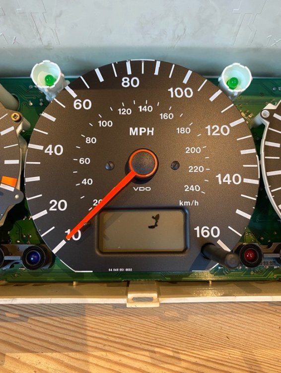

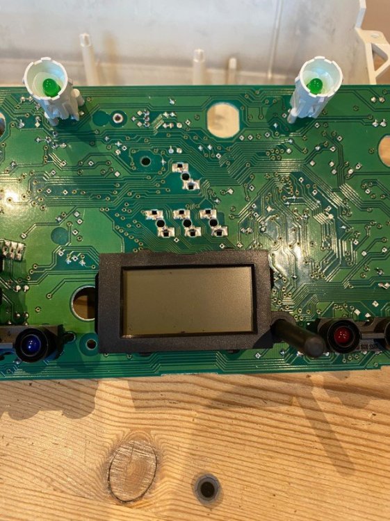

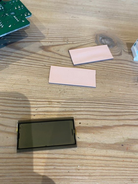

mnmv12 2 Posted February 14, 2024 Out of the blue the odometer lcd decided to bleed which although not disastrous was annoying and cut right through the mileage display making it difficult to read. Lcd is easy to remove and I was able to remove the bleed simply by pressing hard on the display with my thumb and working it towards the perimeter of the display. Took about 30mins and was a success, the remaining tiny specs disappeared on their own , fixed about 3 weeks ago and it hasn't come back so fingers crossed. Still not sure what caused it. Quote Share this post Link to post Share on other sites
