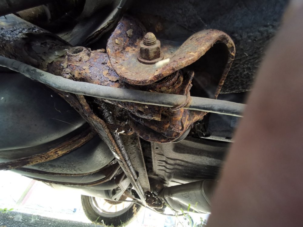

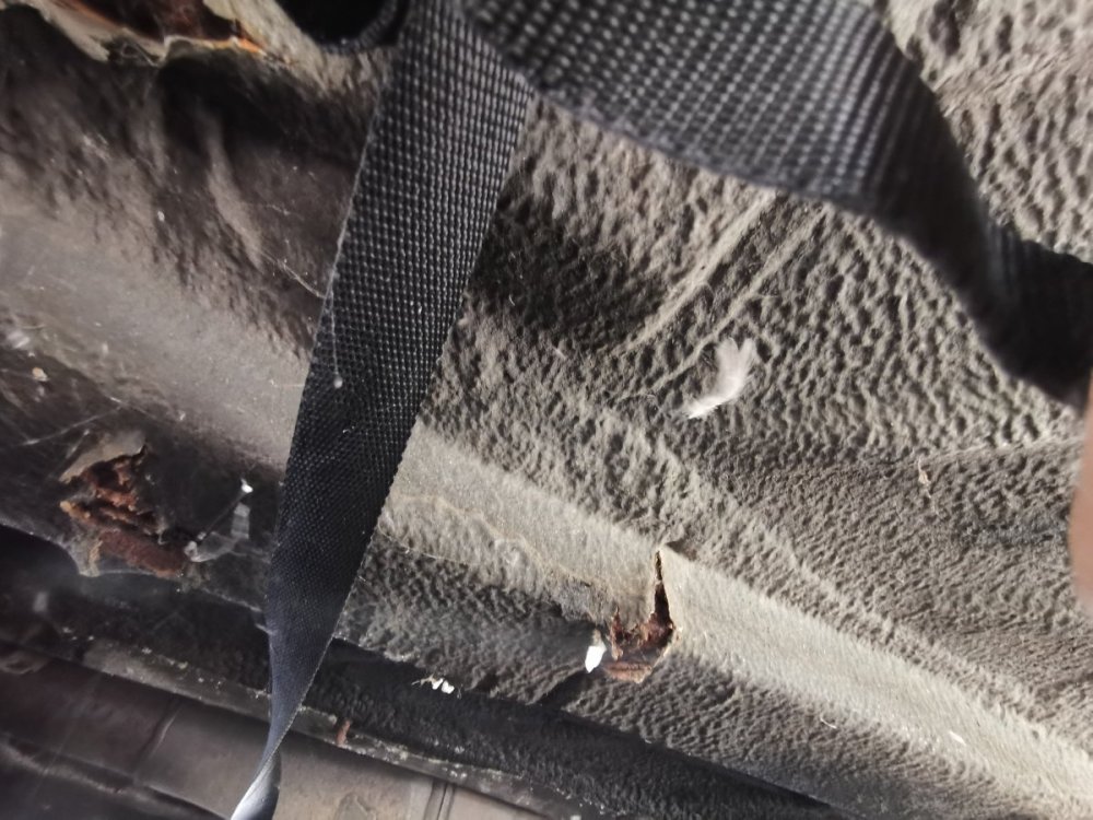

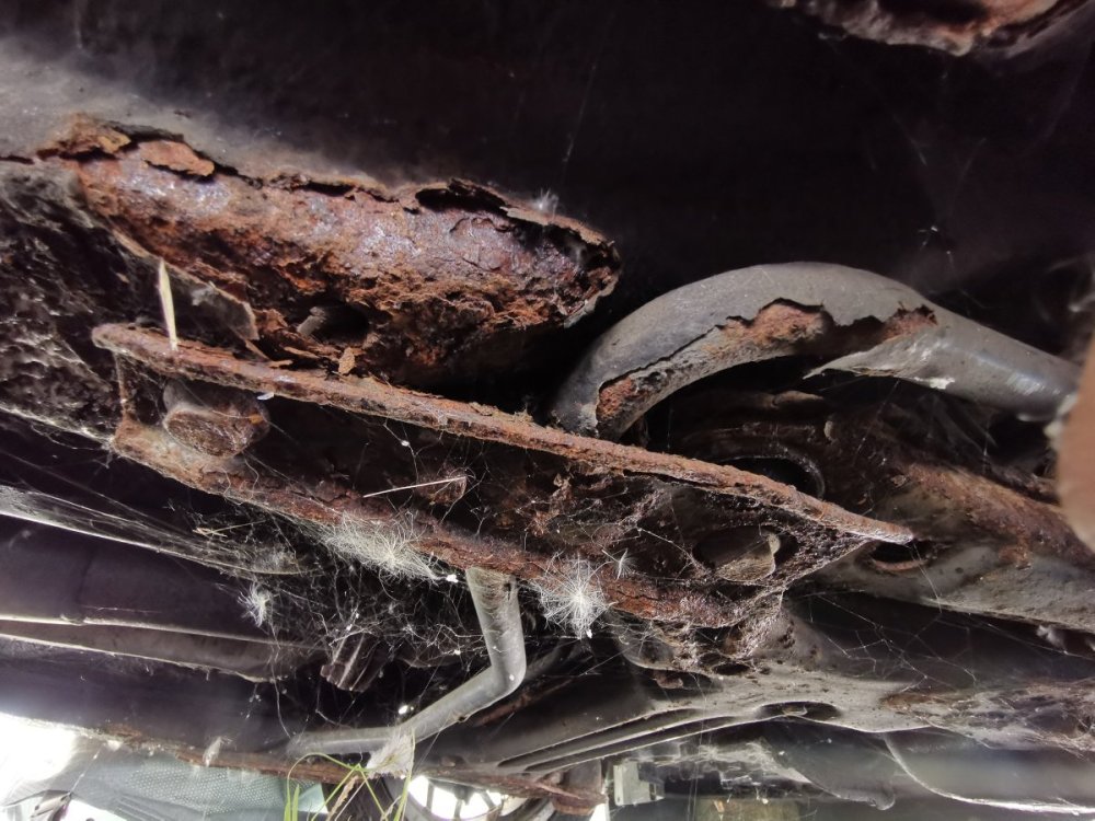

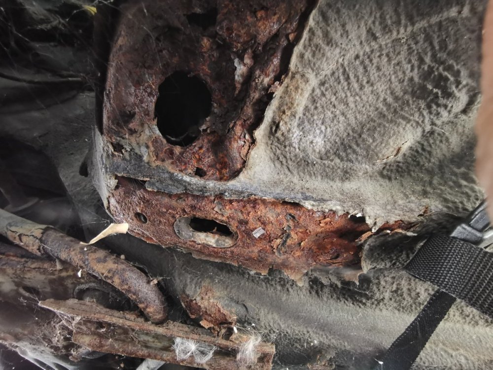

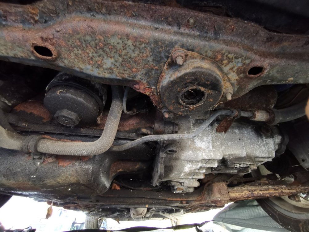

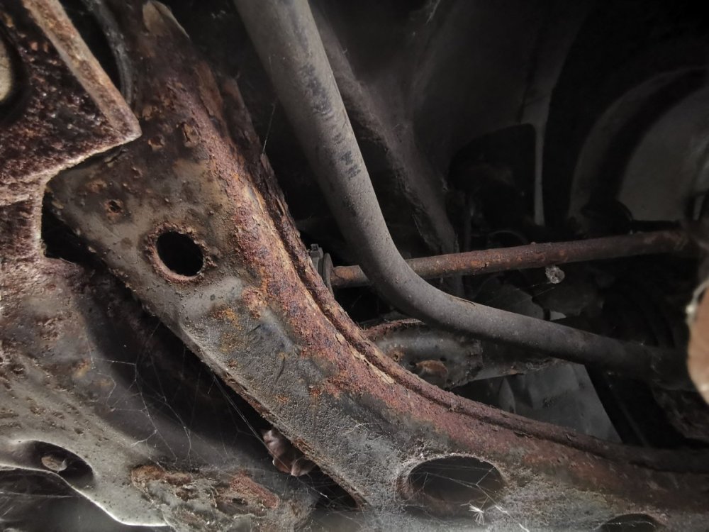

Its a complete car and while it has done 180k I believe its been well looked after for most of its life by its owner. However for the last 4-5 years it sat outside not properly covered with a leak in the body which resulted in some interior rust as well as the usual exterior. My biggest concern right now is the chassis/bodywork and thats what I wanted some advice on. What is rusted (see attached):
  • Jacking points
  • Arches
  • Spare wheel well
  • Interior surface rust - especially where unprotected steel came into contact with the body
  • Underbody looks ok since it looks like it was well protected but all components looks like they have at least surface rust but some work than others
I know I should probably get it to a bodyshop but wanted some opinions before I decide to spend money. Has anyone had a similar experience and what kind of spend am I looking at?

Fabricators are few and far between I have found! I don't really know of anyone locally except for Finishline in Stevenage. I would look at DST Rustworx up Scarborough way. He is a master at fabricating from scratch i.e he could make your arches from sheet metal... which is probably what is needed as any corrado specific panel requiring repair has no pattern part available. Parts shared with the mk2 like rear jack points can be had from pattern parts.
As for cost.... you'll not like this... but it would be cheaper to buy a "good" car from the start. Bodywork is expensive, you're probablt looking at c£3k for welding and c£6k+ for a full respray, more if you want to go back to metal.

Spend some money on lots of wire brush attachments for a drill or angle grinder and make it have it..... Bare metal always looks better and you can see what you are up against.  Then choose to primer it for protection before the welder gets to it, or if it scrubs up okay, get some bilt hamber on it.

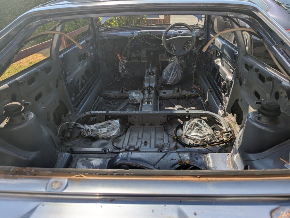

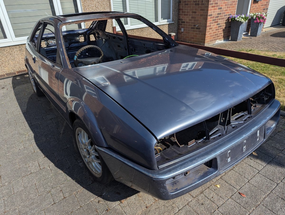

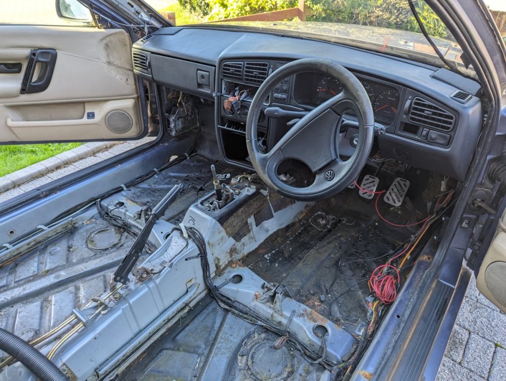

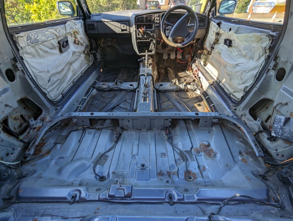

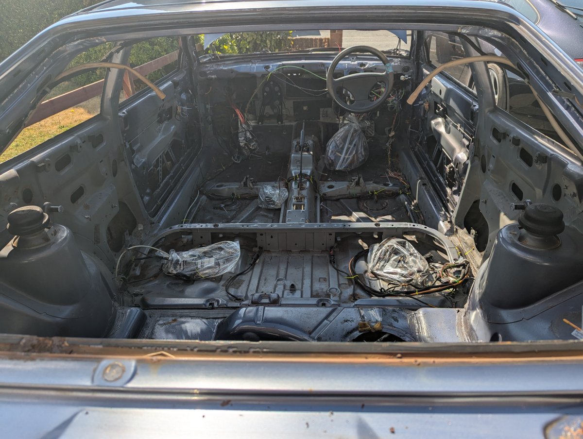

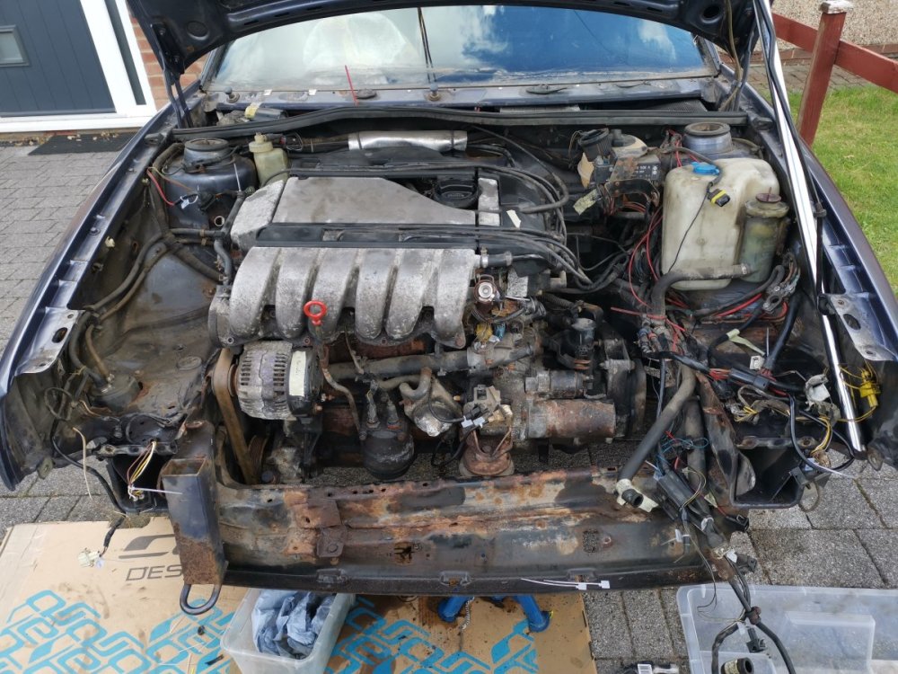

So far I have ( a few photos attached):
  • Interior
    • Stripped out the interior
    • Taken out the dashboard
    • Disconnected and labelled the wiring
    • Started removing some of the interior rust
  • Body/engine
    • Removed the front bumper and slam panel
    • Removed all exterior fitting
    • Disconnected all engine electrics

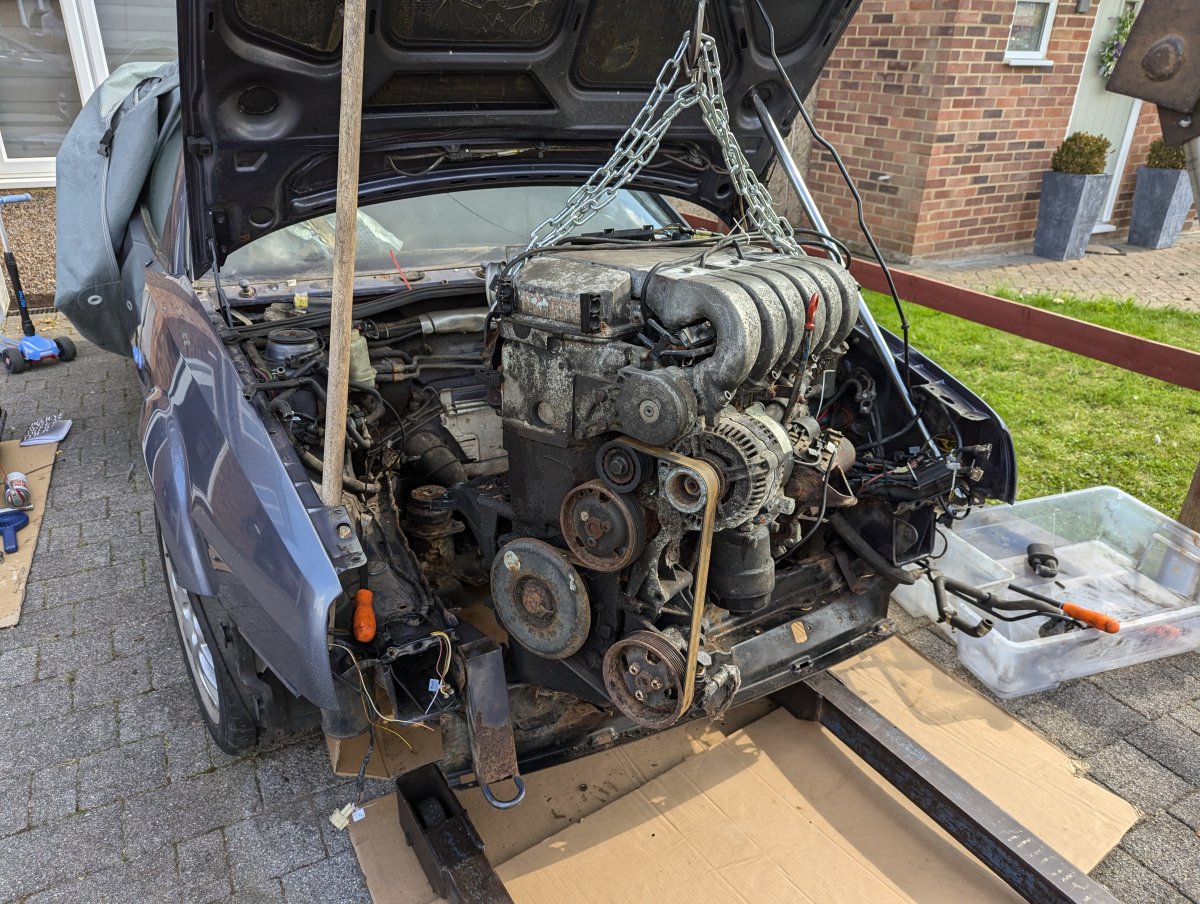

Next job is to disconnect the shift cables, exhaust/manifold and then engine can come out. Also need to remove the fuel tank and exhaust and get someone to remove the glass.

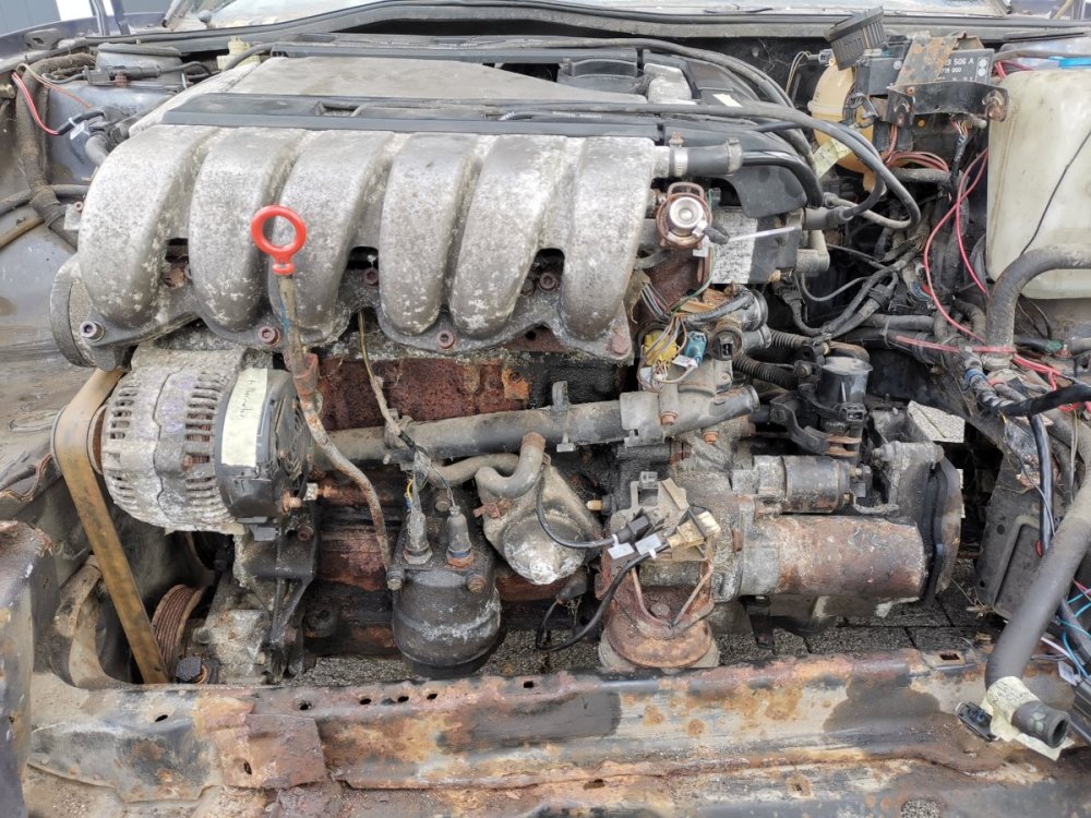

A few questions though:
  • The sump has what seems like fibre glass protection around it - any idea what this is?
  • The sunroof is knackered - whats everyones thoughts on deleting it? I really want to restore this back to factory but the cost of replacement looks crazy. I have seen some Passat versions used but do these use original controls and will they last a decent amount of time?
  • Engine bay - I just want to tidy it up really. I'll be removing a few things (brake components etc) but do you think I can get it looking good without stripping everything out?
  • Are there any other parts (similar to the sunroof) that I should take special care with? I am trying to be careful but be good to know any other areas where parts are non existent.
Thanks!

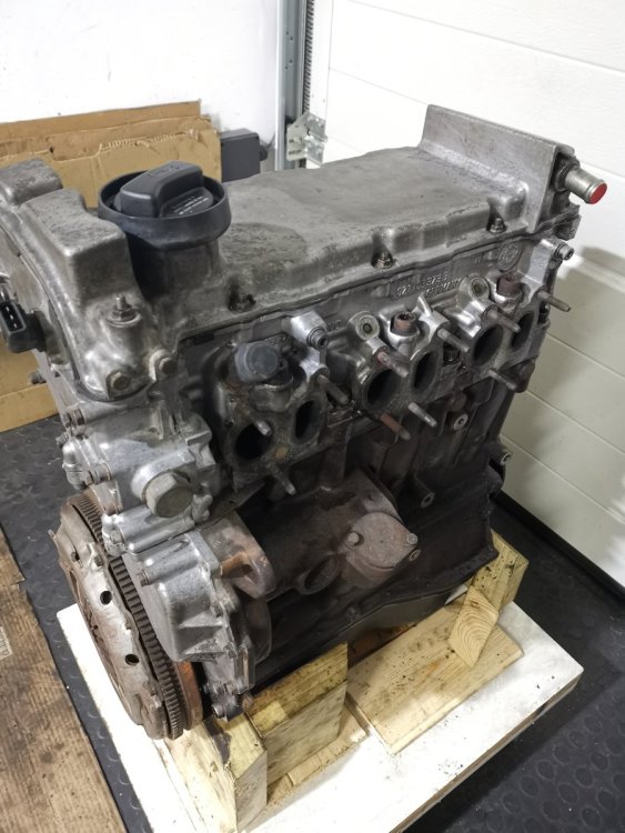

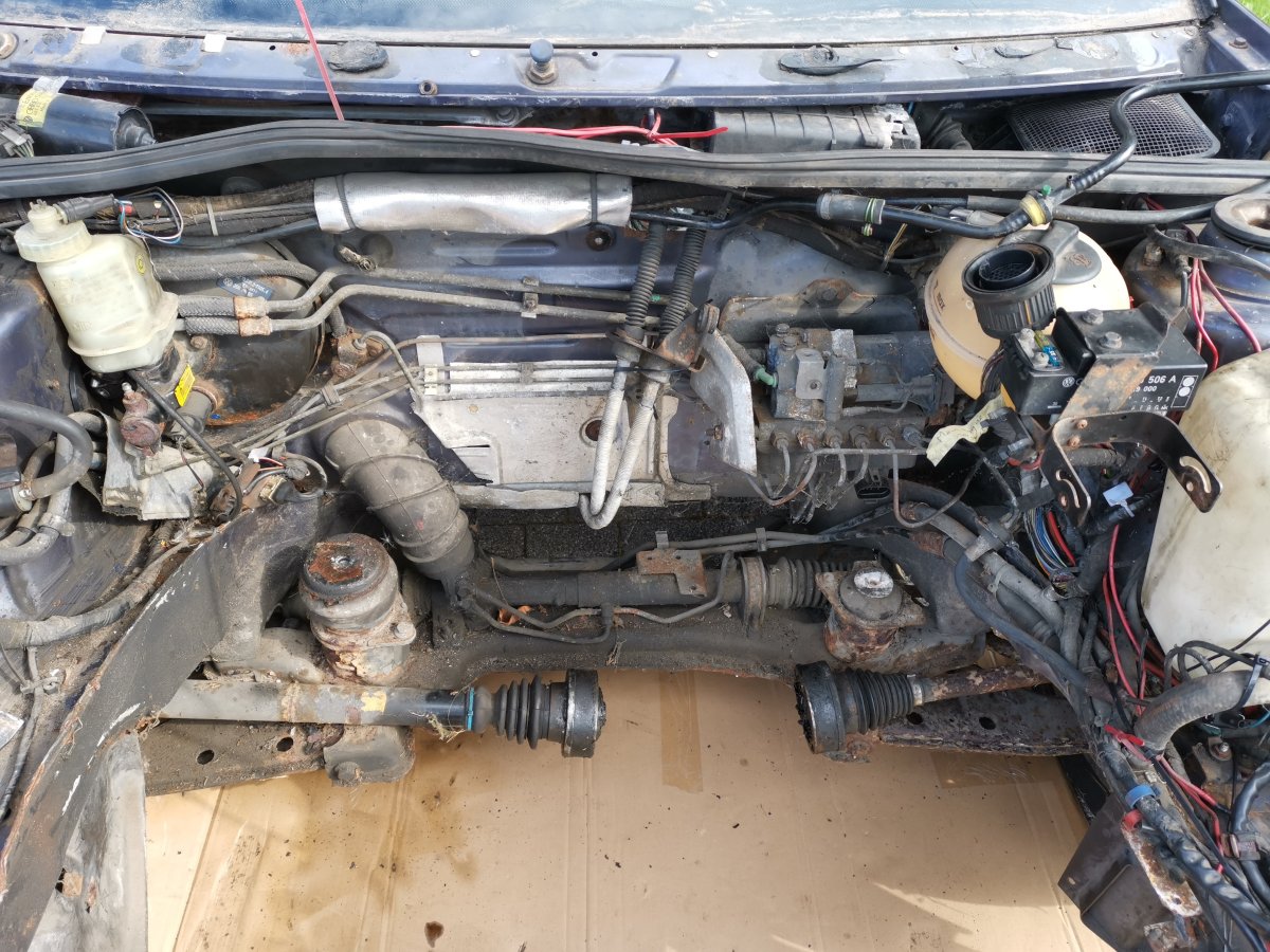

Posting a few update pictures. Progress is slow but I am getting through it! It has taken longer so far but I am trying to be meticulous in labelling and bagging everything that comes off and not breaking bits etc. Since the last update I have:
  • Engine and gearbox out
  • Engine ancillaries stripped
  • Driveshafts out
  • Glass out (with help)
  • Spoiler mechanism removed
  • Fuel tank
Sadly I found more rust around window frames but good news is that doors are solid (taking the small wins!). Its off to DST Rustworx today to get those bits looked at so hoping I don't get any more bad news! (thanks @_Matt_ for the recommendation)
In the meantime, I have a garage load of parts that need restoring! My logic says I should focus on gathering and sorting the rear subframe, fuel system and brake systems next. Any advice for or against that approach?
When tackling the rust, I really recomend getting back to clean metal and get the rust out of the pitted steel. Overwise it will come back. Obv sheet steel you want to be a bit carefull with as it is thin metal. If you can blast the rusty bits, thats the route i would recomend. Remove the underseal with a wire wheel where requried to see what you are dealing with, and then blast the rusty parts of the chassis to get it back to clean metal, then paint. I have spent weeks cleaning up rust, and cleaning the underside of mine. Any questions fire away. The Bilt Hammer products are great.
Thanks, I am having the under seal removed at the fabricators and will tackle the others bits myself.
How would you treat thinner metal used inside the car? E.g. the frame that is part of the dash has surface rust - is there a specific bilt hammer product for that?
