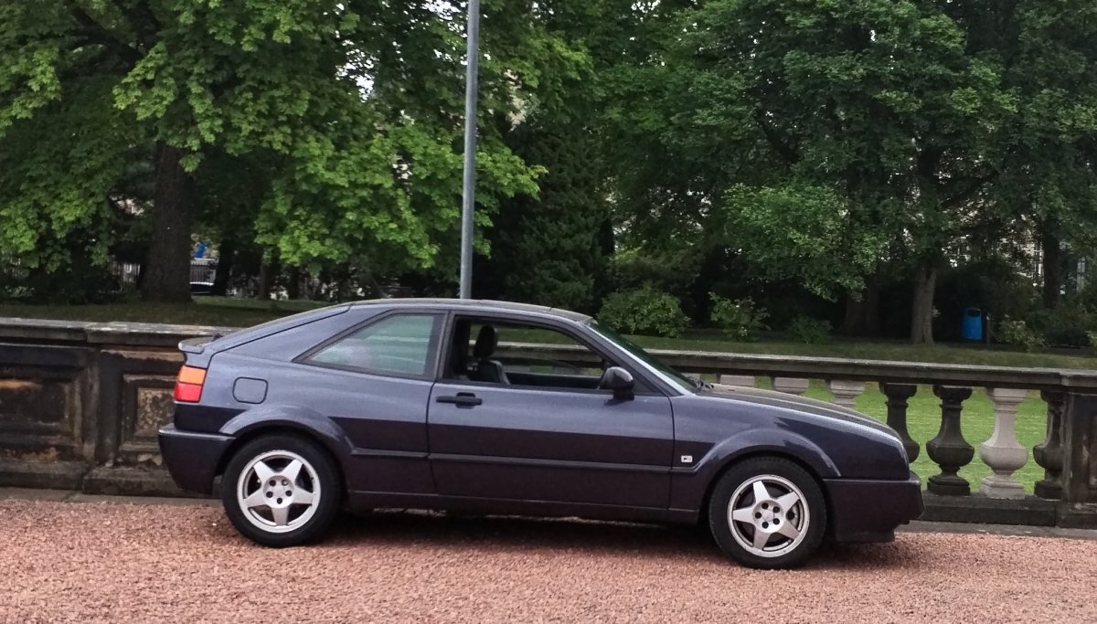

garemberg 11 Posted July 27, 2024 Having finally fixed (closed the sunroof) my ULEZ compliant VR6 can see the light of day again after probably 3/4 years , also I now have more time with my daughter being older. lots to do and some other toys to sell to fund it, any other Edinburgh owners give me a shout! Cheers Graham Quote Share this post Link to post Share on other sites
tonedef 10 Posted July 27, 2024 Great to see another one back from a “sabbatical” off the road, been using mine every day recently and loving it. Can’t remember the last time I saw another one on the road though and nowhere near Edinburgh! Quote Share this post Link to post Share on other sites
garemberg 11 Posted July 22, 2025 It's back on the road finally and amusingly ULEZ compliant so has been used for the school run. Enjoyed parking next to a G wagen to show how absurdly large cars are now. Quote Share this post Link to post Share on other sites

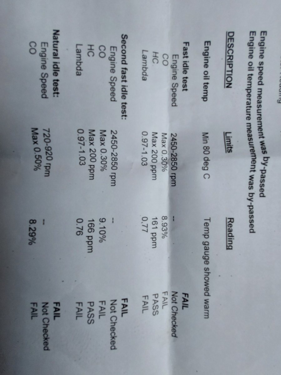

corrado wannabe 13 Posted July 23, 2025 Good stuff, I am close-ish, Biggar. But mine is currently smirking at me every time I open the garage door as I can't get the emissions down on it. Think I'm going to give in and pit it into an old school garage near me and see if they can diagnose the issue rather than throw parts at it. Dougie Quote Share this post Link to post Share on other sites

Dox 31 Posted July 25, 2025 On 7/23/2025 at 1:53 PM, corrado wannabe said: Good stuff, I am close-ish, Biggar. But mine is currently smirking at me every time I open the garage door as I can't get the emissions down on it. Think I'm going to give in and pit it into an old school garage near me and see if they can diagnose the issue rather than throw parts at it. Dougie EMISSIONS HELP CO high, co2 low hc high, o2 high - rich mixture with ignition misfire CO high, co2 low hc high, o2 low -faulty thermostat or coolant sensor CO low, co2 low hc low, o2 high - exhaust leak after cat CO low, co2 high, hc low, o2 high - injector misfire, cat ok CO high, co2 low, hc medium to low, o2 high - rich mixture CO high, co2 high, hc high, o2 high - injector misfire, cat not working, combination of rich mixture and vacuum leak CO low, co2 high, hc low, 02 low, good afr and cat operation- system normal . lambda typical range 0.97 to 1.03 [ ideal lambda 1 ] The emissions limits to be met are specified for both the fast and normal idle tests. At fast idle, CO must be at or less than 0.2%, HC at or less than 200 parts per million (ppm), and the lambda value(1) must be between 0.97 and 1.03. At normal idle, CO must be at or less than 0.3% 1 Quote Share this post Link to post Share on other sites
corrado wannabe 13 Posted July 25, 2025 2 hours ago, Dox said: EMISSIONS HELP CO high, co2 low hc high, o2 high - rich mixture with ignition misfire CO high, co2 low hc high, o2 low -faulty thermostat or coolant sensor CO low, co2 low hc low, o2 high - exhaust leak after cat CO low, co2 high, hc low, o2 high - injector misfire, cat ok CO high, co2 low, hc medium to low, o2 high - rich mixture CO high, co2 high, hc high, o2 high - injector misfire, cat not working, combination of rich mixture and vacuum leak CO low, co2 high, hc low, 02 low, good afr and cat operation- system normal . lambda typical range 0.97 to 1.03 [ ideal lambda 1 ] The emissions limits to be met are specified for both the fast and normal idle tests. At fast idle, CO must be at or less than 0.2%, HC at or less than 200 parts per million (ppm), and the lambda value(1) must be between 0.97 and 1.03. At normal idle, CO must be at or less than 0.3% Great info Dox, thank you. So far, I have: Injector seals, throttle body gasket, plugs, lambda sensor, temp sensor, cat. Swapped ecus, swapped isv. I am getting a couple of exceeded limits codes, so I'm happy the sensors are reading correctly but can't adjust any further. My next port of call is to check the injectors, including the fifth injector. I'm just glad it's not my daily driver! Dougie Quote Share this post Link to post Share on other sites

Dox 31 Posted July 26, 2025 On 7/25/2025 at 9:47 AM, corrado wannabe said: Great info Dox, thank you. So far, I have: Injector seals, throttle body gasket, plugs, lambda sensor, temp sensor, cat. Swapped ecus, swapped isv. I am getting a couple of exceeded limits codes, so I'm happy the sensors are reading correctly but can't adjust any further. My next port of call is to check the injectors, including the fifth injector. I'm just glad it's not my daily driver! Dougie You should have an emissions print out from the MOT fail? Quote Share this post Link to post Share on other sites
corrado wannabe 13 Posted July 26, 2025 5 hours ago, Dox said: You should have an emissions print out from the MOT fail? Yes, will dig it out and compare to the list you posted earlier. I'm also waiting on an oil filter so I can change the oil as I think that can also have an effect on emissions. Dougie Quote Share this post Link to post Share on other sites
corrado wannabe 13 Posted July 26, 2025 For info, will look at it and compare to your list Dox, but all thoughts appreciated. Apologies to the OP for derailing their thread! Quote Share this post Link to post Share on other sites
