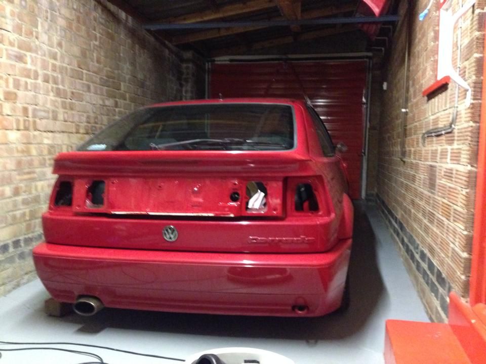

Okay so back in 2020 i already had a G60 in black as a project bought on a bit of a whim and which needed quite a bit of work !
Always on the hunt for parts for it i had bought a few random parts off a uk ebay seller , by chance i spotted in one of his pictures the faintest outline of a what looked like a fairly complete car in red. enquired what the story with it and i turned out that this was the car he was breaking the parts for sale off !! Turns out he had owned the car since 2001 and had embarked on a semi refresh of the underside of the car not long after purchasing it ,the usual jobs ,subframe ,rear beam ,wishbones blasted and powdercoated ,new supsension etc. only it seems like he had bitten off more than he could chew ,along with a very small workspace ( see below )it just seemed to have gotten the better of him and he lost interest in it .
Years later he starting selling of bits of the car gradually on ebay where i came across him.
He was willing to sell off the remains of the car so a deal was done , i bought the whole lot sight unseen ,i was taking a bit of a chance on it but the cost of the new spare parts that came with it alone was worth the asking price.
Edited by Brian1975
  • Like 1
Inspection time. what had i bought! Turns out i did very well indeed , the car or remains thereof was in very good condition overall ,

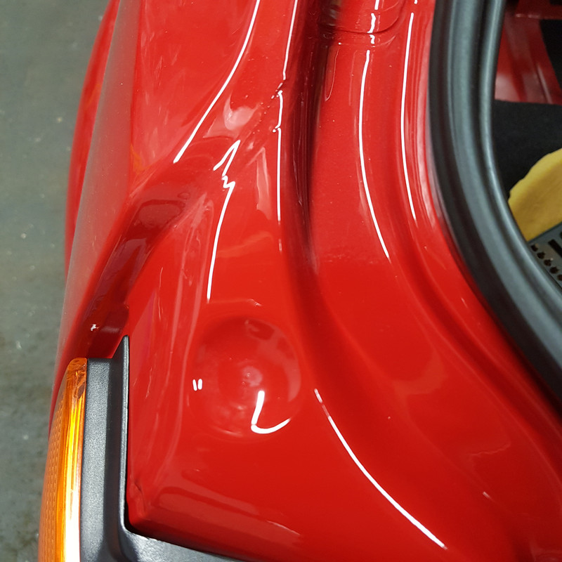

rust free shell , a few dings and scratches here and there ,a bit of RHS  wing bodgery but all origional paint and no rust to be found anywhere .

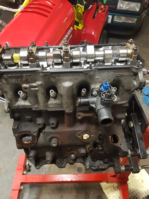

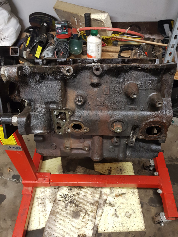

The engine at some point had its crank pulley bolt come loose and as a result had damaged the crank nose and keyway so that the pulley was moving on the crank under load . i cleaned it up as best i could and pinned a new main crank gear onto it . it worked but there was still a slight wobble so i didn't feel i could trust it , so the only option was to replace the crank for a new one .
Thought if i was doing this i may as well have a look inside and see what's what.
Engine out and teardown.

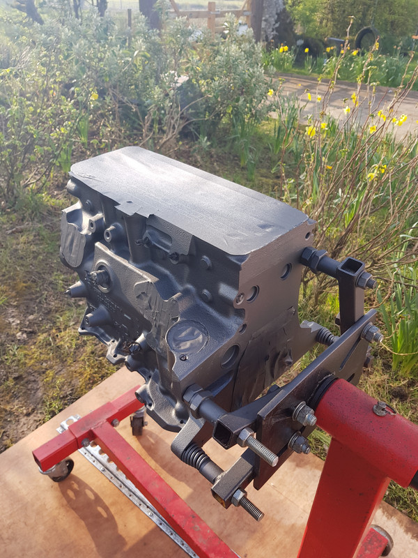

it was in reasonable condition overall, the crank its self was in great condition so a bit of a shame to scrap it really .

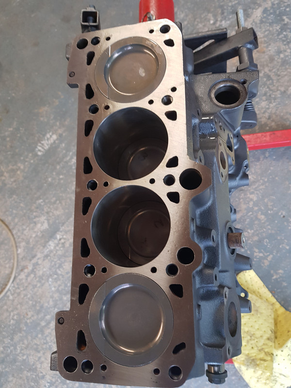

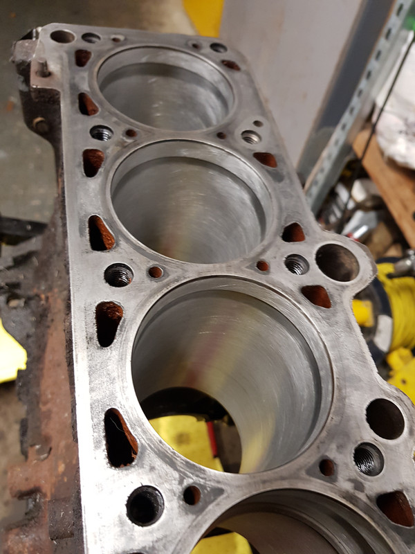

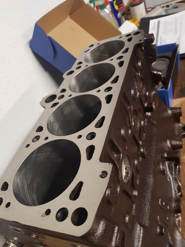

however i found quite a lot of cylinder bore wear at the top of the ring landings ,More evident after honing .
The consensus was that really it was too much wear to be ignored so the only real option was to bore it out oversize . Thing were about to turn expensive !!

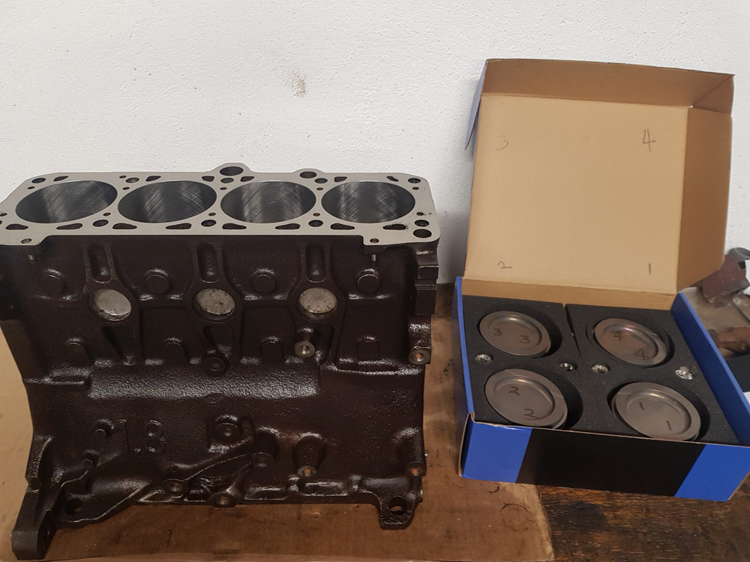

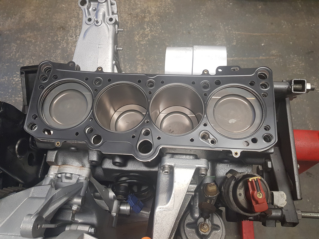

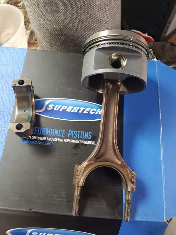

Engine bored out to 83mm / IE max oversize on these blocks .Blocked decked also to gain a bit more CR.

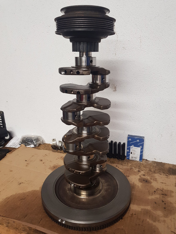

Supertech ultralight high compression forged  pistons
New ex 16v KR crank and rotating assembly polished and balanced .Fywheel lightened by 2.5 kgs

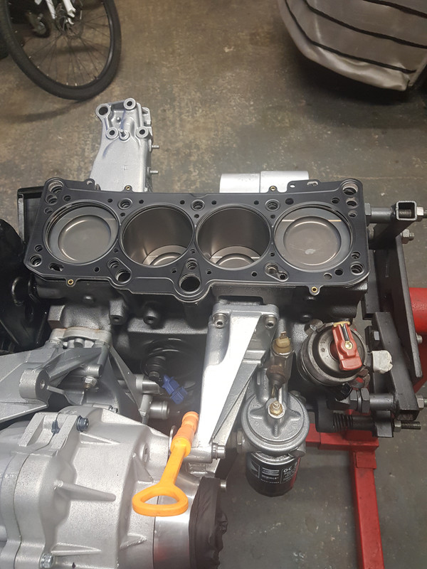

The main reason i got these pistons is that it allowed the use of 144mm con rods instead of the G60,s heavy 136mm items . I used OE KR rods which were in excellent condition , these have been used in 16v turbo applications and are well able for big power , more than ill ever need to bother them with . This set came exceptionally well balanced from the factory ,Only 0.5 g between them.
KIng /ACL race spec bearings and special order comotec head gasket.

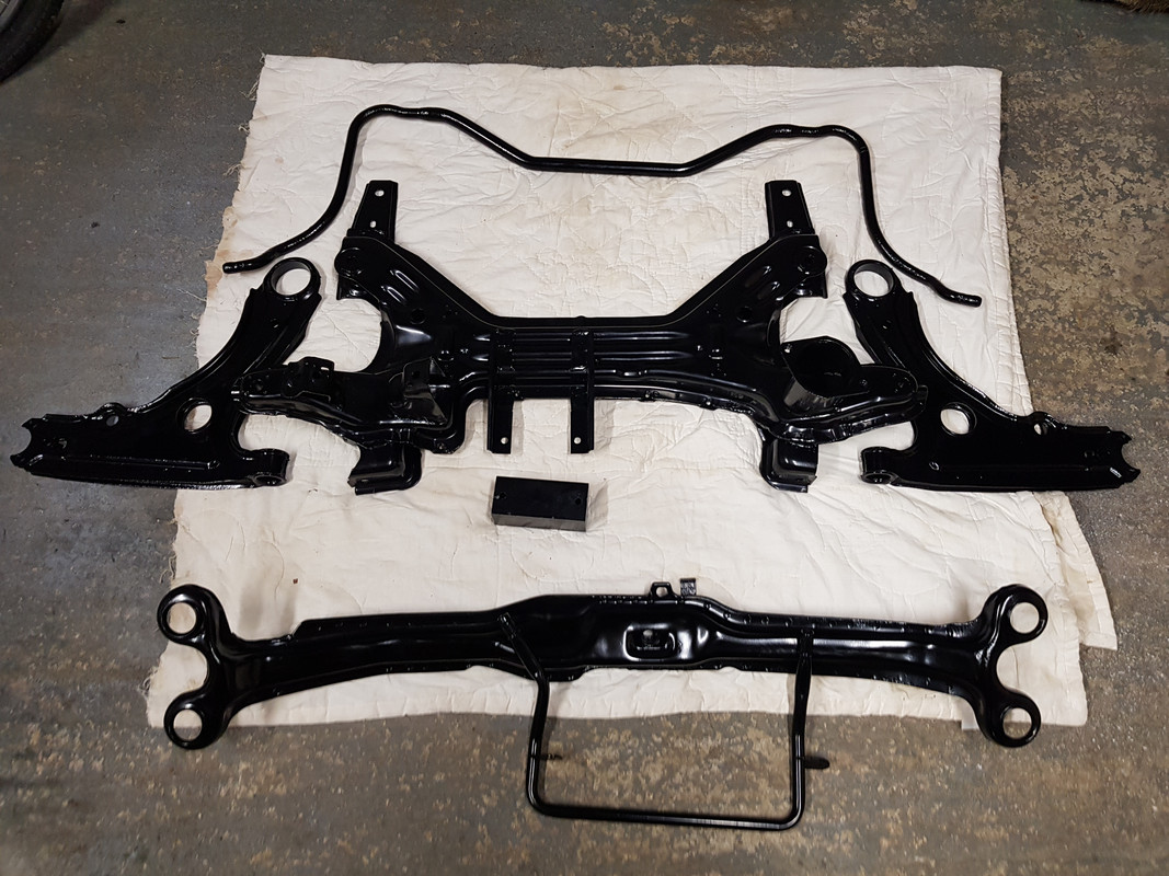

Got all the underside components powdercoated.
Built up the front subframe with a mixture of powerflex and OE bushes .
New Oe mk3 golf GTI ps rack .
Solid efforts, it is great to see these build threads showing these cars being saved, especially when people DIY as well.

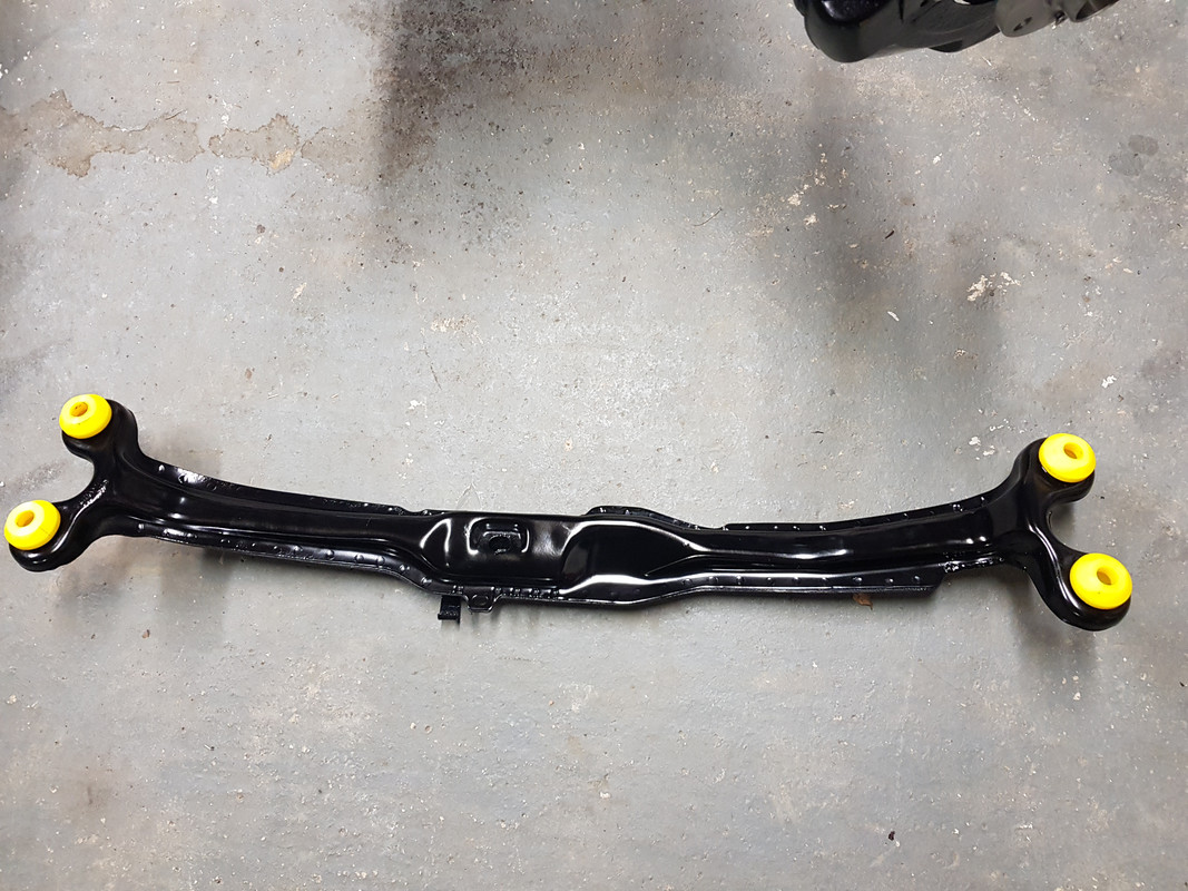

Front Crossmember built up with powerflex bushes

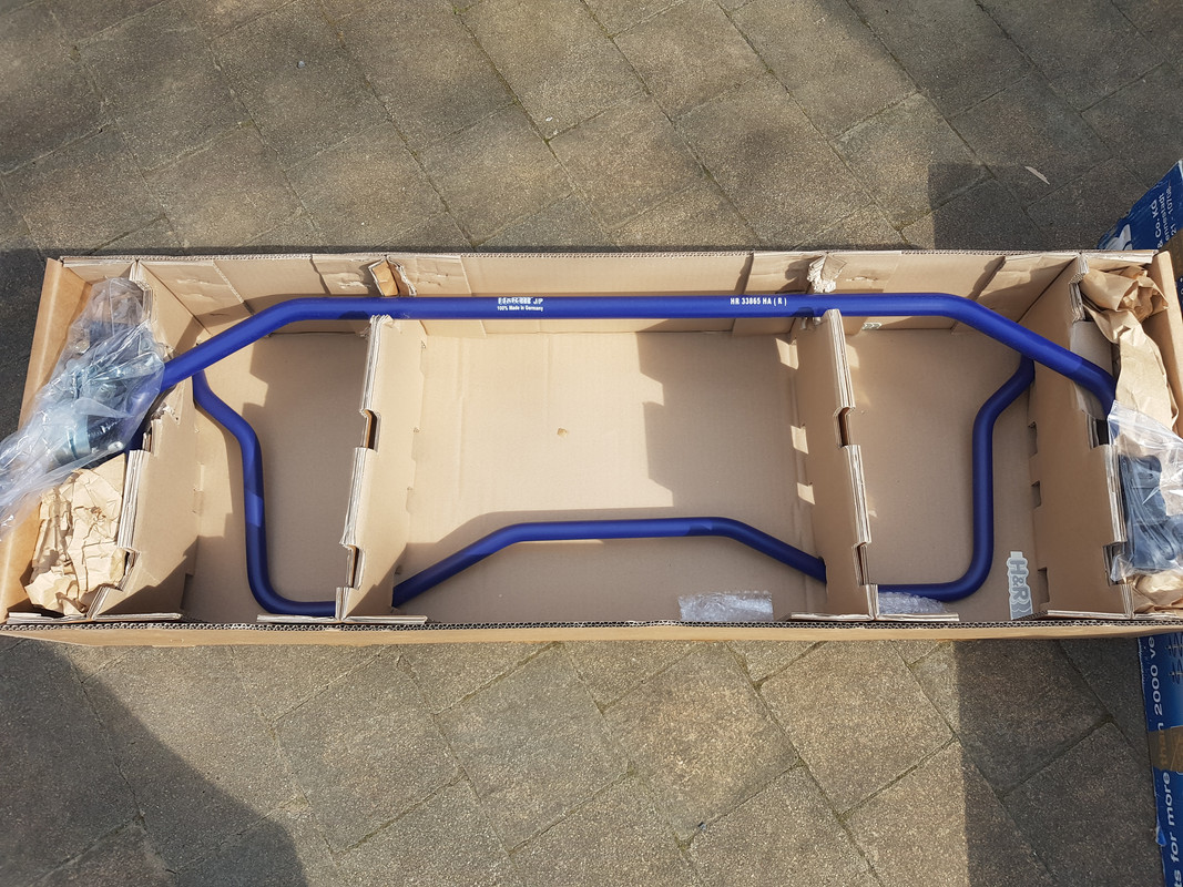

Got a set of H+R ARB,s 23mm front +25mm rear. I had these on a previous mk2 golf gti and loved them !
Fitted on the front

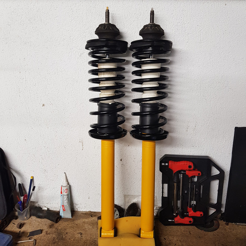

The koni dampers and springs came with the car but needed to be built up with new bumpstops and top mounts

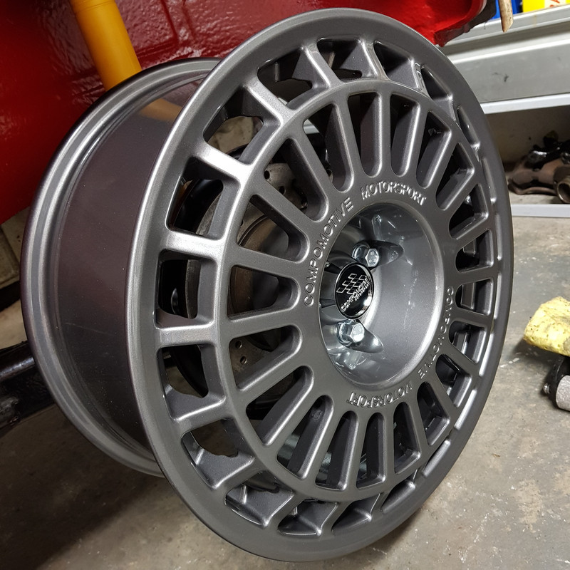

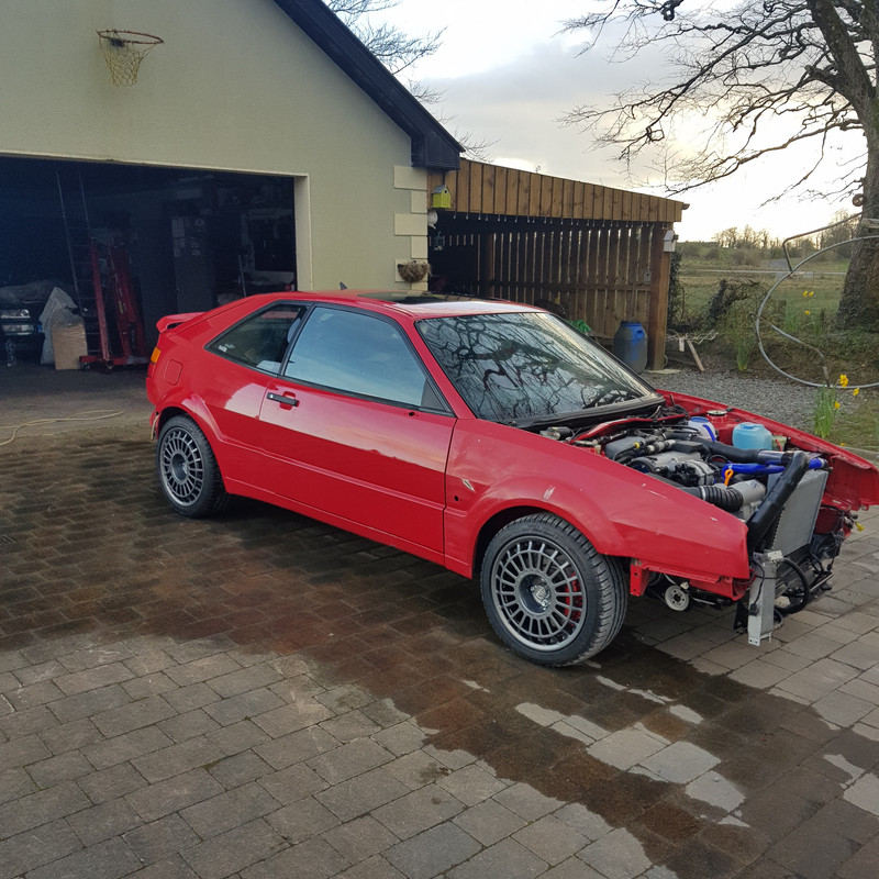

Now this put me in another situation ! there was no way the OE 15" wheels would fit over these brakes so had to go shopping for some 16"
i wanted something retro but oem looking but with a nod to motorsport at the sametime ,in the end i contacted compomotive direct in the uk and purchased these bad boys!
Compomotive 16" TH2 7x16 ET25 in Anthracite .Delighted with these and the guys from Compomotive were excellent to deal with .

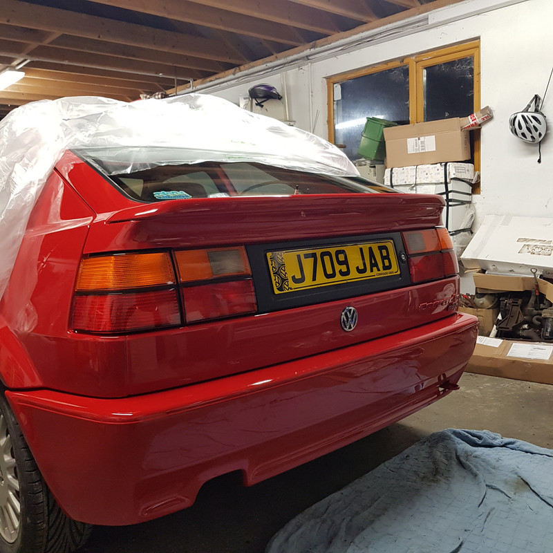

So next step was sending the car off for painting in original tornado red .
The guys had it for about six weeks and they did a great job on it.

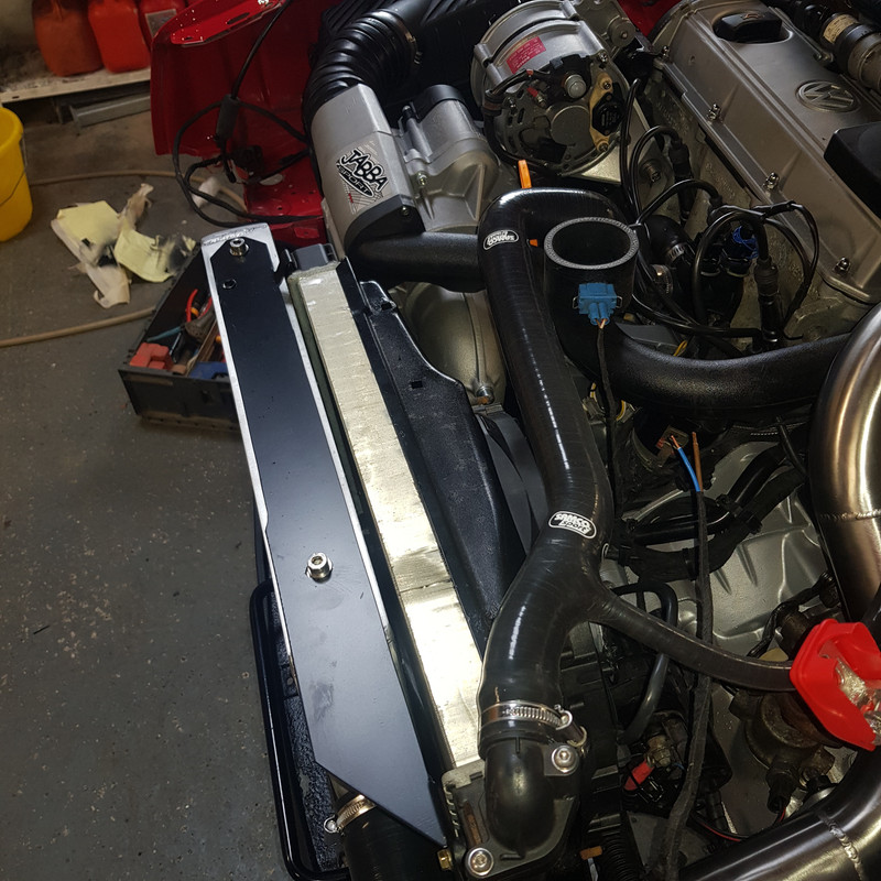

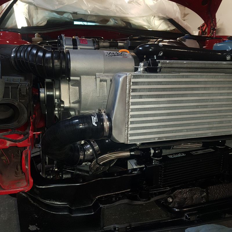

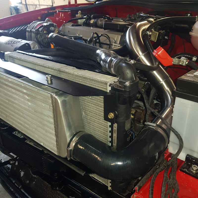

I generally like my cars oem or oem plus ,at least visually but one thing i had to improve on was the intercooler setup.The oe system is pretty poor and barely adequate for a standard engine .
They mounted the small IC behind the ps bumper in front of the wheel arch and plumbed it up with a convoluted series of narrow bore piping so the chances of lowering the intake temperatures are pretty slim and the number of pipes and joints makes it difficult to have a non leaking setup.

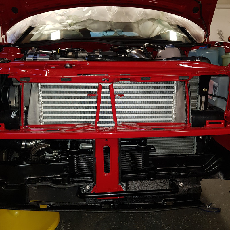

I wanted a front mount IC on the car but didn't want to go hacking and chopping bits out of the slam panel and move the battery away to the boot .Frontal space is minimal on these due to the odd position of the rad in relation the slam panel . I ended up steping back the rad off the crossmember on the DS to gain more clearance of an IC . I also got rid of the original rad fan as the motor on there are massive and replaced it with a Spal fan that fitted perfectly on the fan housing .
After much trial and error, buying intercoolers the didn't fit properly etc ,mocking up ,making brackets /remaking brackets i ended up with this !
With front slam panel fitted ,very happy with the way it turned out and i didn't have to fettle and of the slam panel with the grinder! (almost lol) i also installed a setrab remote oil cooler with AN fittings and hoses and got rid of the factory water cooled setup . These G60,s run very hot so this is a must have mod .

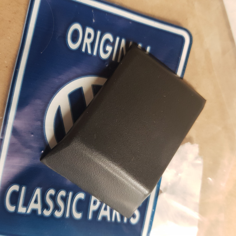

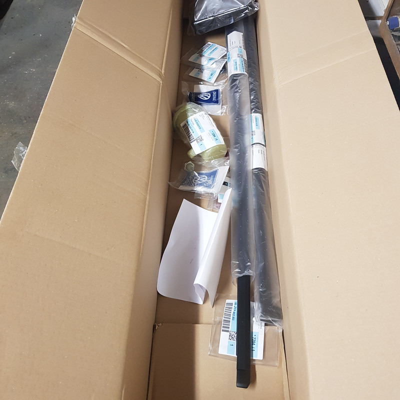

The build up continued and i had some parts ordered from classic parts in germany .

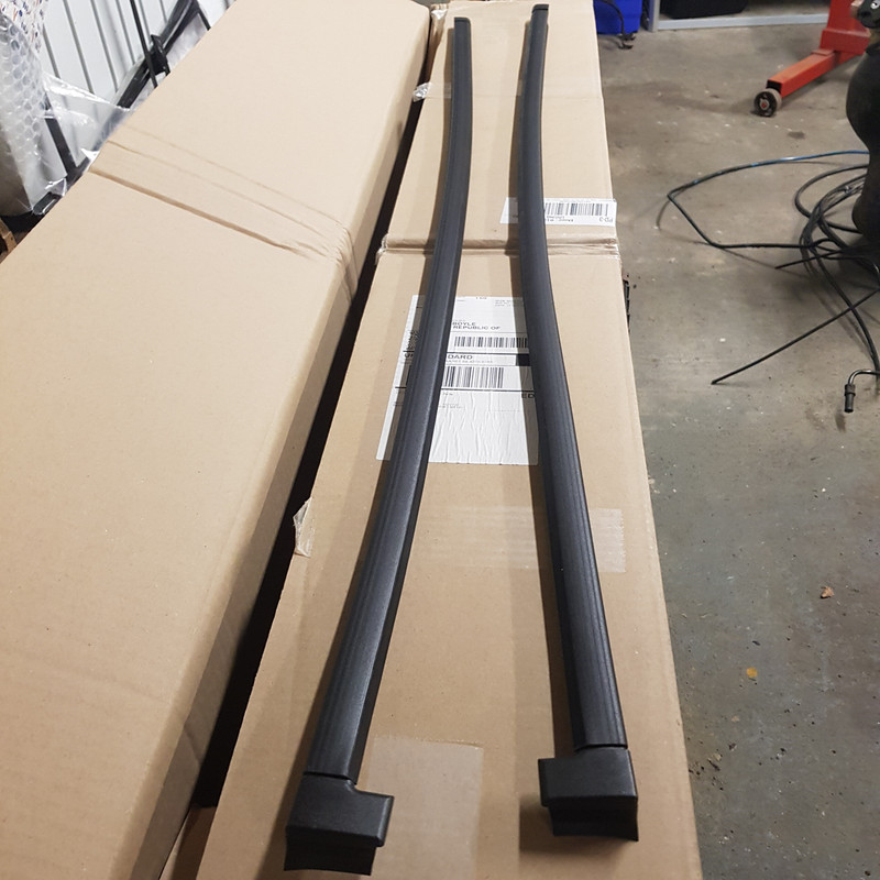

After being obsolete for many years the roof trims are available again , At a price !!

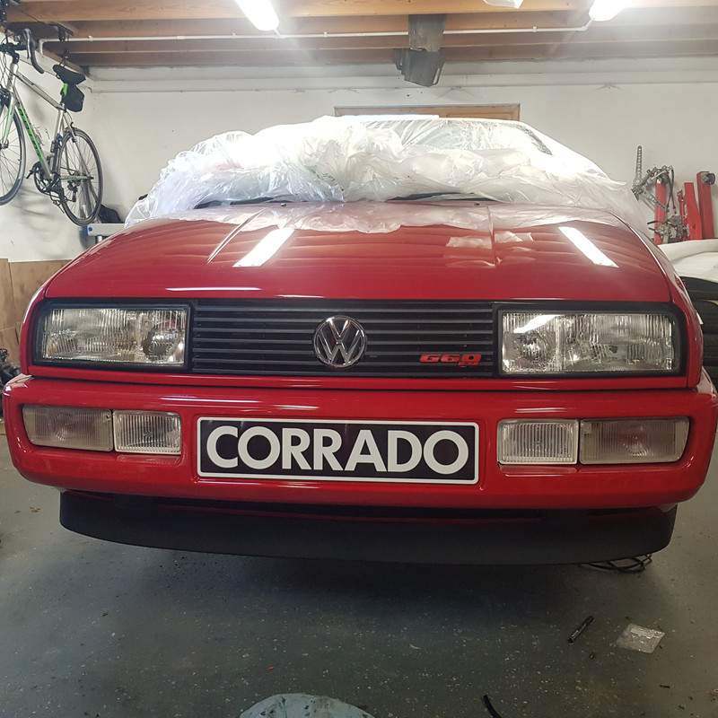

So bringing this thread up to date here is the car as more or less is at present.
ITs fully legal now and ended up being only 214 euro VRT due to being over 30 years old .Result!!
