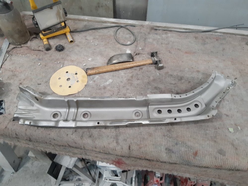

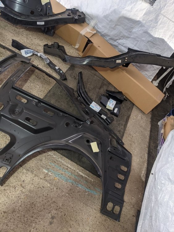

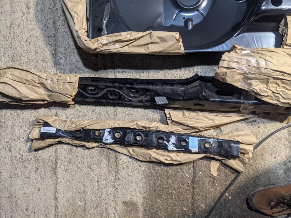

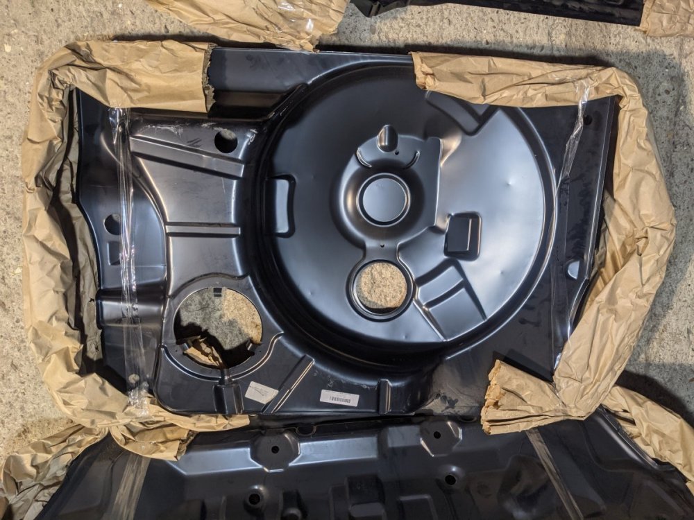

Boot and rear sections were repairable, but as with other sections, just not worth the time/money vs a new panel.

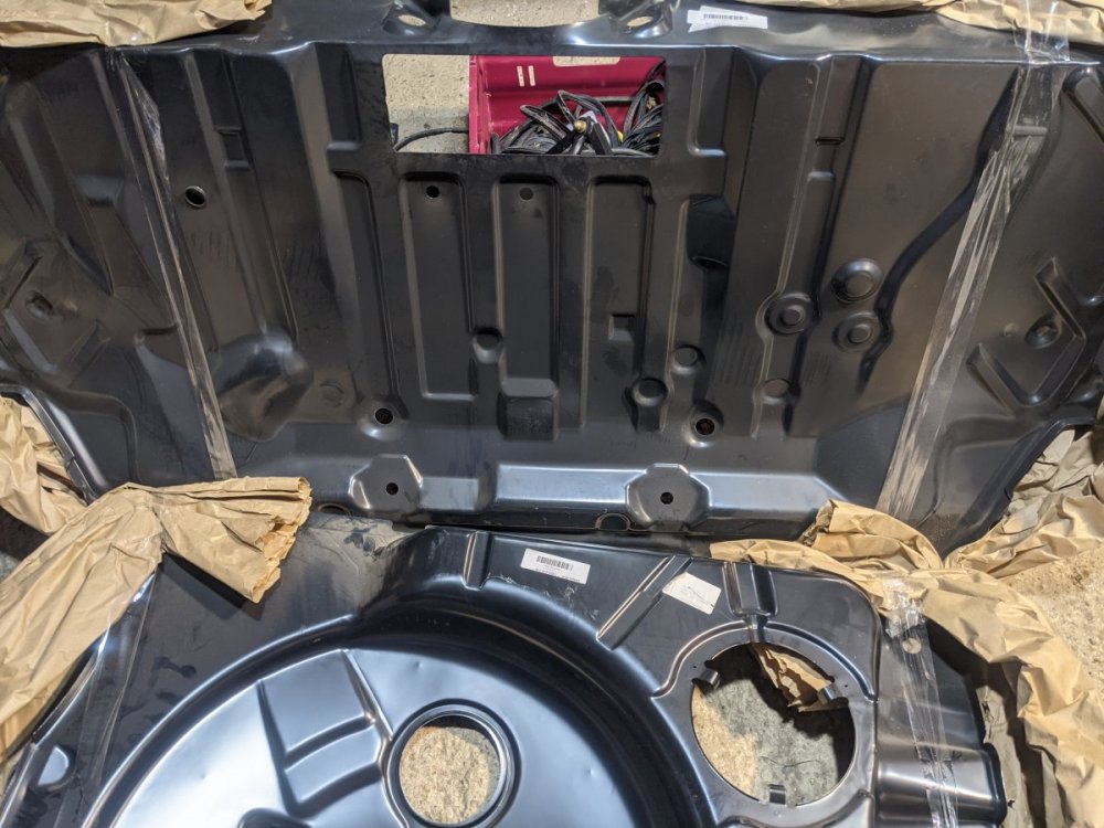

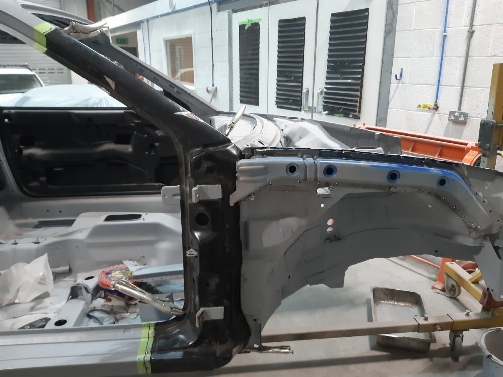

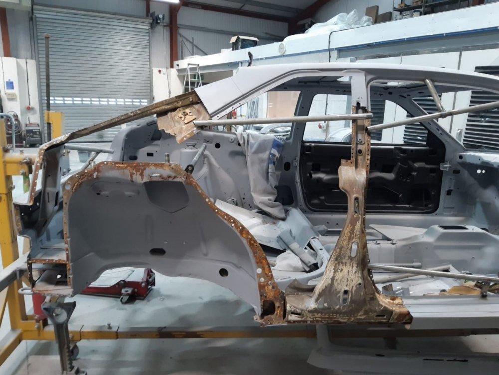

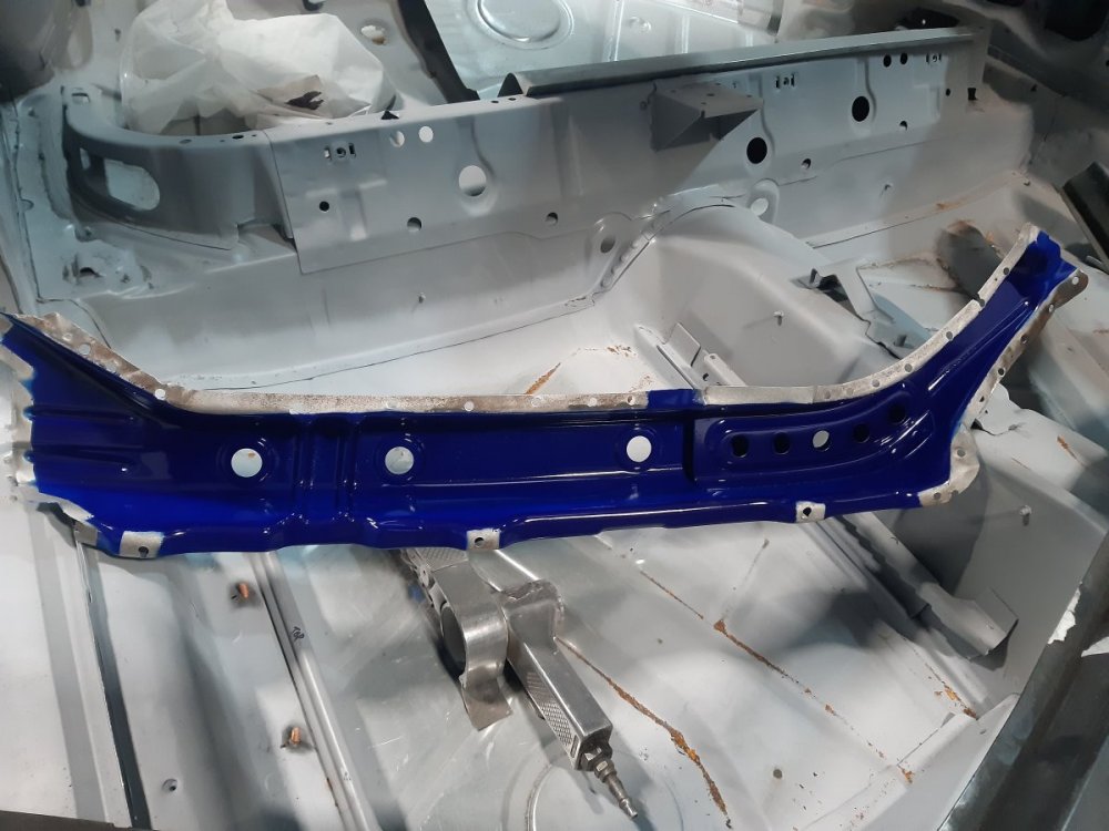

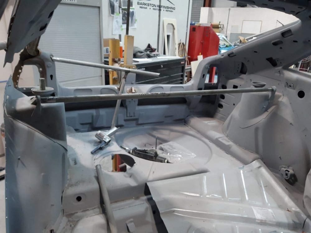

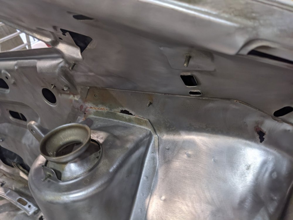

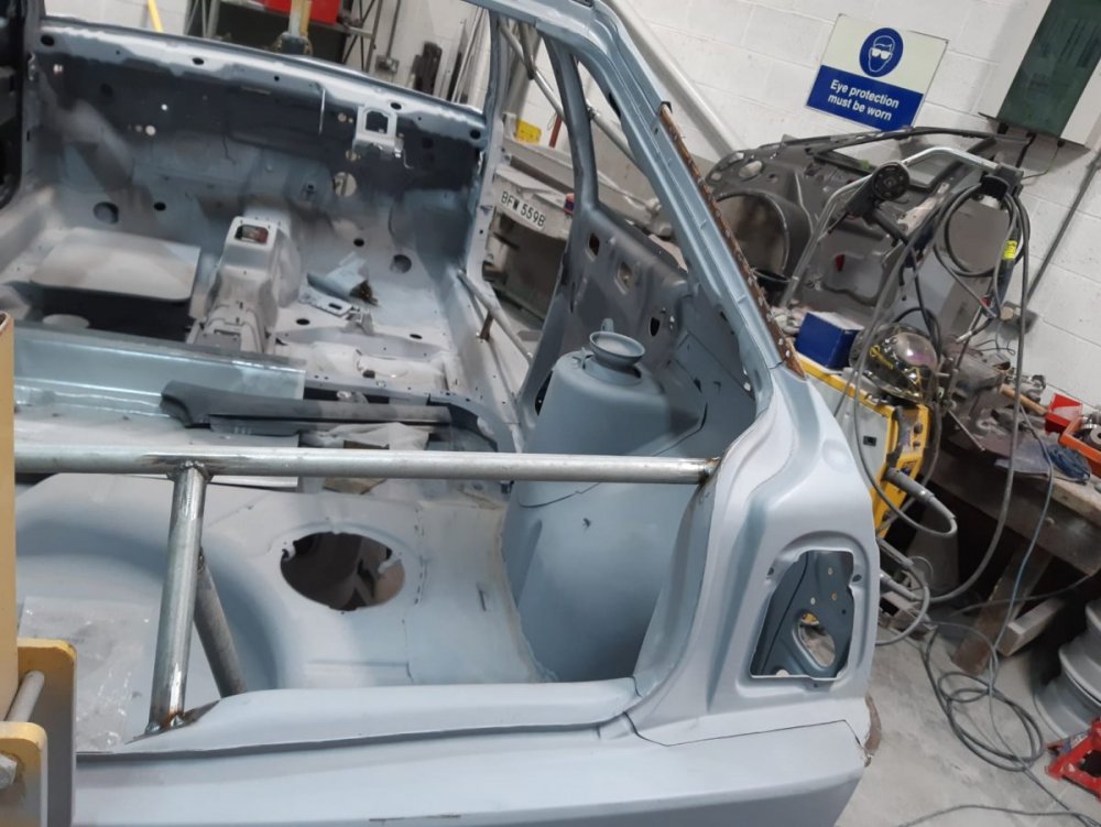

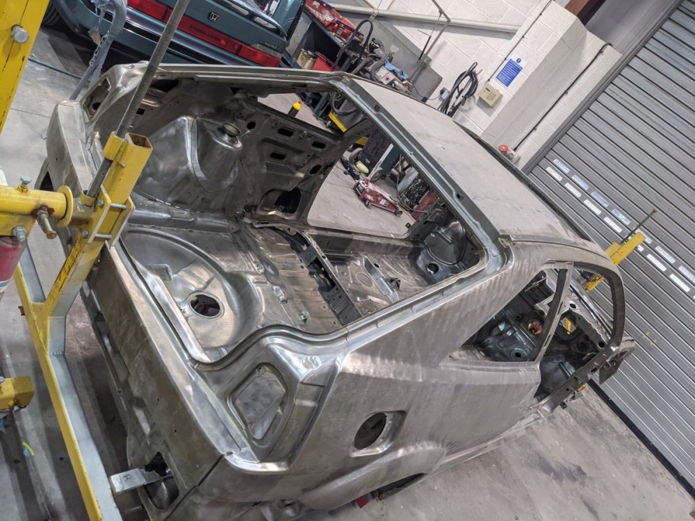

While there wasn't excessive rot, at the price of the panels I decided to just change them rather than have the repairs made on the arches, around the fuel filler and the join to the inner arch. On both sides, the whole quarters are being replaced with VW panels: outer skin, inner skin and the arch. Detailed measurements taken and bracing has added to ensure factory fit down to the last spot weld...
Sadly N90 147 001 is wrong for the bulk of the bungs, I thought it was that too and now have 6 of them... but they look like they might fit in place of N90363901 - they are the same size but without the profile... I'll get some other photos and explain which part numbers I believe they all are - but this has to be one of the rarest jobs ever on Corrado 🙂
Those are the only ones I can see but the factory ones are were metal with a cross on them. They also have metal clips.... Then they are covered in sealant! Might have to clean the old ones up 😕

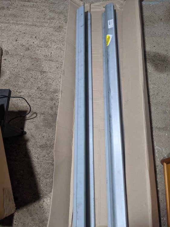

Took a chance on some of those eBay outer sills... These are the latvia sourced ones.. profile looks good but will need a little modification to get the slight difference for either side as these are symmetrical.
More panels arrived today... Still more to come...

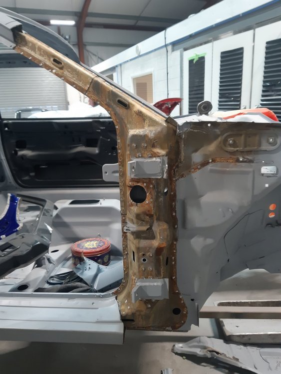

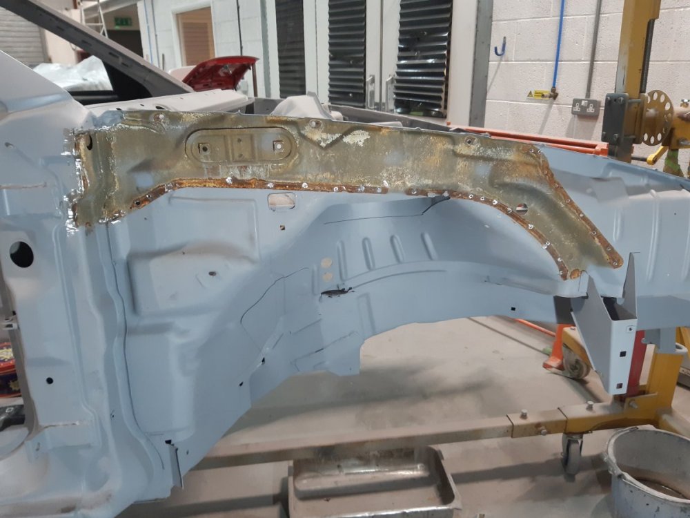

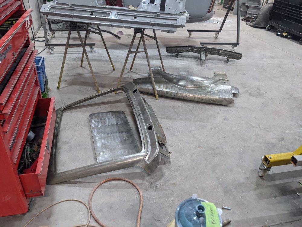

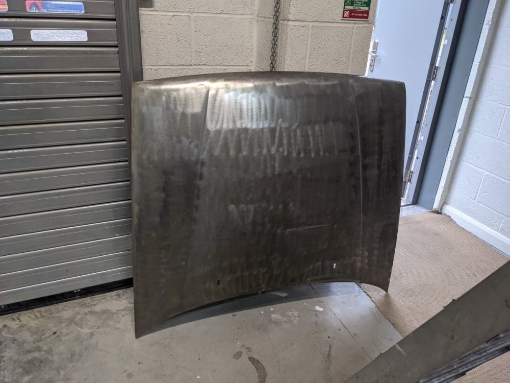

Progress picking up, not going to share all the pics but can see a the level of detail going on to repair every tiny pit of rust.
Awaiting on another batch of panels, just quicker and cheaper to replace than repair.

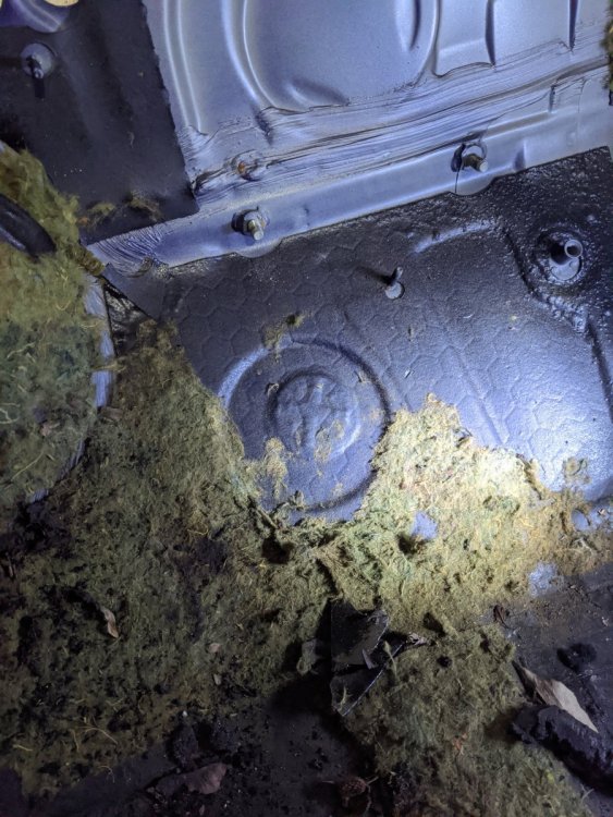

I've seen plenty of people redoing the underseal and certainly something worth doing. While no huge corrosion was found, it had started to go around the threaded fixings and around a few of the bungs.

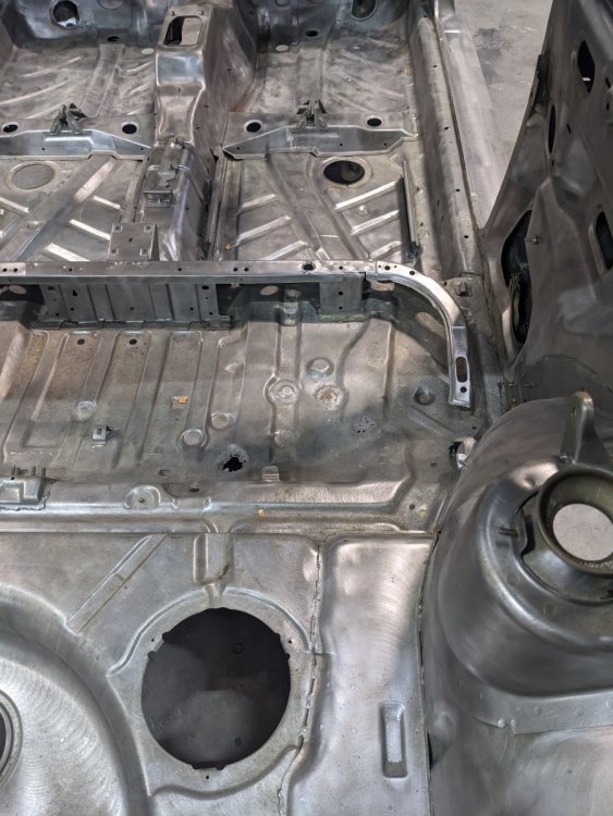

Has anyone ever tried to get floor pan bungs? They all seem to be rubber that I can see and not the metal that they left factory with. Have the ones I removed but will be a pain to clean up.
They came from VW Heritage, price was way better but did have to wait. Wasn't in a hurry as that was 2 years ago. They were boxed and strapped to a pallet so arrived unharmed.

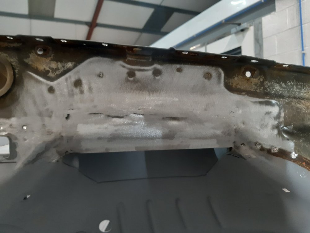

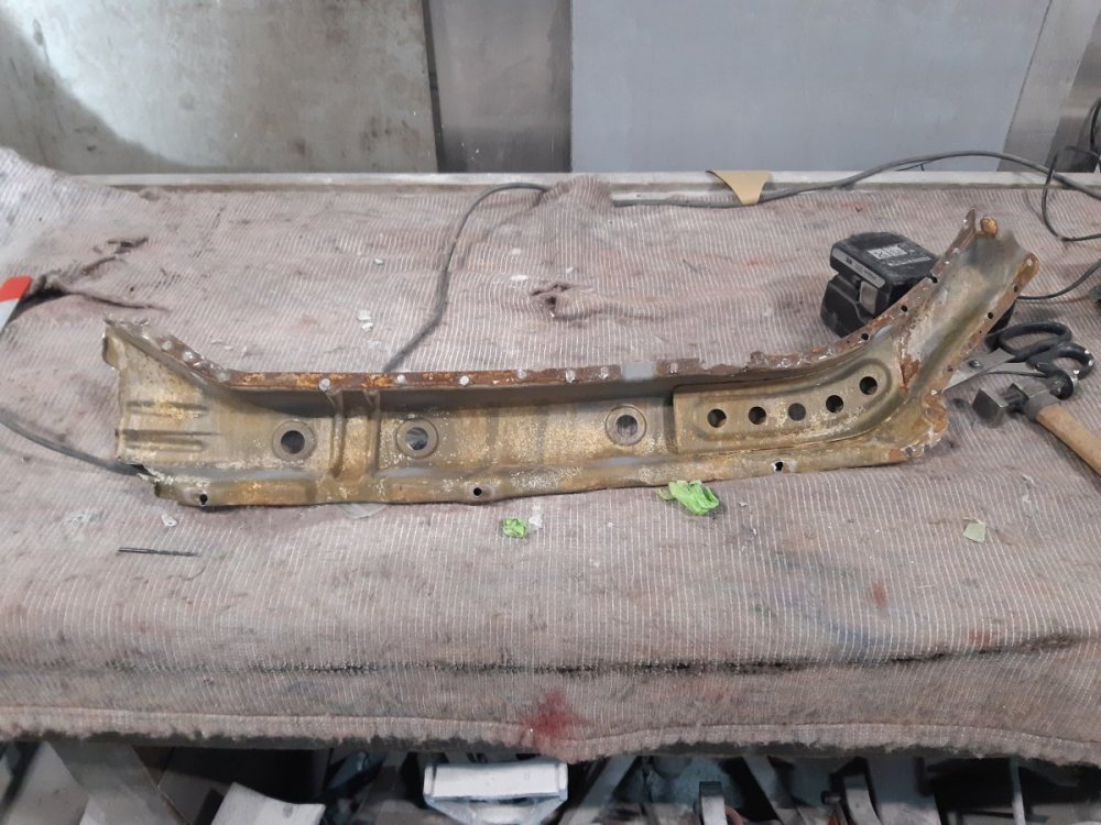

Been to see shell today, better than expected and just a couple of holes have appeared in the floor... Looks like the corrosion was hidden between inner and outer rust prevention 🙂
Now they can see all the rust they will prime to protect the shell and then cut it all out and replace/fabricate as needed.

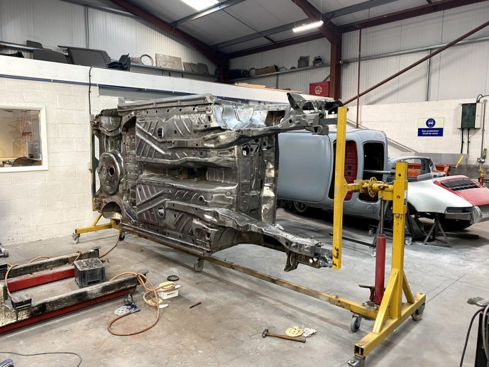

Naked Corrado... I guess there is no turning back now...
I'll get more pictures tomorrow when it arrives to be united with its new panels. To be honest, it is looking really solid!

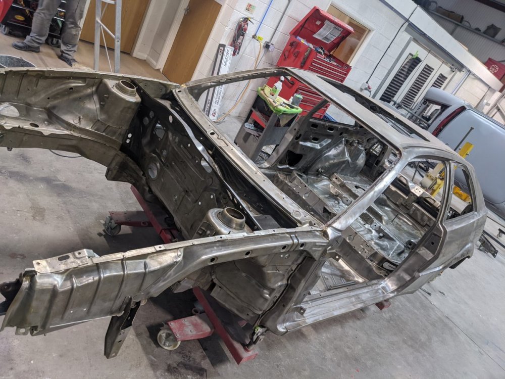

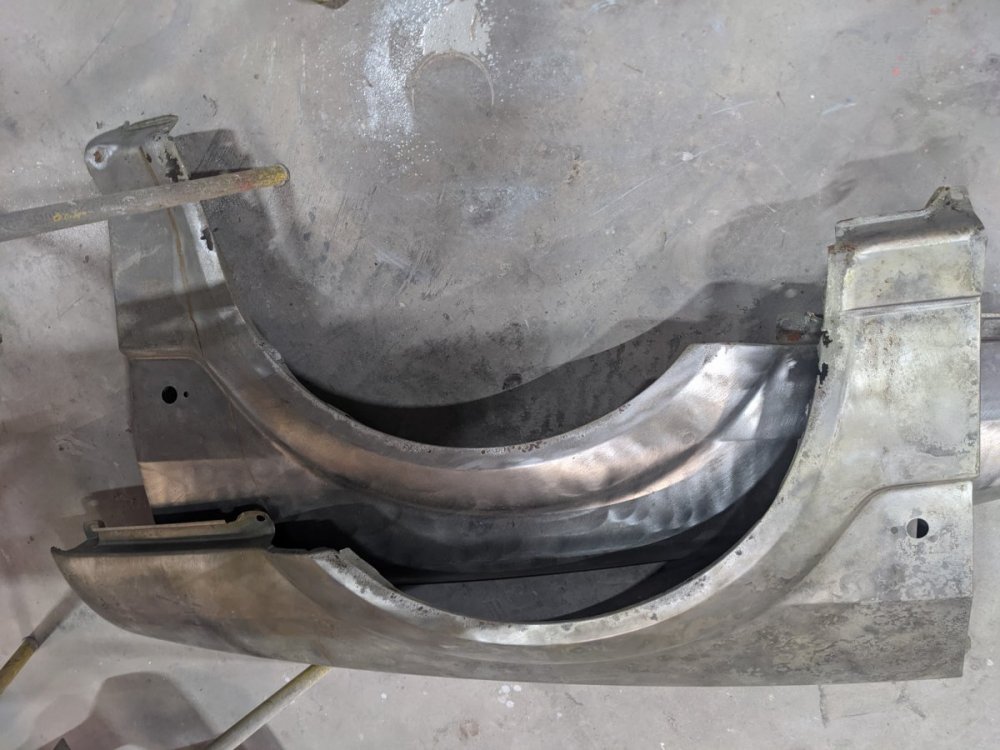

Been a long time but finally a milestone reached and my shell was collected to be baked and dipped! I've gone to ridiculous lengths to ensure that the final finish is as close to factory as possible. From chemical peeling factory body stickers, making templates for sound deadening, tracing the factory writing on the shell and 1000's of detailed pictures and measurements for pretty much everything 🙂. I don't intend to use the factory type underseal as I'll opt for one of the modern better performing products like Gator.

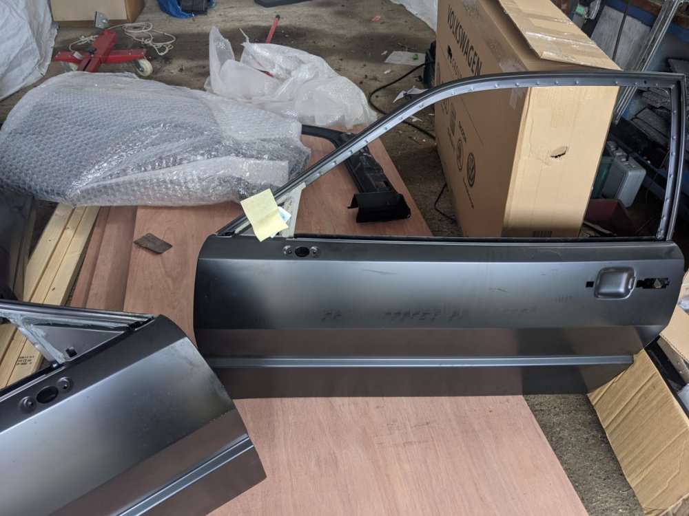

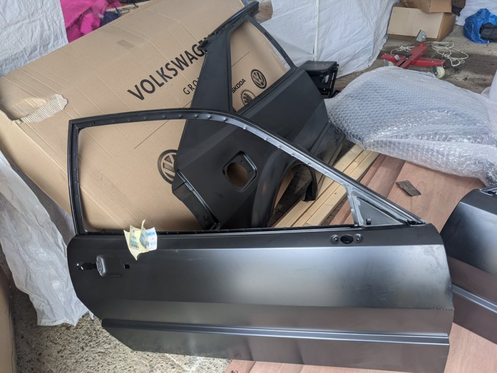

The baking and stripping process takes about a month. Then the welding through to final spray will be somewhere around the 4 month mark. I have new rear quarters, new doors and new repair panels that run A pillar to sill. There doesn't seem to be any horror rust at the moment but replacing the panels seemed to be most cost effective at the time (purchased with a black friday code would you believe - couple of years ago now!)
While the shell is away I'll be powder coating everything that needs it and get the loom tested, cleaned and re-wrapped.
Biggest decision I need to make is the engine, I've obtained a Stealth built engine from another Storm which has a Rotrex charger and ODB2 ECU. I've also got a Schrick Manifold (Currently ODB1). The current engine runs fine but now is the time to rebuild it if using it. Most likely route I'll take is to make the Rotrex'd engine look good and then at a later date rebuild the factory engine. I've no issue modifying the car - but it all will be reversible.
