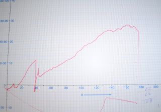

g-dub 0 Posted March 19, 2005 i have the answer--------- instead of giving me about 20 bhp, i have lost 40 bhp so timing, fueling you name it all needs doing went to the rollers today was expecting a small change but not a massive step back first RR my new RR bah!! just a small difference hey, Quote Share this post Link to post Share on other sites
andycowuk 0 Posted March 20, 2005 yes it is on standard injectors, i have a 3.5 fpr but the car needs setting up more to fit this (i believe) the only thing is i'm getting poppin sounds from the exhaust when i change gear at over 5k which leads me to belive that it's over fueling a bit, and the A/F guage seems to report all is fine and yes to the starting thats what i did pulled away slowly as soon as i was moving floored it, not that much wheelspin, unlike some muppet in a g60 who decided to spin in 1st and 2nd then wondered why he got late 17's Something that people dont realise, and its difficult to understand, is that when an engine is running lean, the car is also prone to back firing (Hotter exhuast gases meeting oxygen) that said it may well be over fueling. The afr isnt acurate enough to tell you the difference between spot on, and a bit off. It can only differentiate between ok, and awful. Good luck getting the power back! Quote Share this post Link to post Share on other sites
