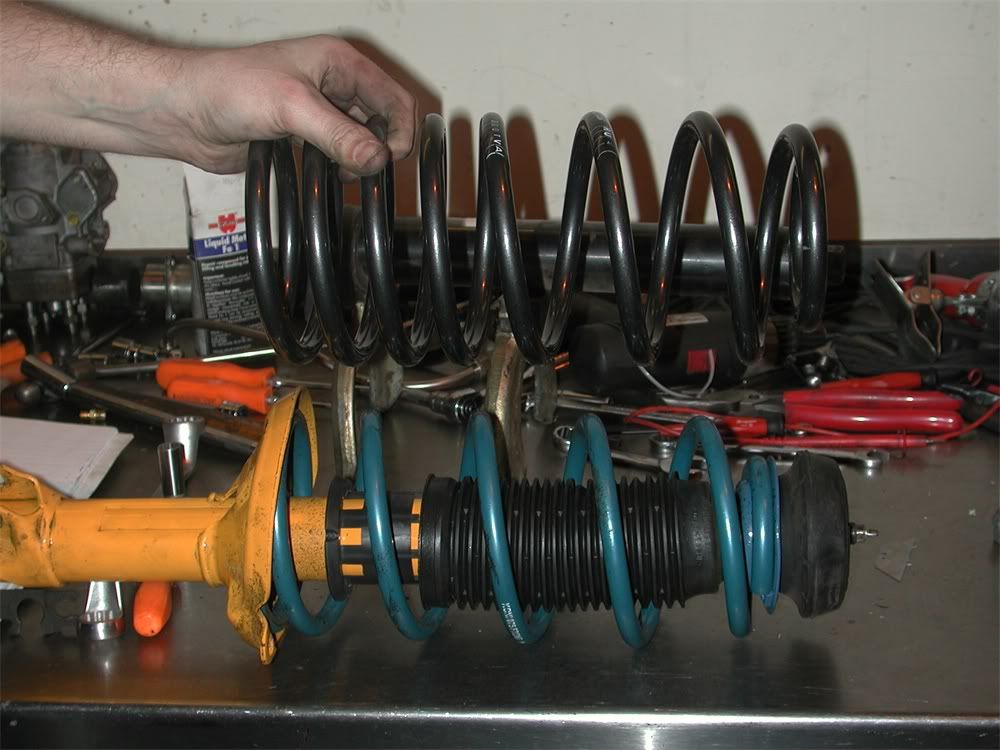

Talc 0 Posted December 19, 2005 I've just taken the koni ssk shocks off of the front of the rado (VR6) and the springs seem too small, you can take the springs out without a spring compressor, as they are rattling a bit in between the two spring plates and the bolt to the bearings on the top is wound down all the way... I checked before removal and they were seated properly when the car was on the floor. Is this normal on aftermarket kits? I've been getting a sound like the springs are moving lots on full right lock... The rear when car is fully off of the floor on a two post lift are also rattling inside the mounts. To hopefully resolve this i'm looking to maybe purchase some H&R or eibach springs to replace, but i'd like to be certain before buying.... :? Quote Share this post Link to post Share on other sites

Talc 0 Posted December 19, 2005 The springs do have koni written on them and look pretty new, i'll check tomorrow to see if they have been cut though, and try and check the part numbers with Koni. Pretty sure theres an MOT failure or similar if the springs arent under tension unladen. I'm swaying towards eibach springs as a friend can get eibach at trade for me, although i've been hearing a lot of praise for H&R, are they really a lot better? I have koni shocks with eibach springs and arbs on my mk2 golf and the handling/ride is good, hopefully the same on rado. Quote Share this post Link to post Share on other sites

Talc 0 Posted December 21, 2005 Right, got some eibach springs through today, despite the Koni (have 'Koni 075' written on them) ones not looking like they've been cut, they are not as thick as the eibach, have less coils and don't seat as widely at either end, looking good with the new springs. I now need to get some correct top spring seats?! they aren't available through GSF, are these a VW dealer only part?? Quote Share this post Link to post Share on other sites

Talc 0 Posted December 21, 2005 It's a Kreg (92) VR6, the top plate is blue and doesn't look to be of much quality i.e def not VAG, I quoted the year when ordering from eibach. (Spot the difference ;) ) The top plate was about 2-3mm too small, but looked to make a major difference. Going to contact a VW dealer and see if I can order these top plates. Quote Share this post Link to post Share on other sites
