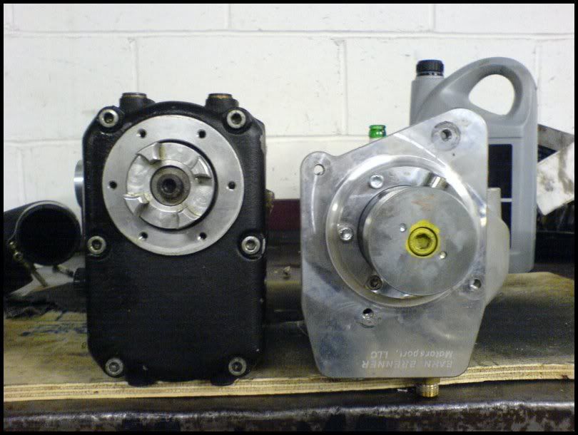

potatonet 0 Posted December 31, 2005 anyone ever tried using one of these before? its gonna be interesting to mount once I get it from philladelphia... Quote Share this post Link to post Share on other sites
potatonet 0 Posted December 31, 2005 did the math and it will put out roughly 19-22 psi @ 6k rpms, ALL THE TIME and you dont have to think about your charger blowing up.... just your rotors and pistons melting... =-) YAY FOR MORE FUEL! oh and being that it has an electromagnetic clutch I can turn it on and off =-), that can be useful when I get pulled over for modifications... =-/ flick a switch and its quiet as a dog. Quote Share this post Link to post Share on other sites

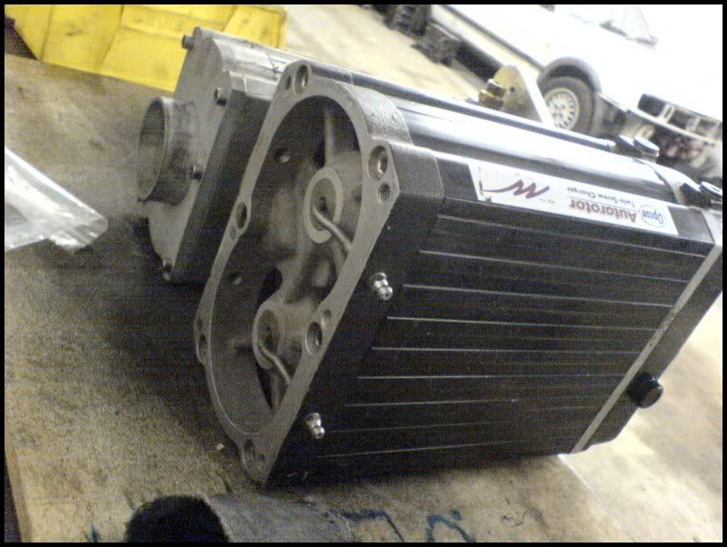

W3RKD 0 Posted December 31, 2005 What make / size is the unit you have there please ? dont the merc's use a eaton M62 the one in the picture does not look like an eaton at all it looks more like a autorotor unit Quote Share this post Link to post Share on other sites
potatonet 0 Posted December 31, 2005 G-man, this unit is made by IHI in japan when i get it I will give you some more specs sizewise. yes it does indeed look autorotor. all STANDARD mercs with kompressors use M62's. AMG's use lysholm and not eaton. everyone keeps asking me this. numbers from the casting are: AMG A1120900080 VG920011 01010322003L. it is said to put out about 2646 lbs of air per hour, converted over to CFM's its about 560, with the size in pulley difference on a G60 its about 470 cfm's or something like that, I did the conversions neglecting the size of the pulley on the charger (new one) and using approx numbers. once I get the unit I will do the final math and we shall see what we get. Did the comparison approx with BBM's autorotor unit. displacement still unkown on this charger. Quote Share this post Link to post Share on other sites
W3RKD 0 Posted December 31, 2005 http://www.sprintex.com.au/Opcon_Autorotor.asp this should help you... i have one of these :wink: Quote Share this post Link to post Share on other sites
potatonet 0 Posted December 31, 2005 uhhh k... ? I like the website, but I think my blower is bigger..:roll: hmmm maybe too big according to that thinger... I dunno which charger it is.... grrrr bbm is helping me with this one actually =-) Quote Share this post Link to post Share on other sites

W3RKD 0 Posted January 1, 2006 This conversion is not finished here yet either. we have been lucky in the fact a BBM mount fix's it perfectly on the pulley and and we will fab an additional mount for the back end also due to the weight. You will need to take this car to a workshop that has mapping gear once its complete have a chat with maybee sSm @ SNS as he might no somone local to you. Quote Share this post Link to post Share on other sites
potatonet 0 Posted January 1, 2006 g-man can I give you specs on the charger and the rest of my car and you make a generic chip for me, with all my mods taken into account? anyone local means over 7 hours of driving because LA is where all the real tuners are. I dont know if you have made the rear mount yet but its easier to make it and bolt it onto the intake housing. basically make a spacer for the intake with the mount built into it. I am making a plate for the holes on the stock bracket and making a plate to mount the charger on. Can you make me a CAD drawing of the bbm mount that you have? I just need exact spacing for the holes. Quote Share this post Link to post Share on other sites
