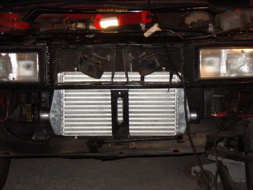

potatonet 0 Posted March 26, 2006 yeah its all good, we dont understand either hahaha, so anyone think that a 25"x10"x2.5" intercooler is too small? I think it will work for the application..... or at least Im hoping. Quote Share this post Link to post Share on other sites
W3RKD 0 Posted March 26, 2006 yeah its all good, we dont understand either hahaha, so anyone think that a 25"x10"x2.5" intercooler is too small? I think it will work for the application..... or at least Im hoping. with the correct end caps this should work well although 63mm is quite a squeeze infront of the rad on one end. Only really relavent is you are trying to retain the OEM look though i guess. Have you also spoken to John about T-bodies as i think you will need to ditch the g60 item also if your unit flows anythng like the one we have here. Quote Share this post Link to post Share on other sites
potatonet 0 Posted March 26, 2006 how do you mean about the throttle body, I thought it was 60 mm or something close to that, O.D. of course, I could port it which wouldnt be that bad... but yes i could get something better for flow there. all Im really worried about on the TB is if the outlet, normally for the boost return can handle the 25 psi, I did some math and it should come out of there at about 60-70mph, which is really fast.... yes I know flow is better and all but currently I am just working on getting the thing finished, and yes I did notice that the 63mm is really hard to get on on the side with the charger, Im removing the AC so I can go under there, I dont use the AC as it is so why keep it there... and if anyone has opinions, black piping or chrome piping? I am not picky and I just dont know which one to choose. speaking of which darren, love the new site. Quote Share this post Link to post Share on other sites

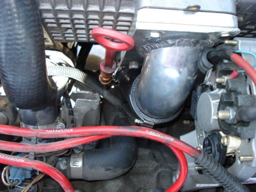

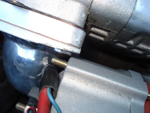

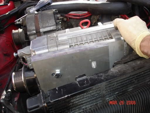

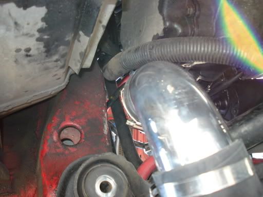

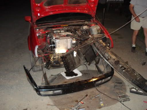

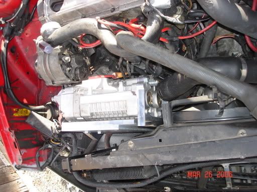

potatonet 0 Posted March 27, 2006 we got more pics, its gonna look soo nice, and darren change of plans, I have to route intake to the left side of the car, you can see why if you look at these pics. http://i6.photobucket.com/albums/y207/p ... C03187.jpg - where I have to fit 2.5" piping http://i6.photobucket.com/albums/y207/p ... C03186.jpg - again http://i6.photobucket.com/albums/y207/p ... C03185.jpg http://i6.photobucket.com/albums/y207/p ... C03184.jpg http://i6.photobucket.com/albums/y207/p ... C03183.jpg - best pic I think http://i6.photobucket.com/albums/y207/p ... C03182.jpg http://i6.photobucket.com/albums/y207/p ... C03181.jpg http://i6.photobucket.com/albums/y207/p ... C03180.jpg http://i6.photobucket.com/albums/y207/p ... C03179.jpg http://i6.photobucket.com/albums/y207/p ... C03178.jpg oh yeah forgot to mention, I can activate the EM clutch with a 9V battery, just thought it was kinda cool. =-) Quote Share this post Link to post Share on other sites

potatonet 0 Posted March 27, 2006 just bought intercooler and piping today. 320 dollars for total. should recieve it next monday... give me some time to get the thing welded in. Quote Share this post Link to post Share on other sites

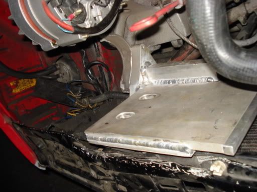

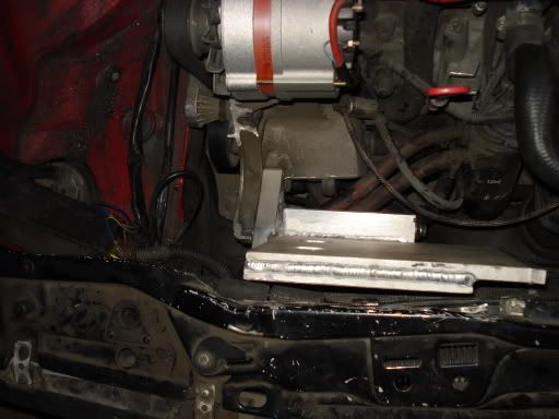

W3RKD 0 Posted March 27, 2006 good work mate - but are you sure that the charger will be held totally square ? i would hate to see the roters lock due to movement matey Quote Share this post Link to post Share on other sites
potatonet 0 Posted March 27, 2006 yes the pieces i got cut are square to 1/10000th of an inch. the welds will be perfectly square and I have a few support pieces to weld onto the inside of the bracket, I am also looking at making something to hold onto that little top piece with a bold on it, it will bolt to something further back and down I think, preventing forward motion, the thing is rock solid in place and I engineered it to withstand 100m/s^2 forward acceleration and still stay in one place. Im only slightly worried about the left side. because the only support there is the small rod bracket on bottom which is bolted in place then welded to the charger plate. I do need something to prevent lateral motion, its got side supports and weight supports, its just holding them from digging into the radiator thats the problem. Quote Share this post Link to post Share on other sites

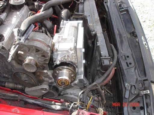

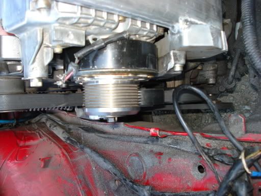

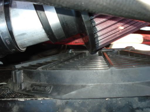

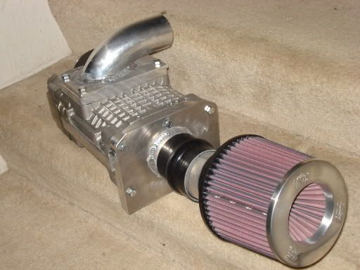

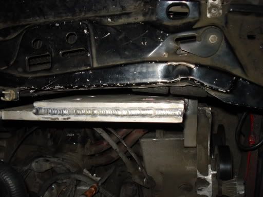

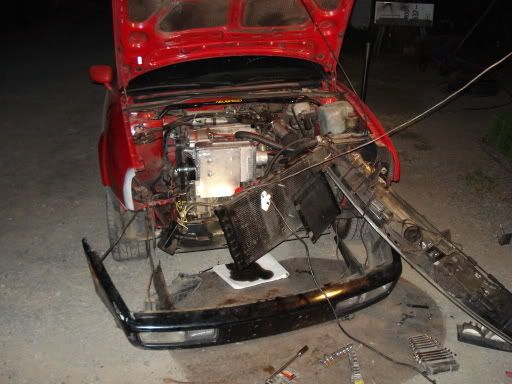

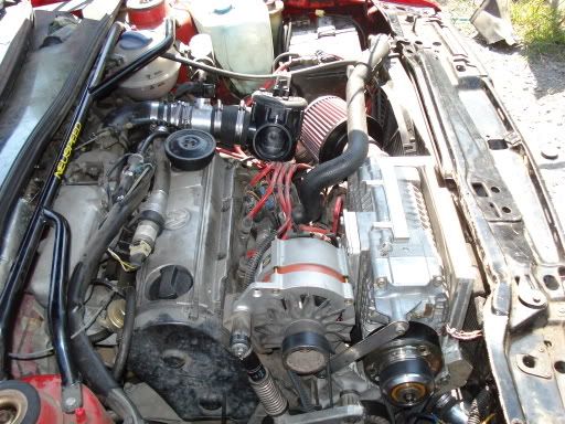

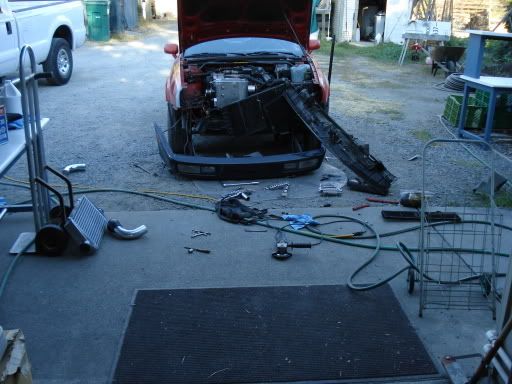

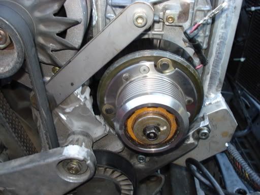

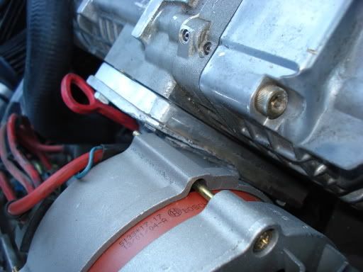

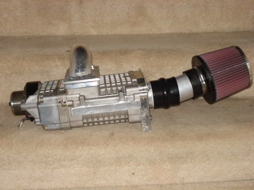

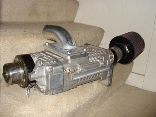

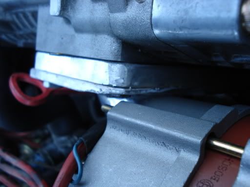

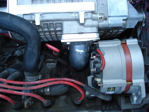

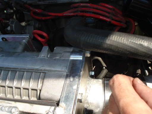

potatonet 0 Posted September 3, 2006 ok so I decided to cut everything else up and make pretty pictures for you people. bracket and charger, been like that for a while just never took a picture. Quote Share this post Link to post Share on other sites
CorradoVR6-Turbo 0 Posted September 3, 2006 Looking good,are you adding a support bracket on the rear? Quote Share this post Link to post Share on other sites
potatonet 0 Posted September 3, 2006 small SS plate attaches to supercharger on pulley side and mounts to the bolt for the tensioner and alternator (plate goes over pulley on alternator (barely)). there is also a piece missing from that bracket that holds the backside of the charger on. Quote Share this post Link to post Share on other sites

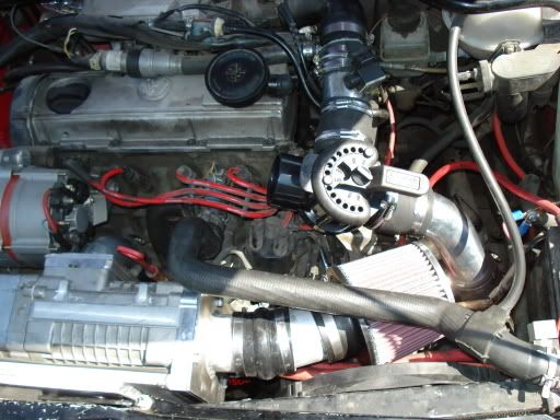

potatonet 0 Posted September 8, 2006 gonna do the fuel once I move, got all the parts just need to get it done. car is set up for 16 psi right now, gonna run that for a little while. oh and that big 3 way valve is so I can shut off all boost and have it blow on the engine if I want to run on the freeway (long distances). Quote Share this post Link to post Share on other sites
potatonet 0 Posted September 8, 2006 rarak69, they are a pain in the rear to find, I have a store that sold me mine holding the next one he gets for me =-). I think that guy is the only one on there that sells them, dunno saw one from an SL55 AMG a while back would have sold for 500 dollars but I was lazy and I didnt want it, it was like 2.2L per revolution, it was massive. if I can figure a way to mount it I would use it but I think the fan would get in the way. Quote Share this post Link to post Share on other sites

potatonet 0 Posted September 8, 2006 tight is an understatement, this is why it took 9 months to get right! all I can say is engineering classes paid off during this whole thing, oh and you are looking at about 260 @ wheels with a stock flywheel so about 320 at the crank, on a stocker. yes I will need headgaskets monthly if I crank the boost up. Quote Share this post Link to post Share on other sites
rmn 0 Posted September 10, 2006 nice work i like the way you seem to still ahve the clutch on the pulley to let it freewheel when you want no boost! Quote Share this post Link to post Share on other sites
