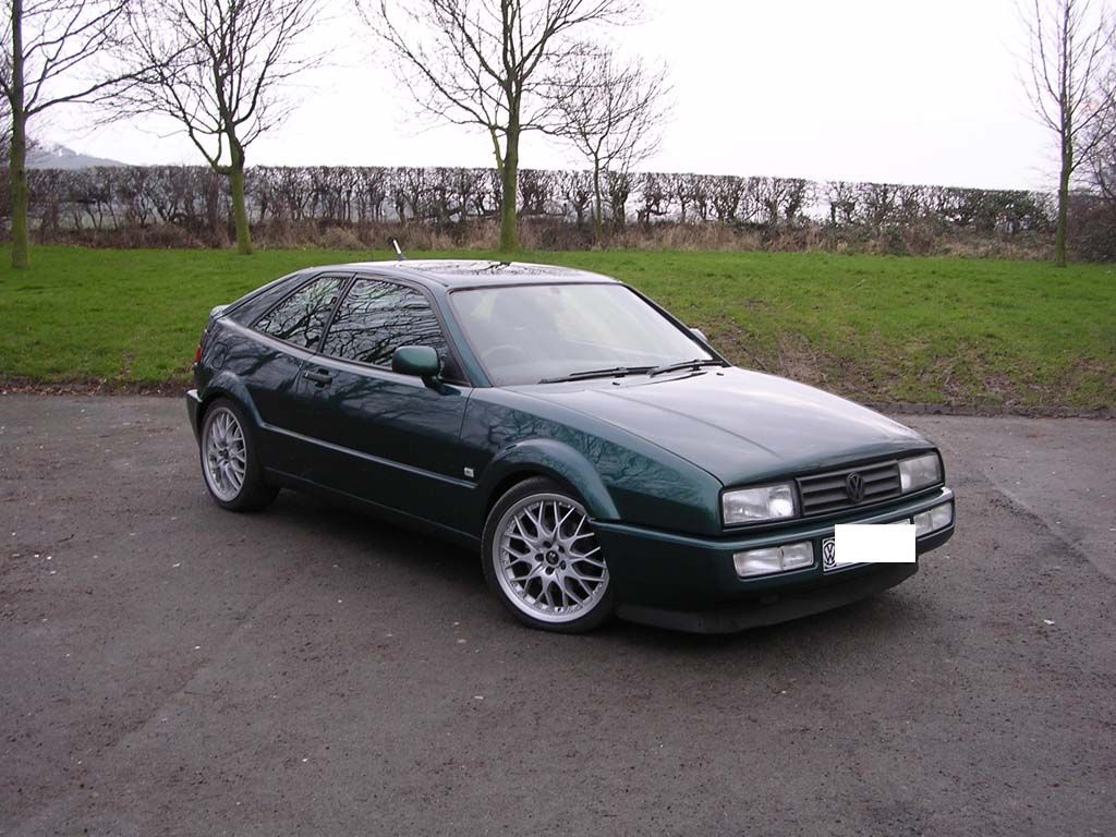

Socrates75 0 Posted January 24, 2006 The mobile in question :) Love it and hate it :D Quote Share this post Link to post Share on other sites
