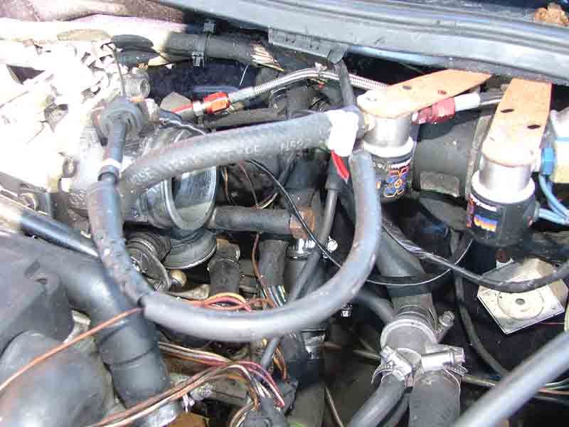

2_Door_fun 0 Posted March 4, 2006 Hi.. Do all G60's have a C canister?? Mine has none. Also on the tech diagram it shows small lines of the rear of the plenum. My plenum seems to have blanks? But there is a line blocked with a large bolt. See image Quote Share this post Link to post Share on other sites

Supercharged Junkie 0 Posted March 4, 2006 2_Door_fun, by the looks of it your cc has been removed already Quote Share this post Link to post Share on other sites
2_Door_fun 0 Posted March 4, 2006 No real benefit in removing the cc except cleaning up the top of the engine by removing all the vacuum lines that aren`t needed anymore plus it leaves a nice large hole directly under the airbox for a cold air feed :-) Ah my plate is still in place. No airbox but a K&N cone ect. The round snap off plate is still there... So whats the pipe with a bolt in it. That is a naff way of sealing a pipe.. Threads leak. Quote Share this post Link to post Share on other sites
steveo29 0 Posted March 4, 2006 the pipe with a bolt is what supercharged junkie suggests is causing my noise...i fitted a proper blanking cap and im having a prob with it not sounding right as mentioned in my first post i agree the bolt stuffed in a pipe looks rank....not really sure of a nice way to do it...was hoping for lots of answers as many people do this mod Quote Share this post Link to post Share on other sites
2_Door_fun 0 Posted March 4, 2006 well..This is my first Corrado so I'm discovering as I'm going. Maybe you could go to a plumbers supply shop and get some teflon sealer. That stuff will seal anything. How does a blanking cap work? Quote Share this post Link to post Share on other sites
