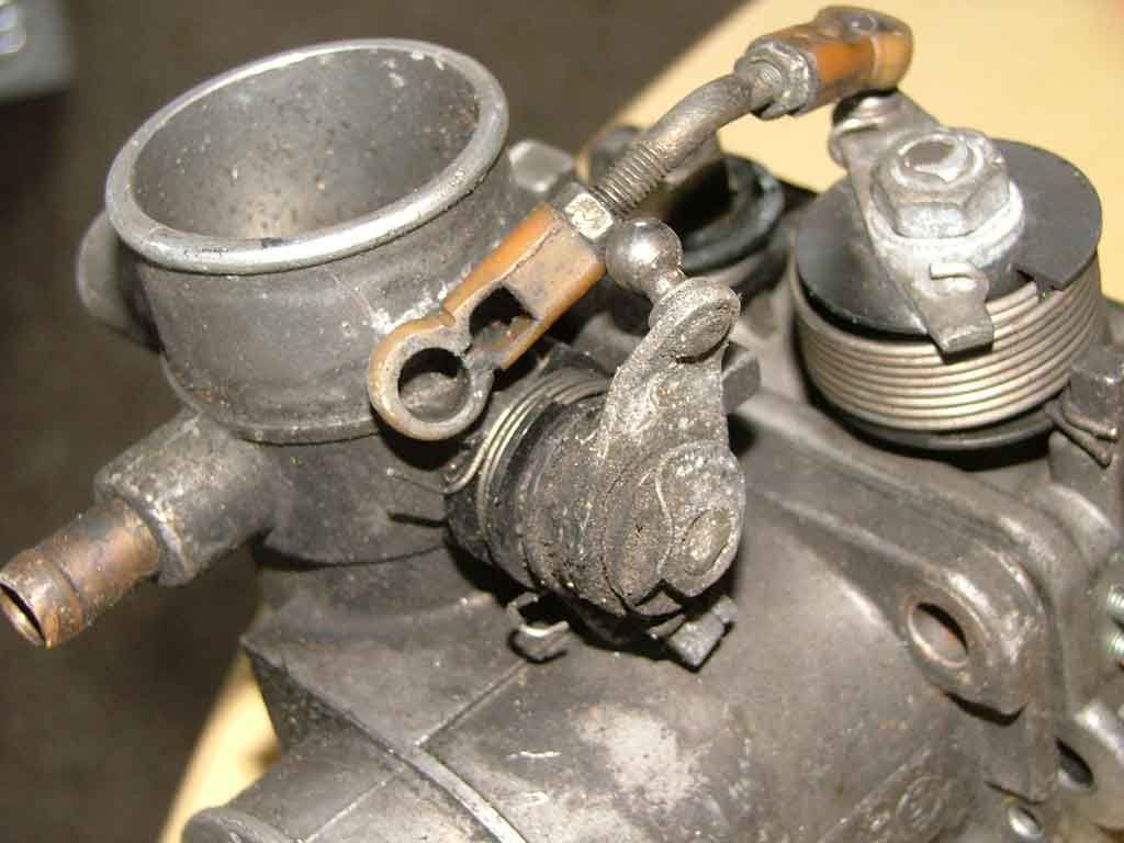

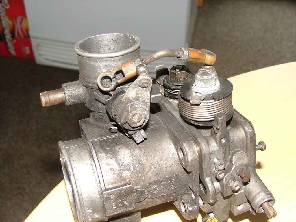

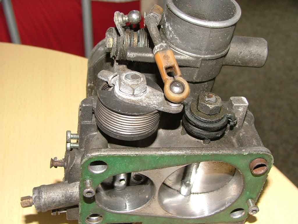

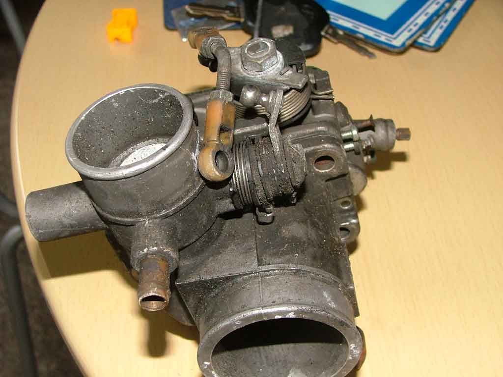

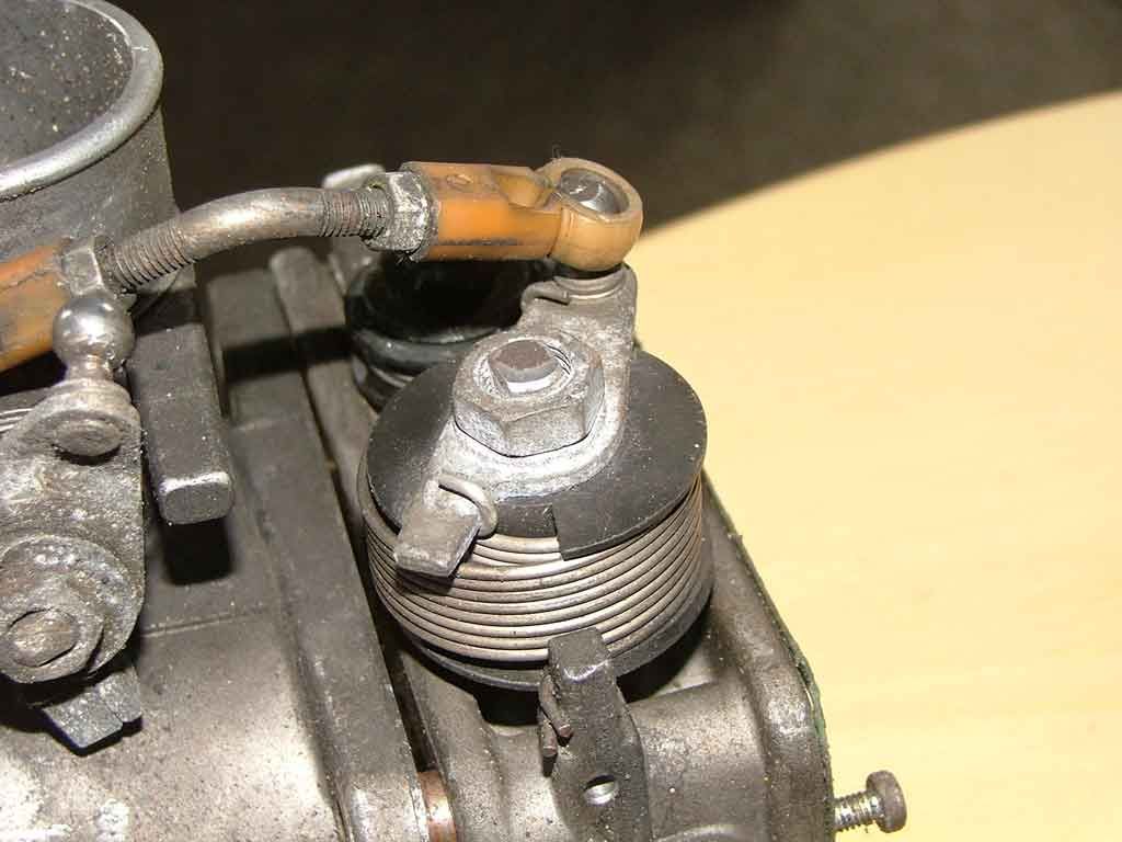

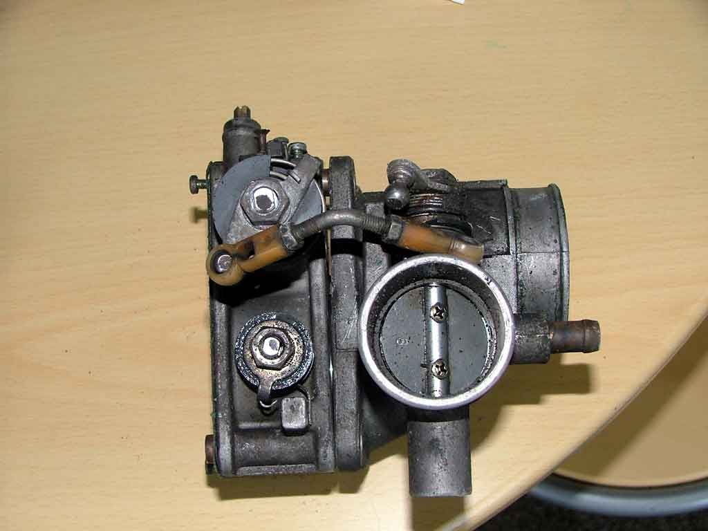

Blue_Joe 0 Posted May 28, 2006 I've had to strip down my throttle body to replcae some bits on it and do some porting. However in my wisdom I forgot how to put part of it back together and I cannot for the life of me work it out!!!! I need to figure out how the boost return butterfly linkage goes back together, the part on the underside outer part of the throttle body. So if anyone has one off the car at the mo, of has pics of how it all goes back together I would be very grateful. If taking fresh pics could you do it at a few angles to help me get best idea of how it goes. I need to get this back together tonight hopefully!!!! Thanks guys (and girls!) Quote Share this post Link to post Share on other sites

2_Door_fun 0 Posted May 29, 2006 I have a damaged one in the shed will post shots later today. Have kids at mo busy busy. Quote Share this post Link to post Share on other sites
2_Door_fun 0 Posted May 29, 2006 Back now. Kids busy colouring n stuff. Me been digging round in the shed. Hope these help. Quote Share this post Link to post Share on other sites
Blue_Joe 0 Posted May 29, 2006 Thanks All back together crisis averted! Quote Share this post Link to post Share on other sites
