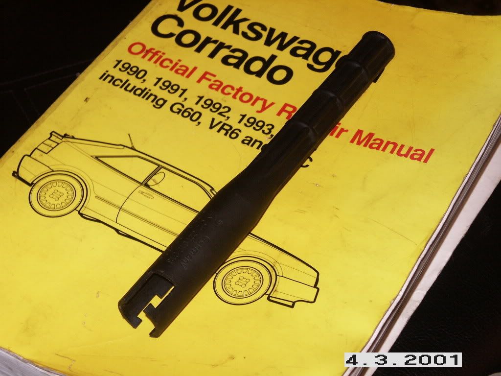

CorradoDriver 0 Posted July 24, 2006 Hey, Some one on the vw vortex forum told me that the car might come with the plug removal tool and then i remebered that i saw somthing that could have been it and it was, have a look at the picture my life is at ease now lol i removed two of the spark plugs and sure enough it was black and burnt, im gona buy some new ones tomorrow, currently in the car ihave 2 pronged plugs should i stick with the 2 or should i get 3 pronged or 4 any suggestions, dont mind the date havent changed it on my camera. Thanks again guys Quote Share this post Link to post Share on other sites
Guest Posted July 24, 2006 Rado's come with the one pictured above as standard, but they are often lost over the years, have a hunt around and see if you can find it. They are the 'feeble plastic ones' as Rodders puts it ;) Metal ones are better, General automotive shops won't sell the tool, try VW, its called a sparkplug removal hezet tool, can't remember the part number, but they are for sale on here (from the UK). Quote Share this post Link to post Share on other sites

CorradoDriver 0 Posted July 24, 2006 thanks, i found it in my trunk lol, i rotated the tires like 2 weeks ago and i saw it but wasnt sure waht it was for so i threw back in, lol turned out for the best and it isnt that bad of a tool, gets the job done, idk 1 more thing i asked this before but no one responded what type of plugs should i get, my car had the 2 pronged plugs but i wasnt sure if i should get 2, 3, or 4 pronged plugs for my vr6, any suggestions Quote Share this post Link to post Share on other sites
Guest Posted July 24, 2006 metal ones part number is T10029 do a search for 'hazet'and find relavent threads here here here etc etc Quote Share this post Link to post Share on other sites
Guest Posted July 24, 2006 thanks, i found it in my trunk lol haha, told ya ;) mine was fixed to the jack arm :) Quote Share this post Link to post Share on other sites
CorradoDriver 0 Posted July 24, 2006 Thanks, i still need to know what type plugs to get and by changing the plugs does the car perform much better or just better. Idk its my first car so no past experience lol by the way mine was sitting in the trunk and i thought it was apart of the jack arm so i put it on lol but after looking at the arm with that extra plastic somthing didnt seem right so thats when itook it off, good times, my ignition switch and fan switch should be coming 2day so i get to install that, cant wait to take the whole driver side steering wheel assembly off lol, my first semi big project, wish me luck lol Quote Share this post Link to post Share on other sites
