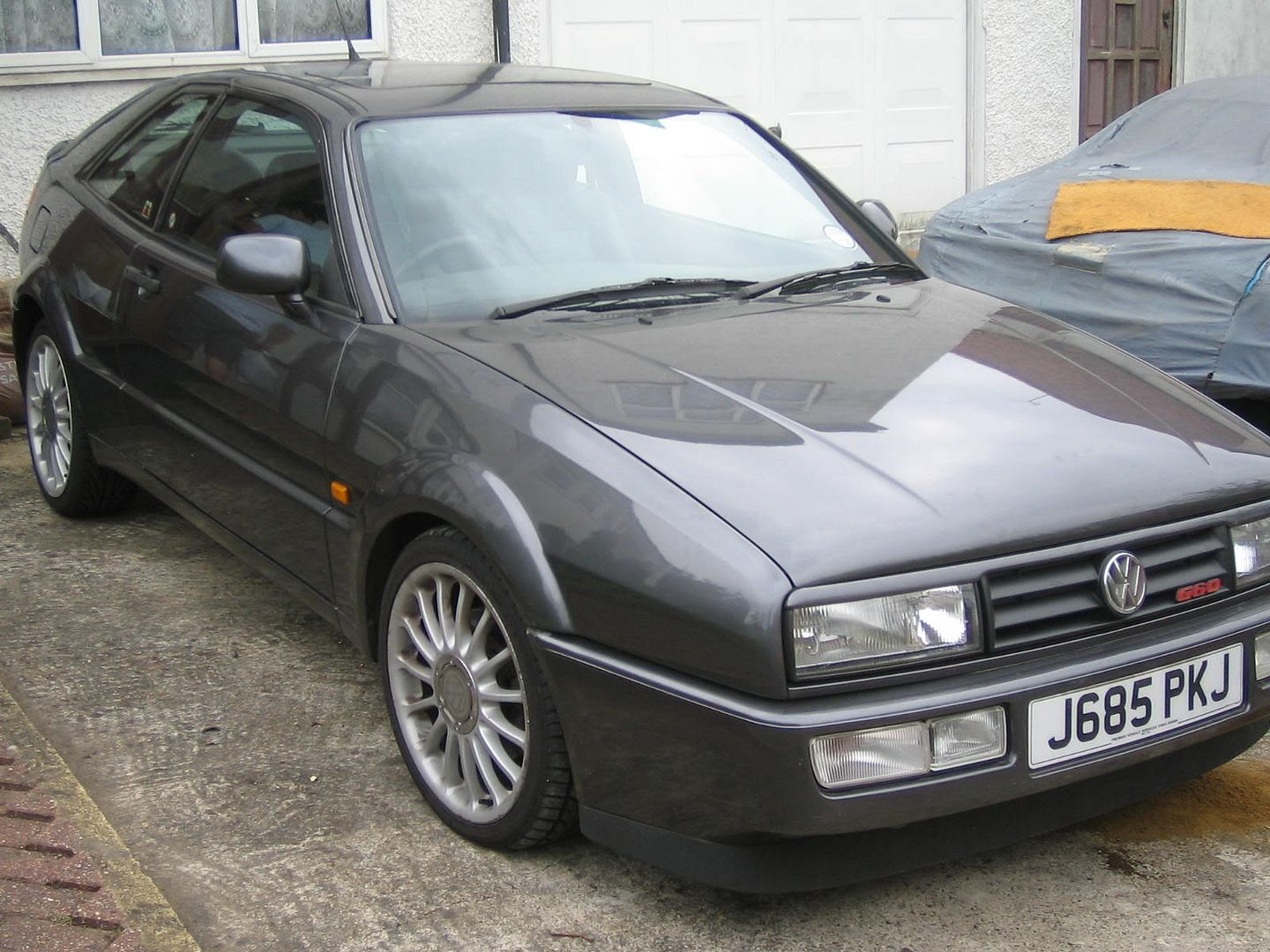

Lovinit 0 Posted July 26, 2006 heya there, gotta lovely G60 recently,its me first time! car is all in great mechanical nick and the superchargers been recently serviced, but i wanna get more power..any ideas where my money should go first! I'm thinking induction kit perhaps? or messin about with the supercharger?what can i do with the supercharger? i've heard a lot about portin and polishin and chips n pulleys, but i'm gettin confused... can anyone give us some direction... Cheers guys James Pics of my new toy...my first.. http://i71.photobucket.com/albums/i136/ ... G_4543.jpg http://i71.photobucket.com/albums/i136/ ... G_4542.jpg Share this post Link to post Share on other sites
Critical_Mass 10 Posted July 26, 2006 68mm pulley with SNS chip first. Share this post Link to post Share on other sites
Ibsyj 0 Posted July 26, 2006 What power will that get it upto? Just im planning to do the same once i can actually drive and can afford all things to do with modding a G60. Will that get it upto around VR bhp? Share this post Link to post Share on other sites
Jim 2 Posted July 26, 2006 Yep - thats a must. Chip and pulley really is the quickest, easiest and cheapest way to add power to a G60. You just need to make sure your charger is in good health as the smaller pulley puts more strain on the charger and will shorten the time between maintainence intervals. Where abouts in the country are you based? Power wise - you should (if everything is healthy) add on something like 15-20BHP. Not quite VR territory but not far off... Share this post Link to post Share on other sites
g60rc 0 Posted July 26, 2006 Yeah, chip and pulley... i'm going to do this soon, should get 190bhp? What sort of power will porting the charger aswell give? Share this post Link to post Share on other sites
