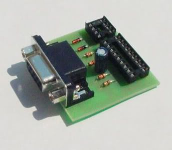

PIC 16F84 + 24CXX Simple E-Eprom programmer
Could I use one of these to backup the chip from my ECU?
List of the schemes, which the programmer can programme:
EEPROM:
24C01, 24C02, 24C04, 24C08, 24C16
24C32, 24C64/65, 24C128, 24C256, 24C512
24LC01, 24LC02, 24LC04, 24LC08, 24LC16
24LC32, 24LC64/65, 24LC128, 24LC256, 24LC512
PIC microcontrollers:
PIC 16C84, 16F84, 16F84A
On G60´s ECU you can only find EPROM 27C256 (UV Erasable), which are not compatible with that programmer.
I don´t know about VR6´s ECU...
