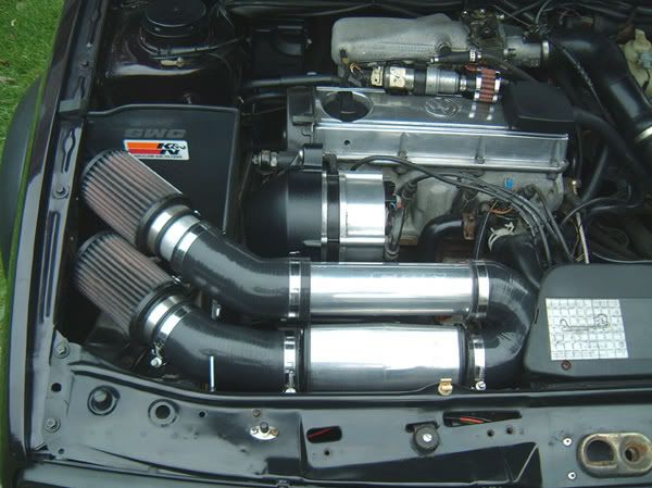

flusted 0 Posted March 7, 2007 Im am no way saying this is better than a swg jobby its just i like to make my own stuff with whatever is in my shed :lol: I already had a jabbasport induction kit and heat shield and a spare alloy inlet adaptor so thought id make a twin inlet. First i added a cold feed through the cc hole using a bit of landrover airbox pipe 8) Then trim the heatshield Then using some more flexi ducting (think it was for the airvents in the dash of some car :oops: ) i routed the second inlet onto a renault 5 turbo jr cone filter which is the same brand as the jabba 1. All the tubing is 3" to the filter and the 3" stainless pipe is the tailpipe i cut off my mates spare cossie 4x4 exhaust (he doesnt know yet :oops: ) heres the finished artical The second filter cost me £20 from ebay, £6 for jubilees, piping was free and the inlet adaptor was £10 so a totalof £36 8) What do you think? Quote Share this post Link to post Share on other sites

jonnyboyo 0 Posted March 7, 2007 Looks awesome! Have you noticed any performance or noise gains? Quote Share this post Link to post Share on other sites

Andyrado g60 0 Posted March 7, 2007 Very nice work mate! Iv just brought a length of 3" pipe, a k and n panel filter, some engine bay de-greaser, a stiff paintbrush, and some zip ties today to do the carbon canister removal mod on my g60, drill the bottom of the air box, treat it to the k and n and a good engine bay clean and get a cold air feed to the bottom of the box, question is, is there anything i need to know when removing the carbon canister, do i just leave the hoses open or blank them off that led to the canister? and whats the best way to fix the other end of the pipe to the back of the lower grille under the bumper? Is this the best place to put it? Thanks in advance, Quote Share this post Link to post Share on other sites

flusted 0 Posted March 8, 2007 Ahh, i snapped my arm a few years ago playing ice hockey and it was a cast that included the thumb bit, it drove me mad not driving my car (which was a g40 back then) so i cut the thumb part of the cast off with a junior hacksaw blade, all good untill i went back to have the cast off and got "told off" by the nurse who took it off proporly. But id probably advise using a normal size hacksaw blade for your leg cast. Would you advise me to locate the other end of the hose behind that little grille in the lowar bumper? I done my leg playing roller hockey! the first cast they fitted rubbed, so i went back and had another fitted which also rubbed so i took a hacksaw and took 2" off the bottom, fits a treat now :lol: Now i just need to work out how to mod it :lol: Get the hose as low down as poss and in direct airflow, air is coldest approx 6" from floor Quote Share this post Link to post Share on other sites
Craig 0 Posted March 8, 2007 i like your imagination, got me thinking now, just wandering where you got the inlet adapter from tho for the second piping? any tips will be appreciated :) Quote Share this post Link to post Share on other sites

flusted 0 Posted March 8, 2007 first real injury for me in 14years of playin! The second inlet adaptor i got off a member on here Quote Share this post Link to post Share on other sites

flusted 0 Posted March 9, 2007 As i said before, it will never be as good as the real thing, my heatsheild is badly cut not laser cut etc and i the cost of buying all the bits new must be very high Quote Share this post Link to post Share on other sites
ninoG60 0 Posted March 10, 2007 yeah good work mate I am gonna do this too , looks like a good mod 2 questions does it make any difference in ya throttle response or power delivery( noise too) and second question what rocker cover is that cos if im not mistaken, thats the 1st one ive seen wit the breather on the opposite side to the one on mine, i thought mk3 golf gtis had them on that side? But back on topic WELL DONE!!! :D Quote Share this post Link to post Share on other sites
Andyrado g60 0 Posted March 10, 2007 Thanks for that flusted! Iv now removed cc, got a piece of 3" ending in the same place but as im on standard bumper theres no where to put the pipe that isnt behing the grille - diddnt wonna put it there as the pipe would run about an inch away from charger pulley which is a bit to close for me. So i have a 90 degree bend on the end of the pipe and strapped it next to the air duct for the brakes (diddnt want to cut into that duct as want the brake to get as much air as poss) but made it sit a little lower, it prob is about 6 inches from the floor. Im running air box with k and n panel filter and drilled it directly above where the pipe ends. Does what iv done sound ok? And with the ice hockey accident, i only had that major one in 4 years, a 17 stone player landed ontop of me after a dodgy tackle and my arm ended up under my back the wrong way with 17 stone of player on top of me, i stood up, looked at my arm and my thumb was touching my elbo on the same arm, wasnt very nice, But any way nice work with the cast modding flusted, get some go faster stripes! Quote Share this post Link to post Share on other sites

flusted 0 Posted March 11, 2007 Its a mk3 gti 1! andy im sure that will be fine!| Quote Share this post Link to post Share on other sites
