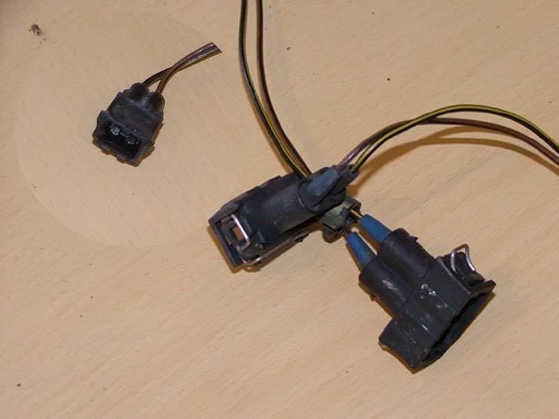

Where does this loom go :oops: It must be from the front end as I have just finished rebuilding it...
I just can't remember where this goes. It has been a month or two since I dismantled the car. I can't find any loose plugs????

Not the horn is it?
No thats working..However Noel maybe your dead on. Maybe I removed the loom from my panel n had no need to refit to the new??? However the horn connectord are single round unless they spill off into this loom??
Upon looking the it seems not to be for the horn

it looks like the bit on the inside of the wing, near the battery.
When i fitted an uprated loom, im sure i had to disconnect that part. like a yellow thing (resistor of some sort)?
Yellow loom is conected. So don't know. Knowing my luck its prob of my mothers Clio :lol: Just sitting in a pile of VW stuff
thats defo the horn loom, most people leave em connected to the slam panel when they change em

2 big plugs go on the 2 seperate horns, then they join into 1 plug that plugs in loom

Hay it was the horn. Cheers to Supercharged and Flusted. Its the loom from my old smashed panel..I didn't think it was the horn loom cos the horns on my new panel have different connections. I just dug out my horns n yes the loom does fit.
Current horns have single spade connections covered with round rubber boots.
