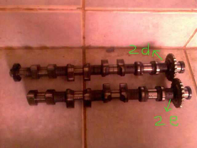

Kaktus 0 Posted April 29, 2007 Hi guys. Can someone confirm which 16v cams these are. Happy Dubbin Hugo Quote Share this post Link to post Share on other sites

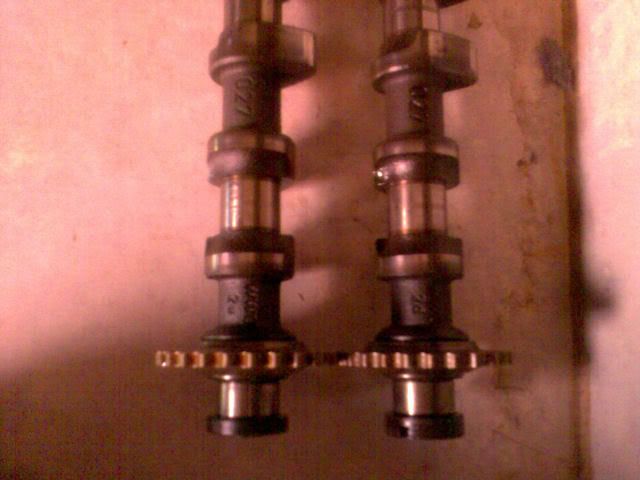

dubcharger 0 Posted April 29, 2007 They are 027 cams from the 1.8 kr Quote Share this post Link to post Share on other sites
dr_mat 0 Posted April 29, 2007 Which is odd, because it looks like there's 12 cams there .. ?! Quote Share this post Link to post Share on other sites
Jim 2 Posted April 29, 2007 Er... I count two rows of 8.. so 16..? Quote Share this post Link to post Share on other sites
flusted 0 Posted April 29, 2007 defo kr, they have the cut outs on the bottom of lobes Quote Share this post Link to post Share on other sites
dr_mat 0 Posted April 29, 2007 Er... I count two rows of 8.. so 16..? I guess the two on the chain end must be facing directly down in the pic, I'd assumed they were bearings not cams ... :) Quote Share this post Link to post Share on other sites

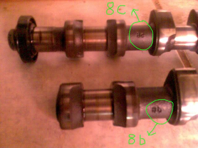

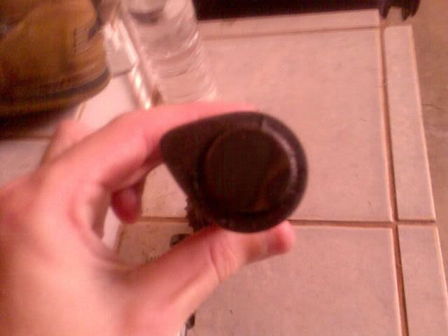

Kaktus 0 Posted April 29, 2007 Hi guys. Yes it comes out of my 1.8 KR. I wasn't sure wether they were indeed kr cams since the head casting is 051 103 373, and the cams are 027. The intake cam looks like it was an exhaust cam which was cut down. See the second pic. I know the quality isn't good but it has def. been machined on the cam gears end. Can't see any machine work that has been done to the dizzy end though... So it's only the KR cams that has the cut outs under the lobes? What are the cut outs for? Happy Dubbin Hugo Quote Share this post Link to post Share on other sites
flusted 0 Posted April 29, 2007 doubt its a zorst cam as inlet as the numbers would be the same Quote Share this post Link to post Share on other sites
